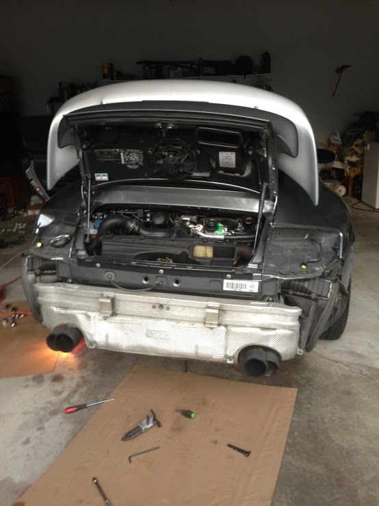

Hi all , now I'm sure it's a tranny , I pulled the drive shaft out , drove the car , the noise still there on the 3rd gear only , the rest gears are fine , so I think the best way would be to rebuild transmission and cheaper , because thats the only 3rd gear set to replace , if I'm wrong please correct , the big question where to do the rebuild , other options are welcome . I will appreciate any help
ps is it possible to get the transmission out without pulling the engine out ?
Thanks !
