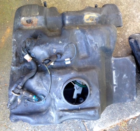

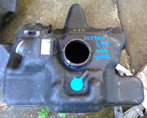

Update: I installed the GT2 tank but it does not fit! The opening for the fuel pump is about 12" behind the opening in the body of the 996tt body. Take a look at the pics below. I thought the front bulkhead was the same between the GT2 and the 996tt?

Hey Don - I think you will find it fits. On the Gt2 you get to the fuel opening under the battery. The cover there can be removed and you see the opening directly below. My guess is that you will have to move the fuel lines and wires, but your moving them back so you should not have to much of a problem. Taboopc (commented on this thread) and I just did a fuel pump change on his gt2 and I was shocked at the difference. Also, your going to have to change the pickup and sender as the gt2 was different as well.

no - the filler door is in the same place. Also the pipe from the filler connects to the same location on both tanks. Its just where the fuel pump goes in. On the turbo its under the black plastic cover in the front truck compartment. on the gt2, its under the battery.

Ahh ok I will put it in one more time and see how it lines up. From what I remember the opening was right between the 996tt body openings (battery and fuel pump access hole). Ill give it another shot! Thanks!

Success! I went back for round II and I moved it back a bit and it lines up great with the opening under the battery! I was just about to order a turbo tank!
Now I just need to find all the fuel lines, basket, sender from a GT2.

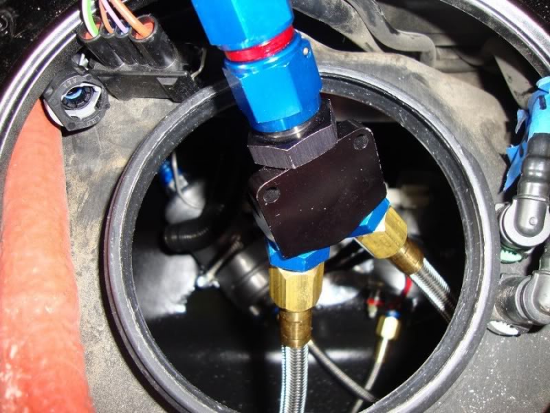

If you have the turbo lines, you should be able to shorten them, but considering your engine is built I'd just run #6 or 8 lines. It was pretty simple to route on the gt2. We also did an walbro e85 pump which is working perfect. Let me know if you want tips on that.
I already did the dual 044 pump setup before. I made a custom bracket to hold the 2 pumps where the factory basket goes. I think I will go to a single 450lph pump in factory basket though now. I didnt really like the noise of the 044's and the heat build up was horrible since the factory cooler is bypassed when going with 8AN line. I think the 450lph should be plenty for the A28s I have switched to (use to have A3076s).
