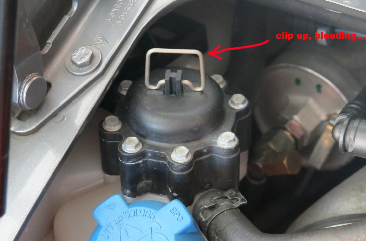

Look at post #7 from And996tt of this thread, you will get a perfect explanation of the bleeding process:https://www.6speedonline.com/forums/...ed-refill.html
The clip he's talking about is on the expansion tank. You just raised it and drive like that and fill coolant when needed....
