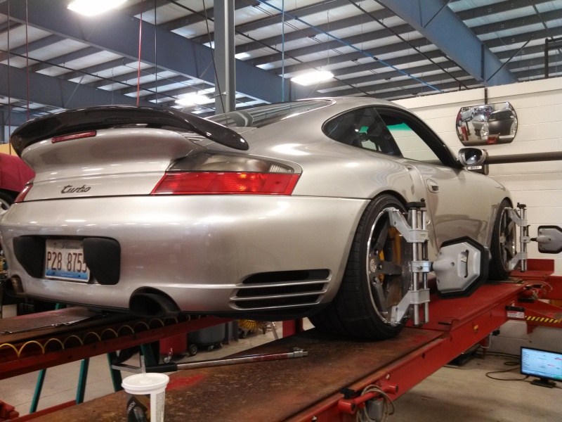

All bone stock turbo stuff. Wheel on car looks normal *** can be

something isn't adding up here...must be a severely distraught bushing/balljoint, likely in an upper arm(s), that is deflecting Heavily under load...

Car looks great! Unfortunately no way to do it at home. there are techniques but takes lots of experience to "string the car" Still need some equipment anyhow. Hopefully the guys who did it will re-do?
0 toe in the rear is way wrong. When you accelerate the tires toe out and just shredd!

definitely worth adding some toe to see if that helps, I still think something is worn out as the pic of the tire shows it eating the sidewall down, not just a bit of excessive inner tread wear....either way you need to locate the rear toe-link and be able to turn the eccentric, the 'large' part of the lobe needs to be turned towards the centre point of the car...to measure you need to make up a quick tool to get datapoints from front and rear rim lips..
