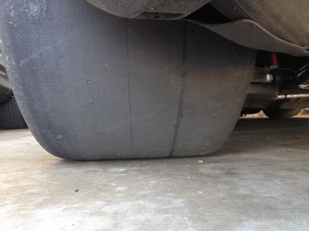

definitely worth adding some toe to see if that helps, I still think something is worn out as the pic of the tire shows it eating the sidewall down, not just a bit of excessive inner tread wear....either way you need to locate the rear toe-link and be able to turn the eccentric, the 'large' part of the lobe needs to be turned towards the centre point of the car...to measure you need to make up a quick tool to get datapoints from front and rear rim lips..
I agree, put it on a lift check for play and have someone look while wheel is being moved to see where it's coming from.

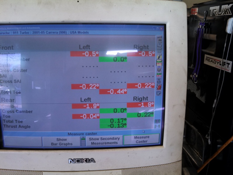

This is .20 positive toe right?

Thus is what just came up on a new alignment rack. What should I change the specs to?
Old Oct 26, 2013 | 01:05 PM
  #42
Engine Guy's Avatar
Joined: Nov 2011
Posts: 891
From: Alberta, Canada
Rep Power: 155
Engine Guy Is a GOD !Engine Guy Is a GOD !Engine Guy Is a GOD !Engine Guy Is a GOD !Engine Guy Is a GOD !Engine Guy Is a GOD !Engine Guy Is a GOD !Engine Guy Is a GOD !Engine Guy Is a GOD !Engine Guy Is a GOD !Engine Guy Is a GOD !
Front
Max out the camber but keep both sides equal
Toe +0.05 is a nice and stable set up. Or go -0.05 if you want a more responsive car, Do not go neutral 0.00 the car with hunt with irregularities in the road more.
Rear
-1.83 deg Camber again both sides equal
Toe +0.17 to +0.25 per side, I would go +0.20 to +0.22 per side for your set up. In the back Dead equal both side on the toe is super crucial.... I can not stress that enough!!!!

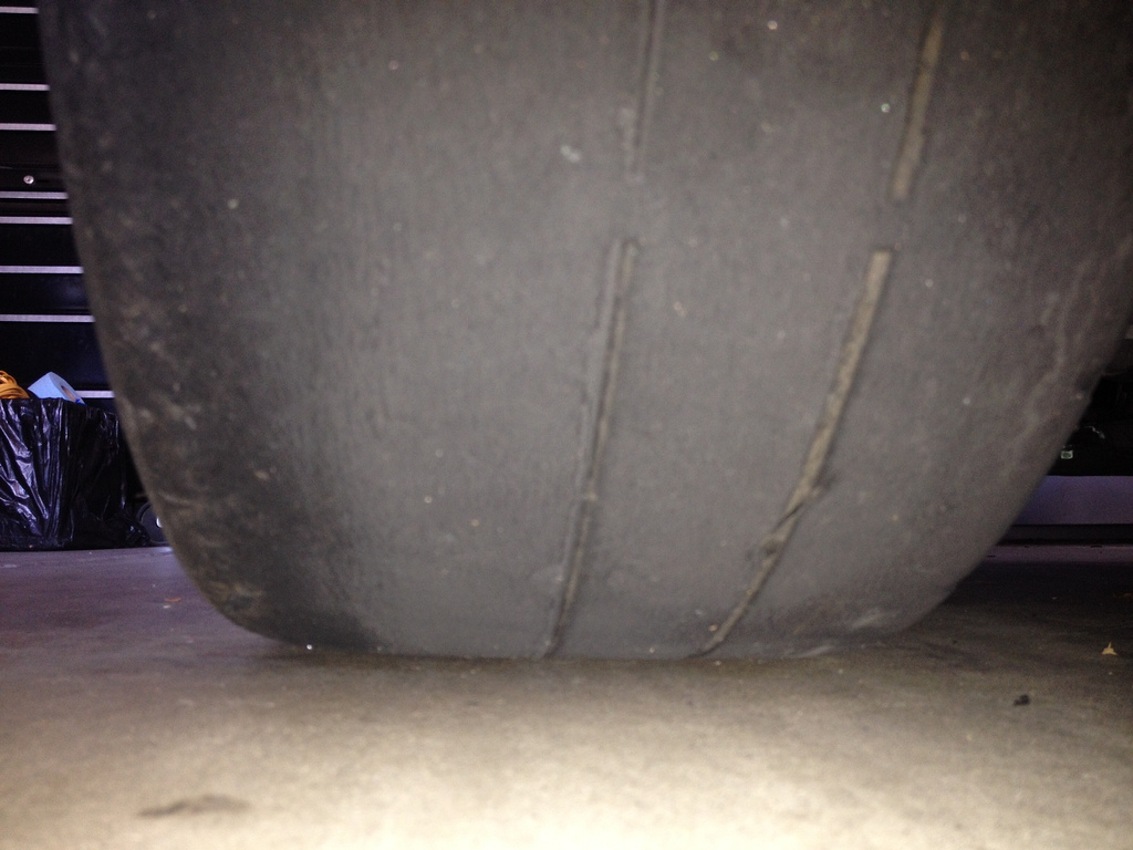

These are my alignment settings:
Front camber: -2.83deg
Front toe: +0.03' per side (+0.06' total)
Rear camber: -2.25deg
Rear toe: +0.17' (+0.34' total)
Ride height: Front 102mm, 125mm rear
Tires: 245/40/18 and 305/35/18
Even though I run an aggressive alignment, my tire wear is perfectly even as you can see in the pictures and the tires are just about down to the cords as you are staring to see the vertical striations in the body of the tire. My tires wear equally front and rear even though I'm RWD so I always replace all 4 at a time. One thing I will tell you is that my inner tire wear improved dramatically when I went to full monoball on the suspension and locked down the toe settings. Wearing out the inside portion of the tire is normally due to too much toe, not camber, so don't be scared of having some camber. With all the rubber there is in the suspension, your toe is all over the place as the whole wheel assembly moves fore and aft by as much as a 1/4" under load as the rubber bushings compress when braking and accelerating aggressively. As you accelerate toe in increases as the wheel assembly is pulled forward and vice versa as the wheels "spread" under hard braking. This toe change kills your tires and it shows up on the inside portion. Install solid caster pucks in your LCAs along with adjustable toe arms and you will see a huge improvement.
