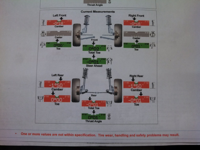

I rolled the fenders, they rubbed horrible. My tires look brand new except for 2" on the inner side. Already bands showing through. Here is my alignment

I'd bet you have some worn rear bushings which are allowing toe in shift under load, should also dial in some rear toe-in while under there...

V the car cannot feel right. You will solve your issue by adding in toe. Try .20 in. What is happening is that under load the tires are opening outward shredding themselves. It make s the car feel super loose too.
Try this:
- Max front camber negative. (won't be much). Your rear camber is as low as it will get.
- Front toe 0.0 or green.
- Rear toe .20 in.
You will love the feel and the tires will wear better. It's a bit more rear toe than stock because with 480-500 hp you will squat more than stock and tow out 15-25deg.
I guarantee you will be happy. Let me know if I can help with anything.

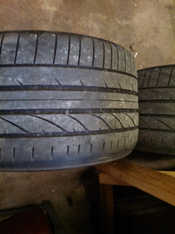

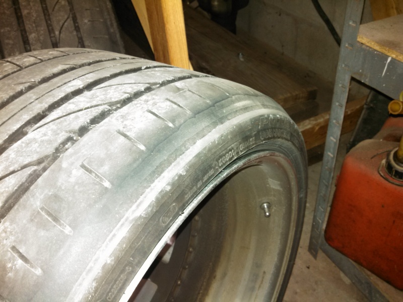

Here is my 5th set of tires in a year

I have noticed that after i lowered it, and the alignment it has felt loose under initial load. Like all 4 tires were spinning. How can I adjust this at home? My alignment shop is over an hour away, plus I don't want to spend 300$ for a bolt to turn a couple mm.
