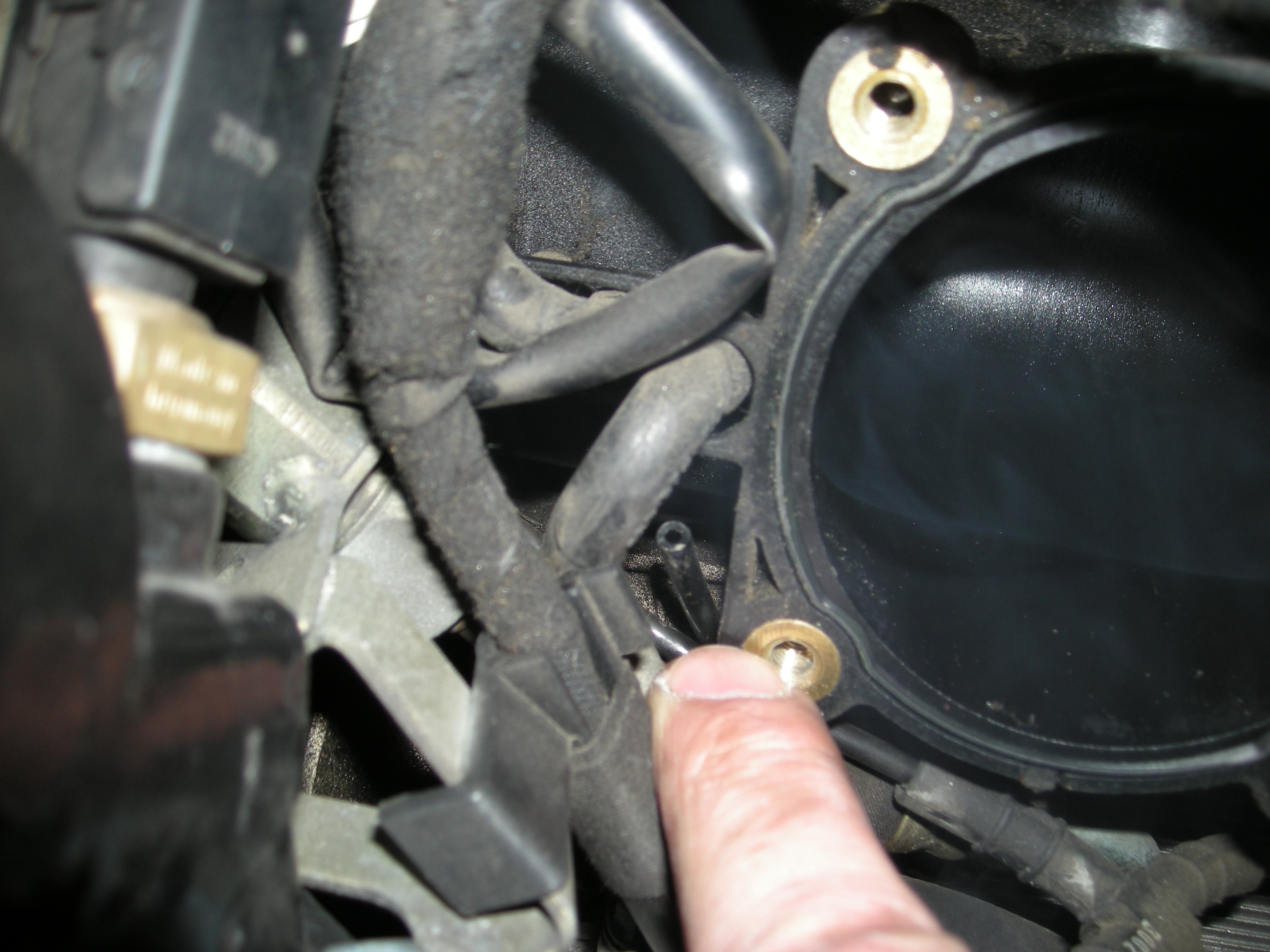

Sounds too much like a vacuum leak. Very hard to find without smoke. I had one that drove me nuts for a few days. Turned out to be small vacuum line behind the throttle body.
Look at this picture closely. You ca see the plastic line that came out of a hose. Reinstalled and ziptied...Keep looking...you'll find it.
