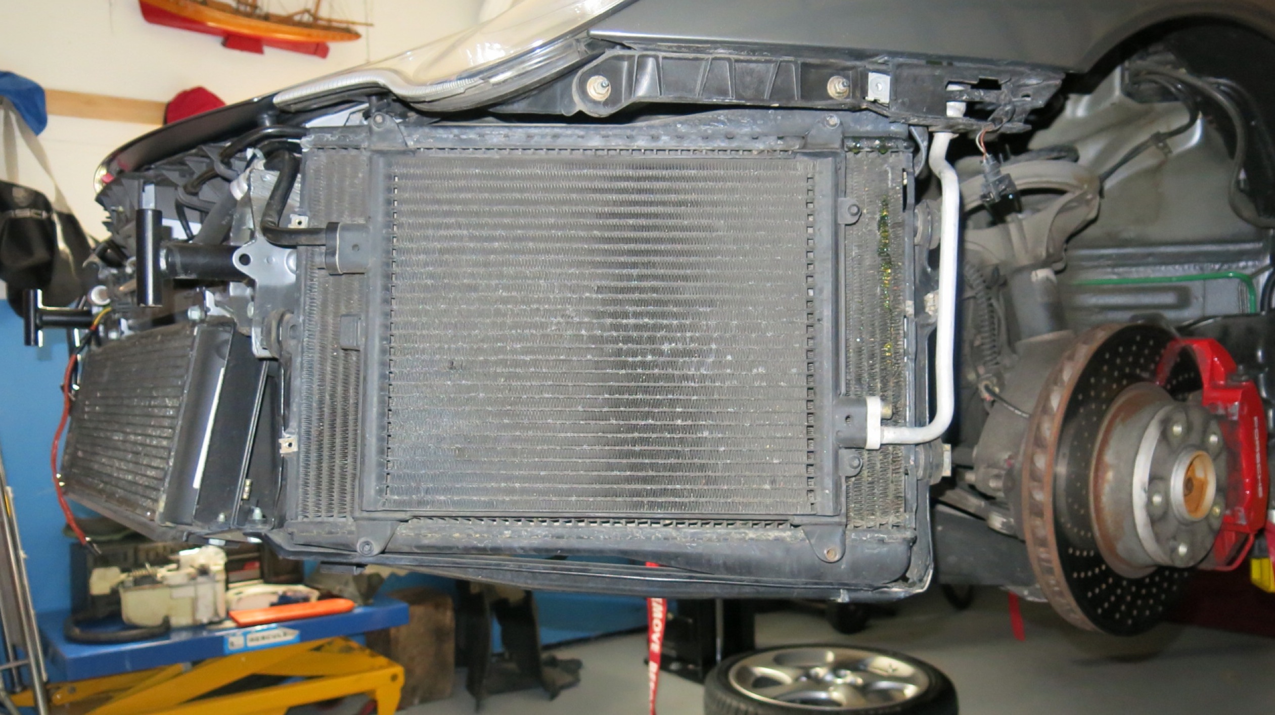

Every year I'm removing the front bumper cover for radiators clean-up. Since I had a strong coolant smell every time I was driving the car hard decided to pressurized the coolant system. With 15 psi found a leak at the top of the driver side radiator. Can it be fix or I need a new one? part# 996-106-131-72 supersede by 996-10-131-74 ($573.50 ouch!)

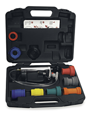

How did you pressure up the system? I need to do this as well.

I got a Blue point radiator pressure kit SVT275-1….Good product...

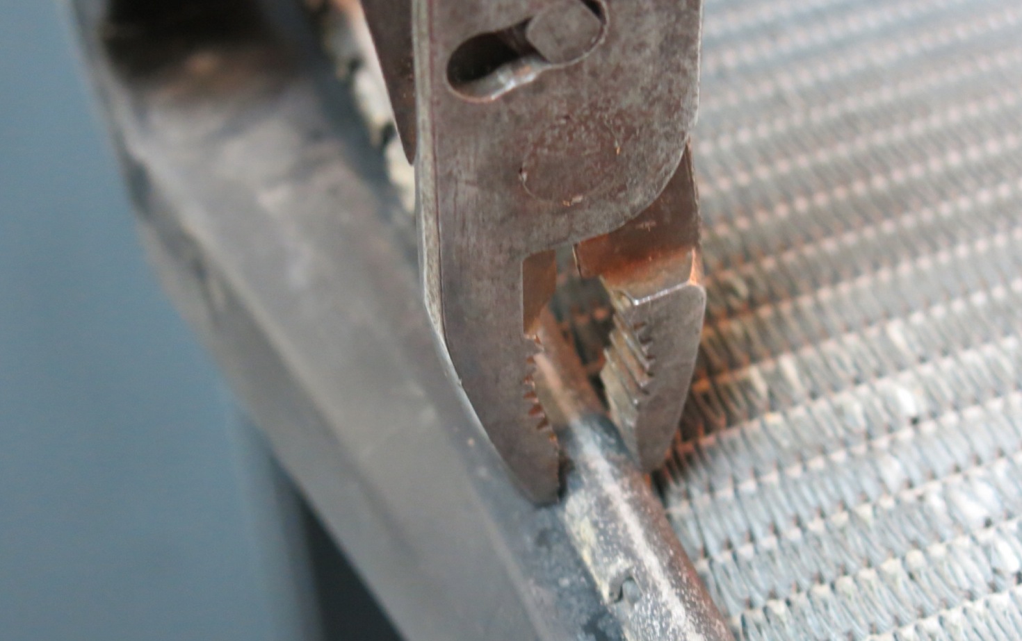

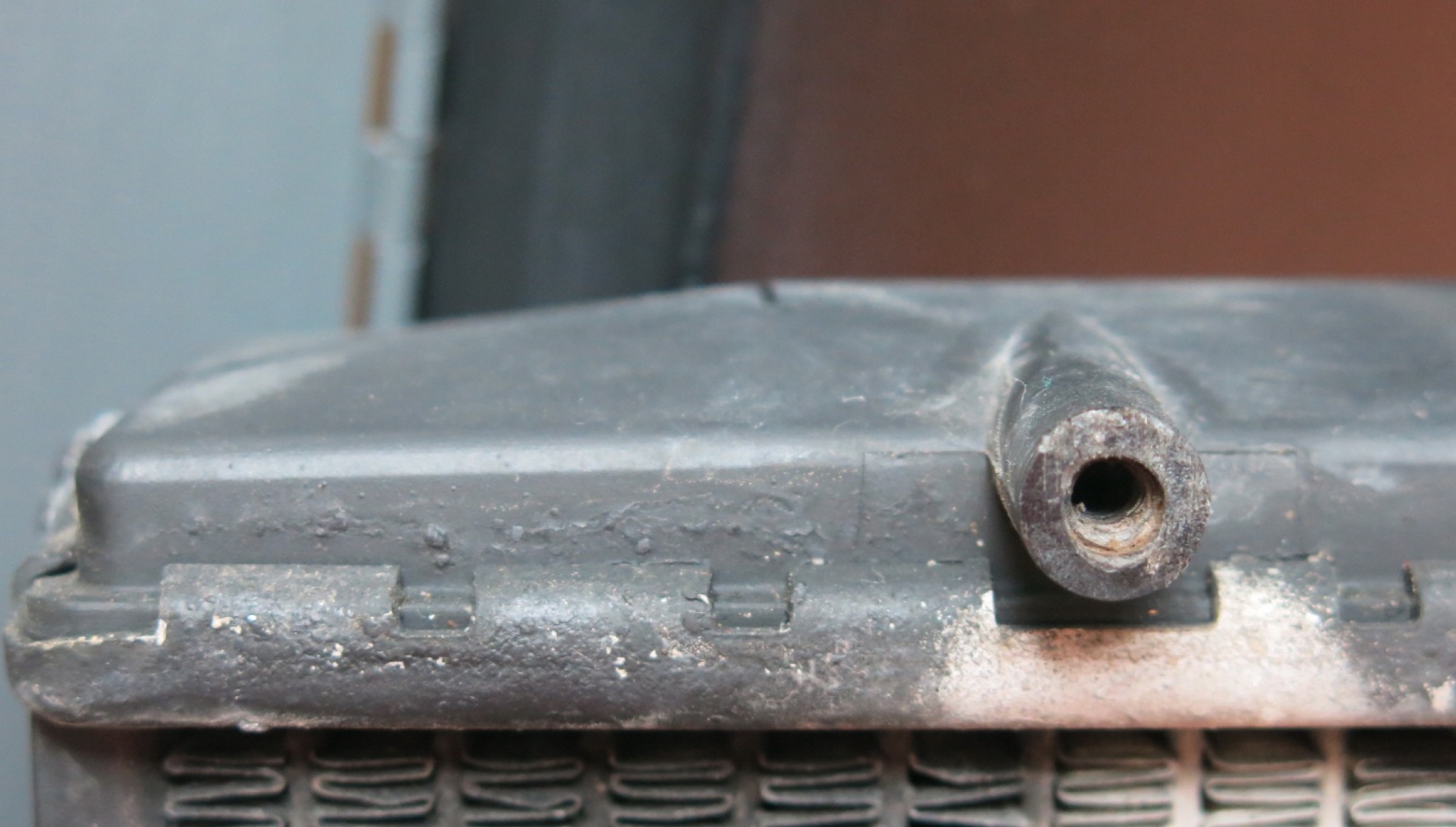

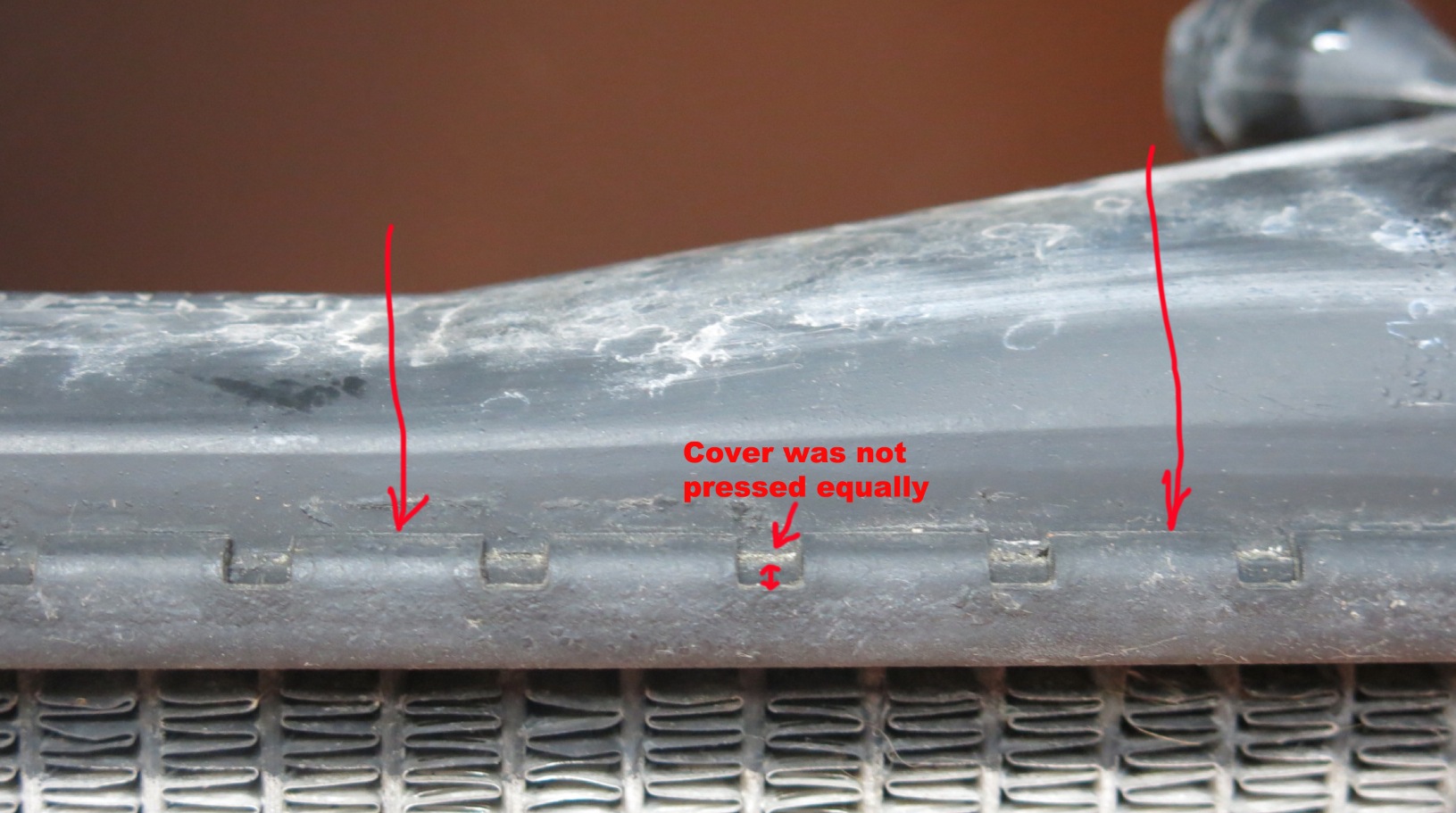

Update: I went to see a welder that a friend suggested and this guy saw a problem with my radiator almost immediately. Where the leak was, the plastic cover was not equally press down on the radiator. We use a special tool to bend the clips properly at the leaking area and did a pressure test at 10 pounds in his garage and no more leak….Once home I did the same thing on both faces of the radiator all around both covers and after the radiator reinstallation, got the PST2 out and did, for the first time, the "Special function" called "996 turbo cooling" that is used to bleed the TT. This function delay the fan operation and the temperature of the system is aloud to go up to 210 F ! This function takes about 20 minutes to do with the engine running and help you to fill the system properly. I did it twice to be sure and there was no sign of leaks anymore…. I did a good inspection of all three radiators and there is no sign of corrosion on any of them and I think it was worth trying to save it…. Will keep you updated on that one
