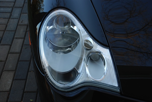

02 - glove box and no bumperettes
you'll still have the same problem as the 01-05's though..
what are you going to do about this ...
just ****ing with you fellas.
