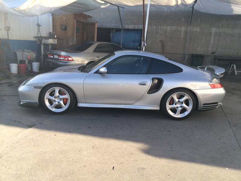

Unfortunately I am less than novice on DIY repairs...so in gonna have to take to GMG to diagnose. Hence why I'm also trying to know what labor hours should be to replace coils ( if needed), as well as replace cam solenoid and bracket.
Thanks!
Colin
