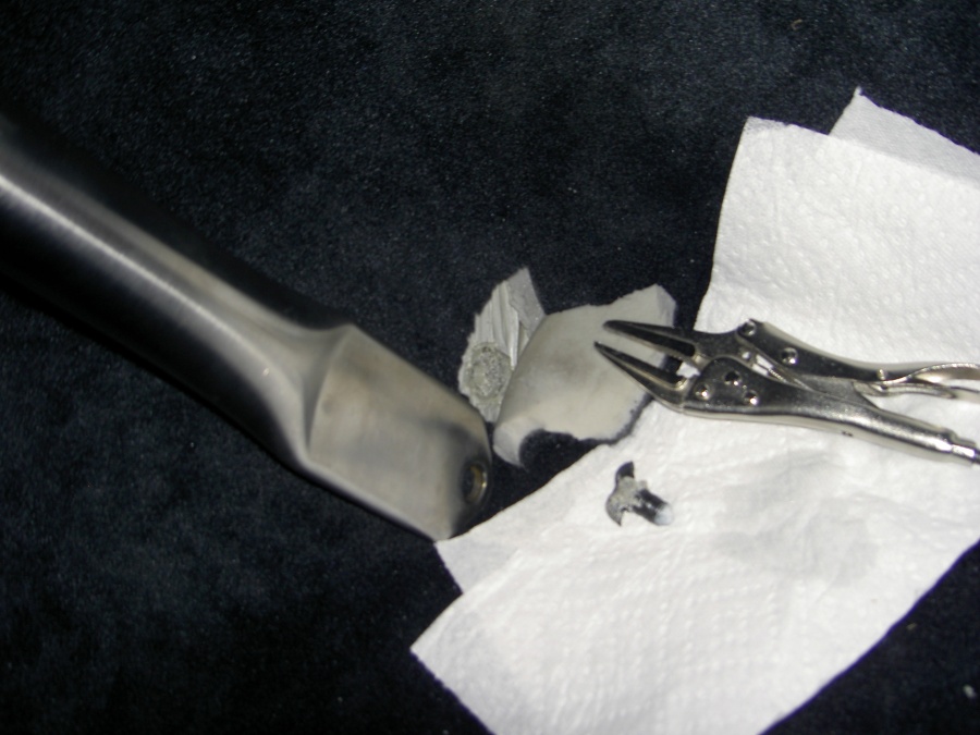

After carefully repositioning the rollbar and removing the lower spacers, I went and cleaned the threads with a 7/16-20NF tap (one trick I discovered was to use an 8 mm socket/0.25" drive attached to a 8mm allen key socket to drive the 1/4 inch square tap end) since the normal T handled wrench does not work with the limited access. Then I went and cut the carpet near the corner of the rear seat area to expose the plastic plug (Porsche doesn't want people to install the Tequipment bar in the 997 GT3) which was buried behind caulking. After vice gripping the end I was able to pull out the mangled plugs exposing the holes for bolting the rear of the bar. All this took another 4 hours!

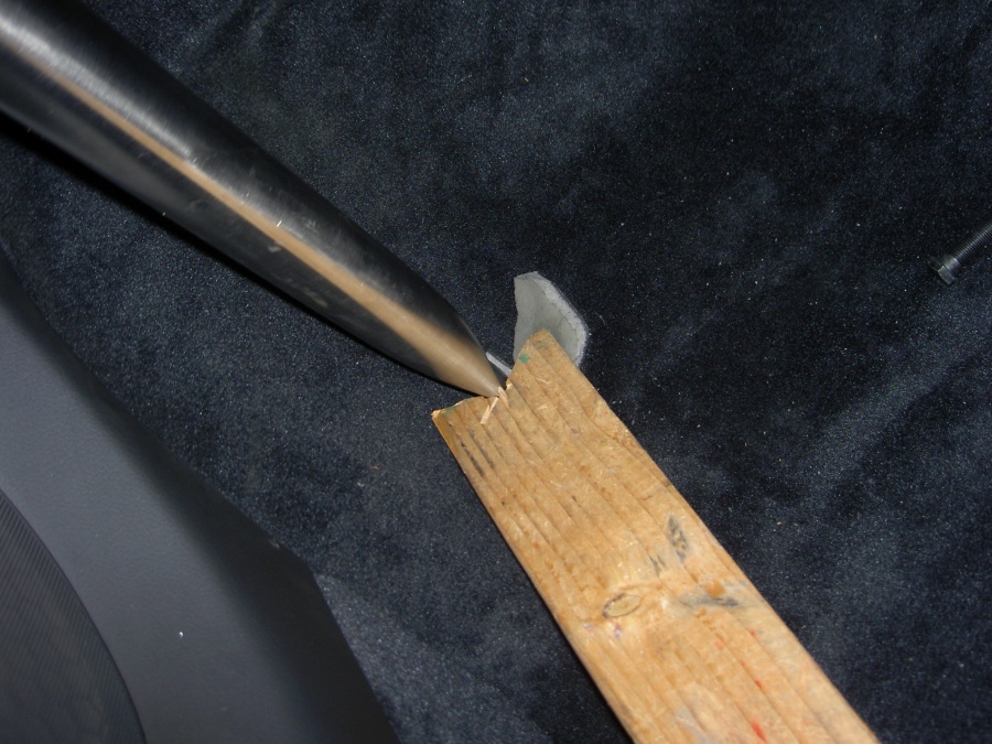

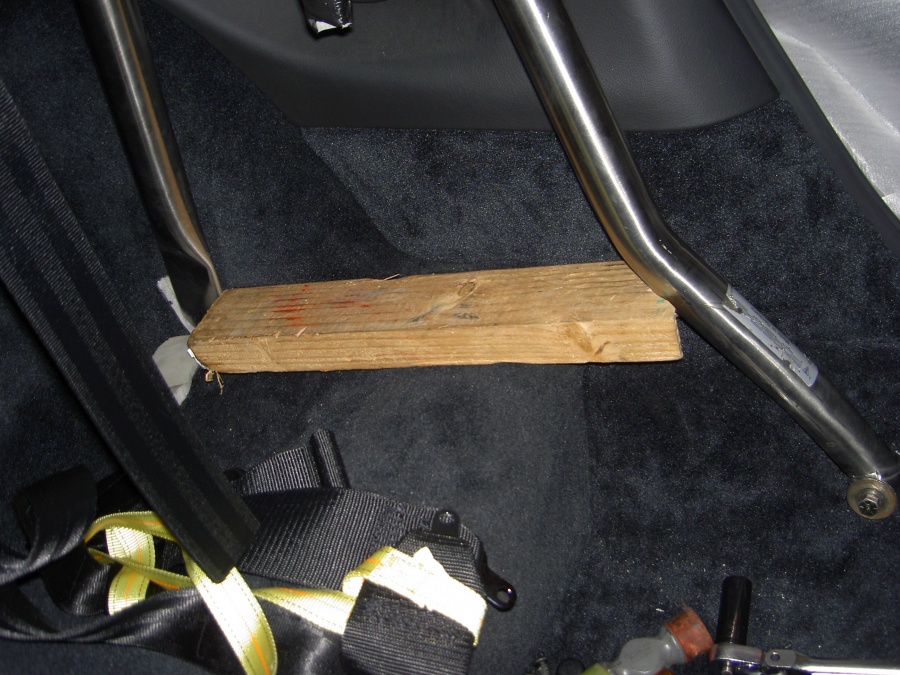

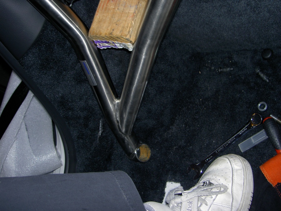

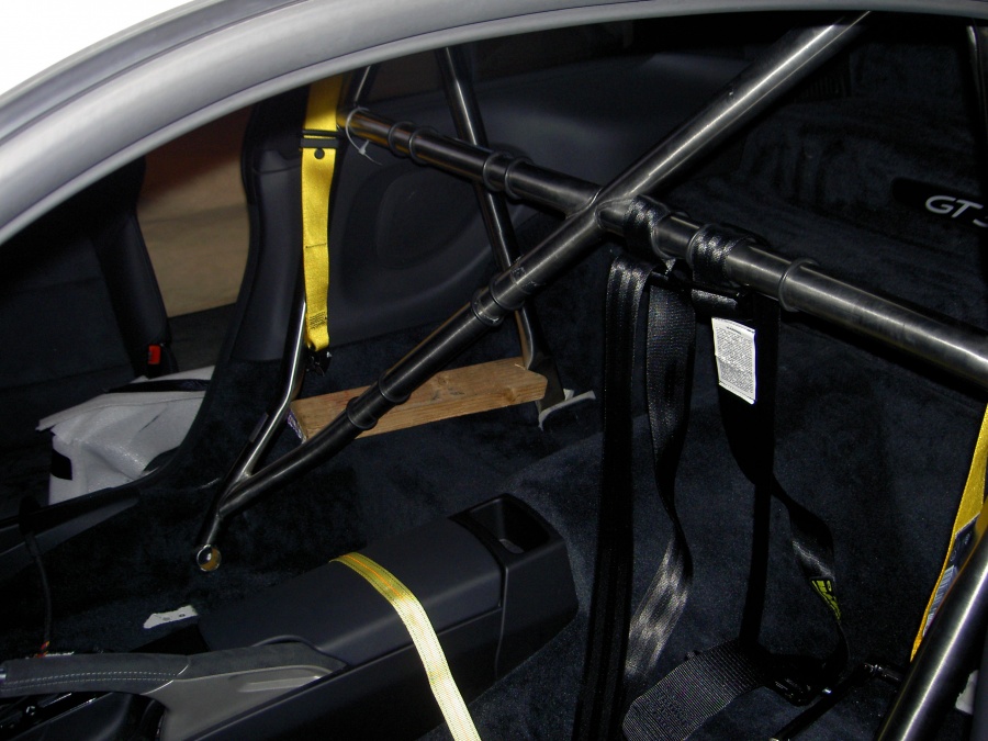

OK, finally got the bolts all in their respective holes. A nice trick which worked for me is cutting a piece of 2X4 and notching one end to help push the bars arm away from the leg to help align the holes before threading in the bolts. See posted photos. The bottom bolsters were cut after I cut a bit of the carpet and I never tried to remove them. I used a long drill bit, a saw, and chisel to make the appropriate cuts to clear the way for the legs to slip into the groove. So my procedure differs from the others in not having to remove much trim at all.
