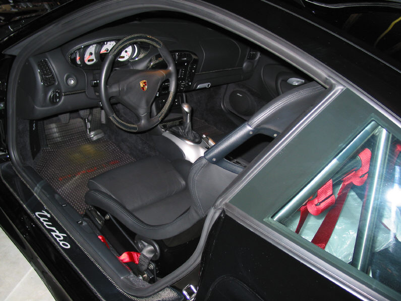

I love that look. I wish I could put one in my car, but I stll use the back seats every once in a while.
