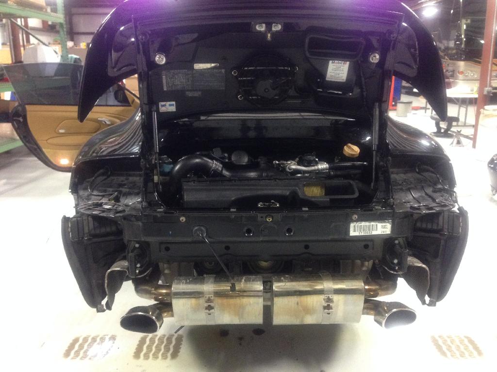

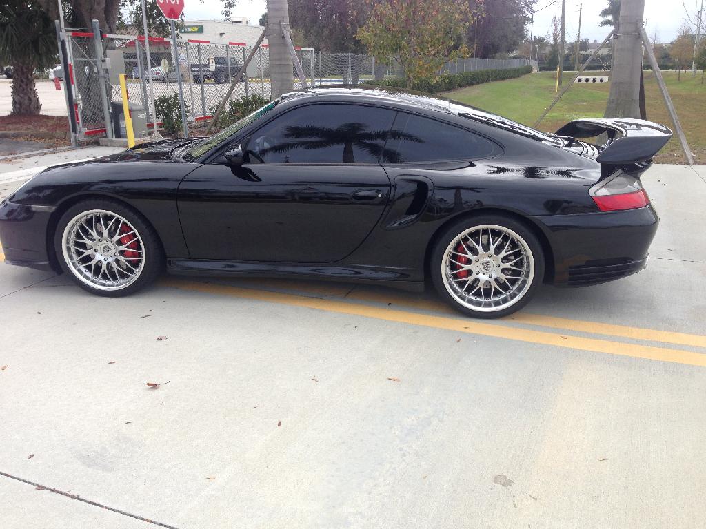

Here she is before and after...

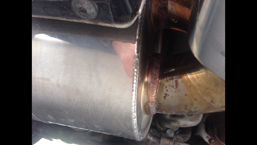

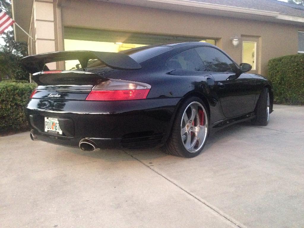

Nice lookin car, show us pics of the exhaust and we can tell u what it is

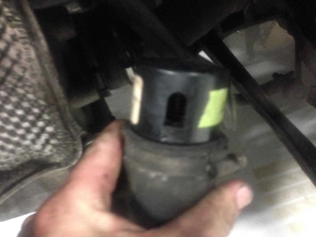

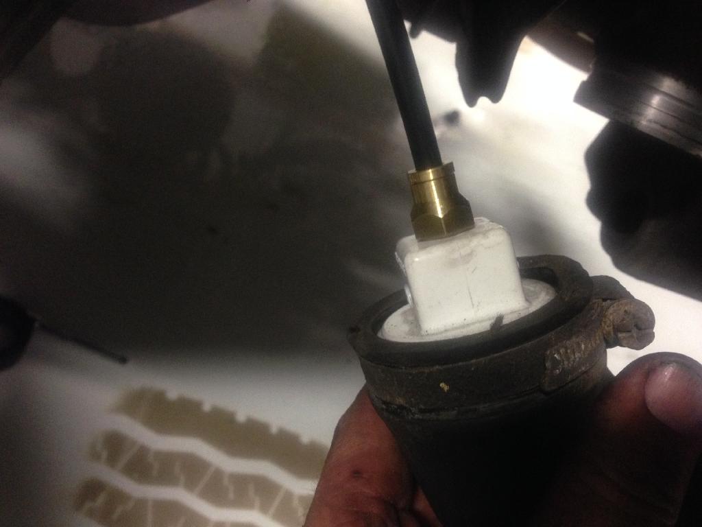

In case it could help anyone, here are pics of my crude pressure tester "kit". I used a 1 1/2 inch "vent check", used as a vacuum breaker under your sinks...lol, as the plug. I used a 1 1/2" pipe plug, drilled and tapped a 1/4mpt x 1/4 air brake line "press-loc" fitting. I used a pressure gauge with a tire valve stem and a pressure regulator. It can all be found at Home Depot. I also attached a pic of the rear rim while dis-mounting....
I will put this car back in "as good or better than new condition" even if it kills me!

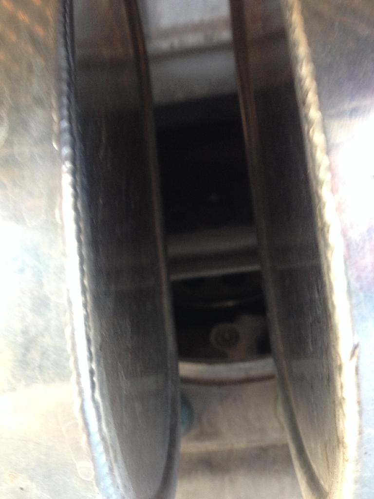

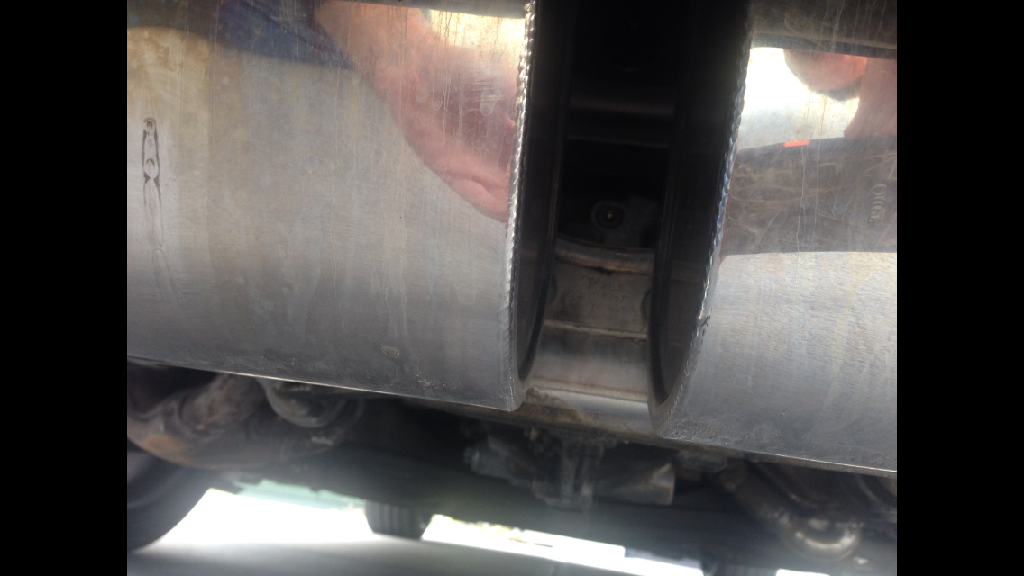

Any ideas on what the exhaust is?
Old Dec 16, 2013 | 06:50 AM
OS Inspector's Avatar
Joined: Aug 2009
Posts: 2,496
From: Houston Tx
Rep Power: 187
OS Inspector Is a GOD !OS Inspector Is a GOD !OS Inspector Is a GOD !OS Inspector Is a GOD !OS Inspector Is a GOD !OS Inspector Is a GOD !OS Inspector Is a GOD !OS Inspector Is a GOD !OS Inspector Is a GOD !OS Inspector Is a GOD !OS Inspector Is a GOD !
need some further back but there are very few exhausts that are not connected in the middle first guess Billy boat,
Old Dec 16, 2013 | 08:13 AM
Vantaredoc's Avatar
Joined: Nov 2013
Posts: 1,052
Rep Power: 154
Vantaredoc Is a GOD !Vantaredoc Is a GOD !Vantaredoc Is a GOD !Vantaredoc Is a GOD !Vantaredoc Is a GOD !Vantaredoc Is a GOD !Vantaredoc Is a GOD !Vantaredoc Is a GOD !Vantaredoc Is a GOD !Vantaredoc Is a GOD !Vantaredoc Is a GOD !
Just went out and looked. Definitely nothing connecting the two sides! Is that bad? I mean, real bad??

I think it's a Fabspeed... http://www.dragtimes.com/parts/Fabsp...189726465.html

What's the good bad and ugly about Fabspeed ? Should I be concerned? Would the car need reprogrammed after changing exhaust? Thanks for any input!

No it would not .

Leave it on and concentrate on more important things
