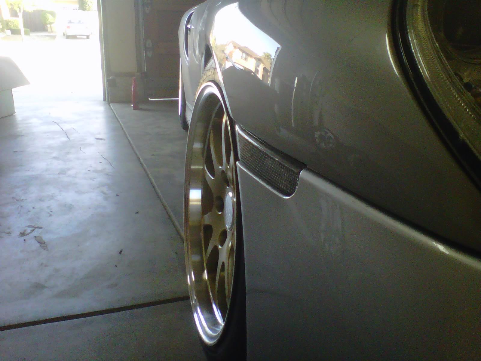

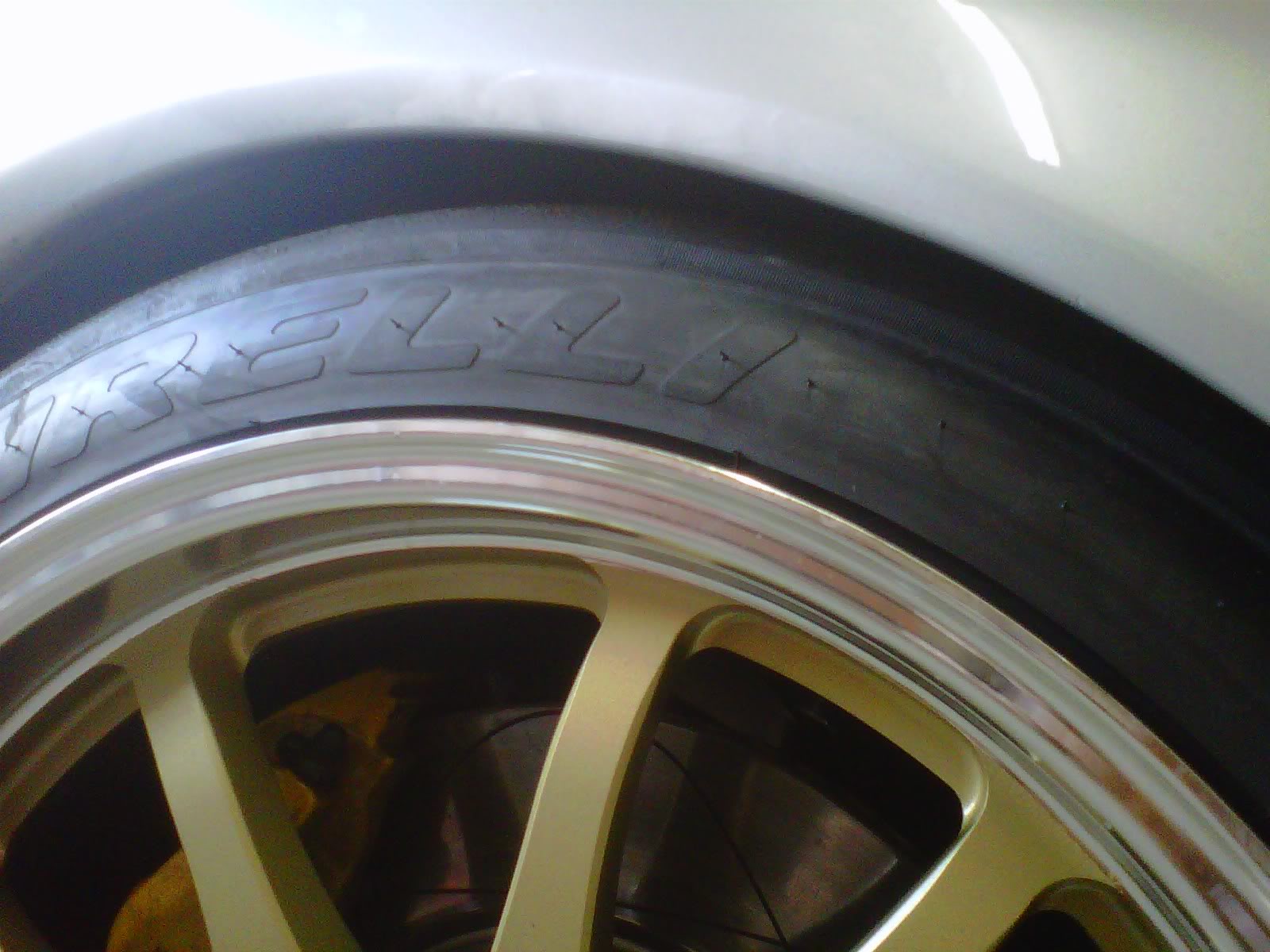

Stock front: 8 x18
offset: 50
Stock rear: 11x18
offset: 45
I have done
Front: 10x18
offset: 45
rear: 12x18
offset 42
If I you want 9"s up front with perfect flush
front:
9x19
offset of 30
If you want perfect flush on rear using 12:
offset of 32
Been there - done that. -3.2 neg camber up front and -2.5 camber rear.
If I could do it again. I keep front size, and I would do 11.5 rear.
You can thank me later.
Pictures from the settings I have done. You can see rear at 45 offset with 12" how its to far in. I could still put a 14mm spacer and it was flush.

Thanks for the input! Are the pictures 18's or 19's?
