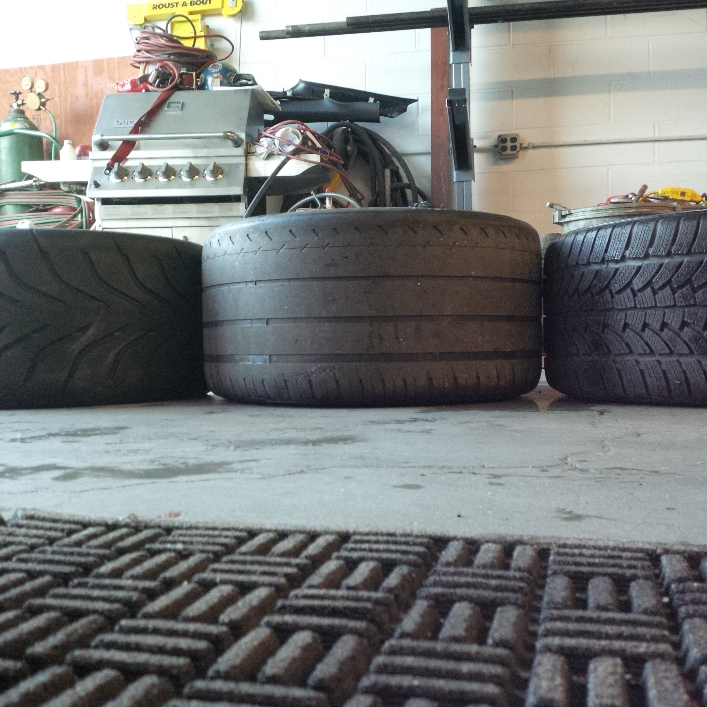

ready to be mind-f****ed ?
these are three tires that are supposed to be the same size on paper. what gives ?
Haha a picture is worth a thousand words. Never trust those numbers on the side of the tire!
