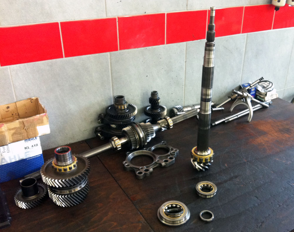

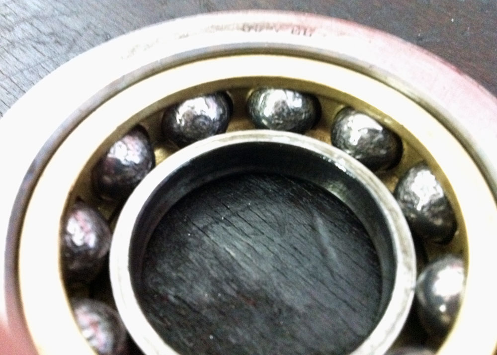

Here is the bearing from the first time round.
Question...
To get to this bearing my first tech disassembled the whole gearbox.
Is this also required now for this "2nd bearing"? Or is this second bearing by the diff and is therefore no need to disassemble/assemble the whole gearbox again?
I presume the first bearing (which went bad) is on the photo at the bottom of the shaft? Which/where is this this 2nd one which is pressed onto the shaft?

Here are the two bearings that take the most abuse.
999.052.094.00
999.052.164.00 This one more so then the other.
These two bearings locate the shafts, the 999.052.094.00 is on the main shaft and the 999.052.164.00 sets the pinion depth on the pinion shaft.
