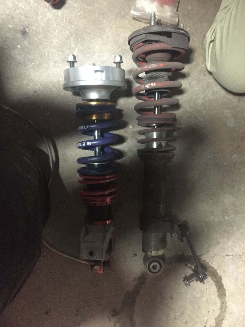

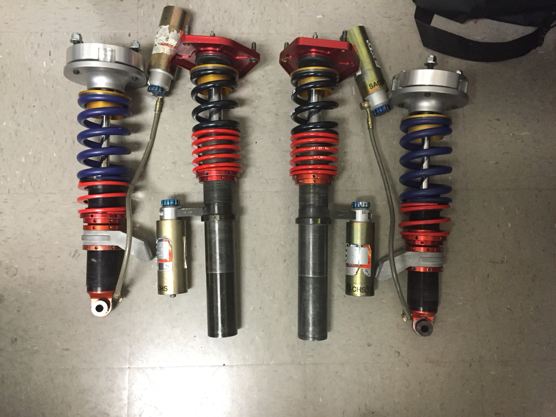

Old Sep 14, 2016 | 07:08 PM
  #43
VAGscum's Avatar
Joined: Oct 2008
Posts: 1,696
From: Portland Oregon
Rep Power: 188
VAGscum Is a GOD !VAGscum Is a GOD !VAGscum Is a GOD !VAGscum Is a GOD !VAGscum Is a GOD !VAGscum Is a GOD !VAGscum Is a GOD !VAGscum Is a GOD !VAGscum Is a GOD !VAGscum Is a GOD !VAGscum Is a GOD !
Here is a comparison of the Sachs GT3cup shocks compared to H&R coilovers. The rears are significantly shorter as suspected. Fronts are almost identical length. Will see what the rears look like with the wheels and subframe.
ID:	458913   Click image for larger version
Old Sep 15, 2016 | 06:53 AM
  #44
stevemfr's Avatar
Joined: Mar 2012
Posts: 500
From: strasbourg, france
Rep Power: 83
stevemfr Is a GOD !stevemfr Is a GOD !stevemfr Is a GOD !stevemfr Is a GOD !stevemfr Is a GOD !stevemfr Is a GOD !stevemfr Is a GOD !stevemfr Is a GOD !stevemfr Is a GOD !stevemfr Is a GOD !stevemfr Is a GOD !
This is about as close as it gets to any real information. Then again, this thread has almost everything you need to know. What other information are you looking for?
Nice to see you back into it VAG. I was always really curious how this would turn out.
Old Sep 15, 2016 | 08:46 AM
  #45
pwdrhound's Avatar
Joined: Jul 2010
Posts: 4,848
Rep Power: 457
I've set up a lot of suspensions on these cars and my guess is that the rears will be way too short even with the aluminum spacer you are using. A quick calculation tells me you'd need a spacer about 3" thick to get you where you need. The very limited shock travel /droop may present a handling issue with soft springs and a heavy car. You do not want to run out of travel in the rear as that will present dangerous mid corner snap oversteer. (always make sure you end up with more droop in the rear than the front!). Hope I'm wrong and it all works out without issues. Good luck...
