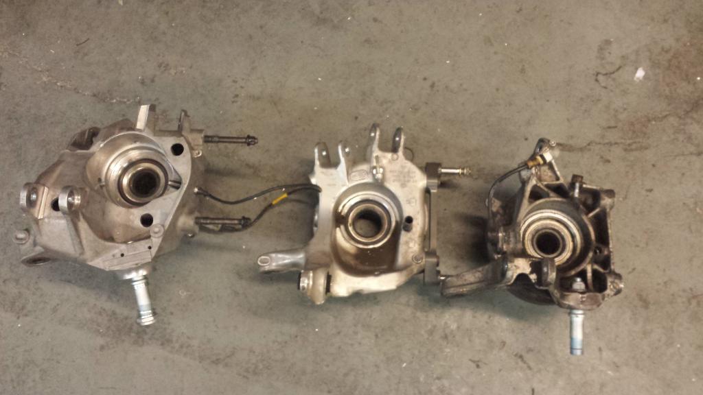

The teams I know use those shocks when they paint or do body work. Do you have pics? rsr rear shocks uses the same ends as 996 turbo. The fronts would need a sleeve and a top mount.

Left RSR. middle 997T. right 996T
I am actually more concerned with the front. But, now that you posted pics the rears may of a concern too.
