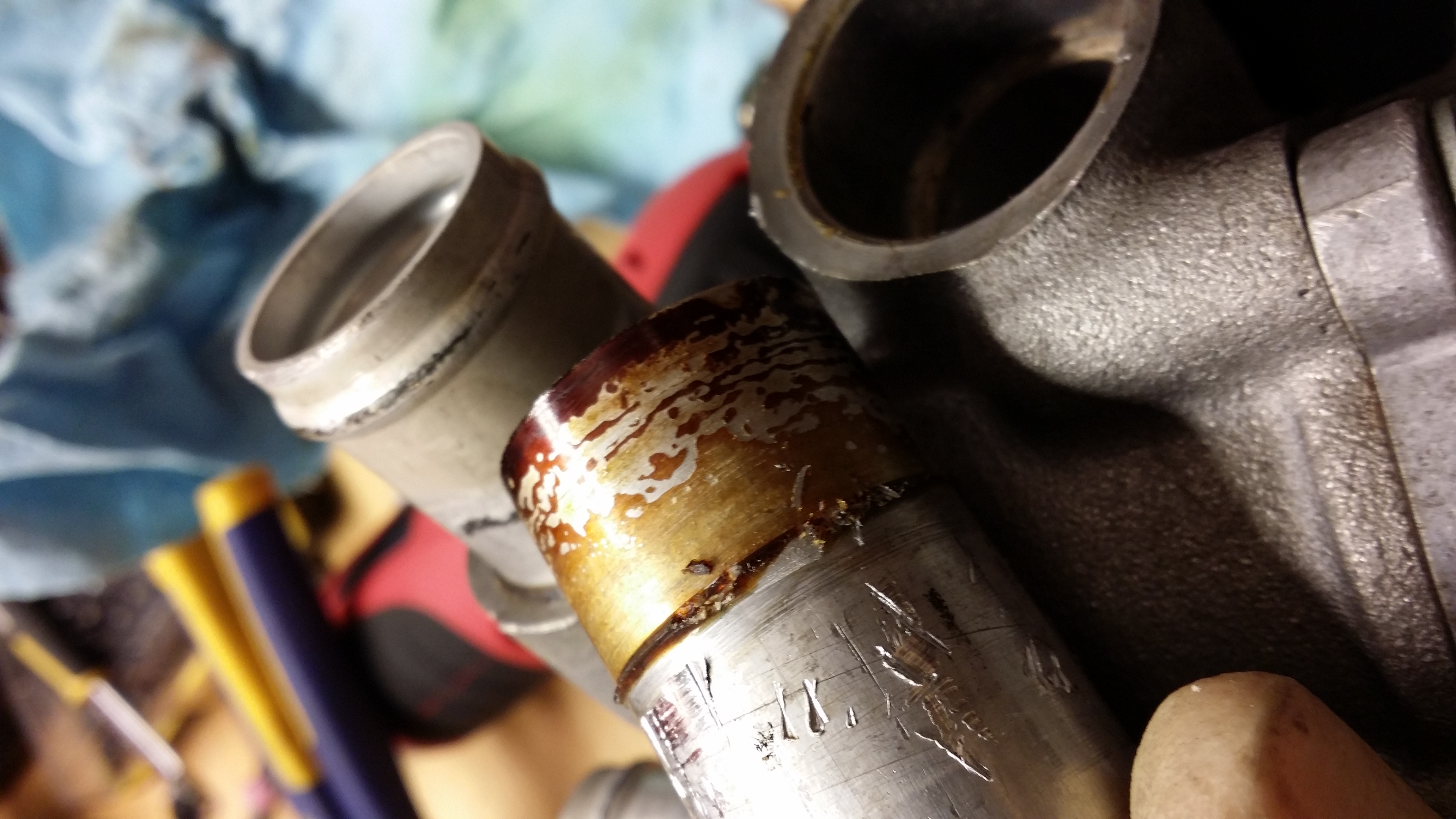

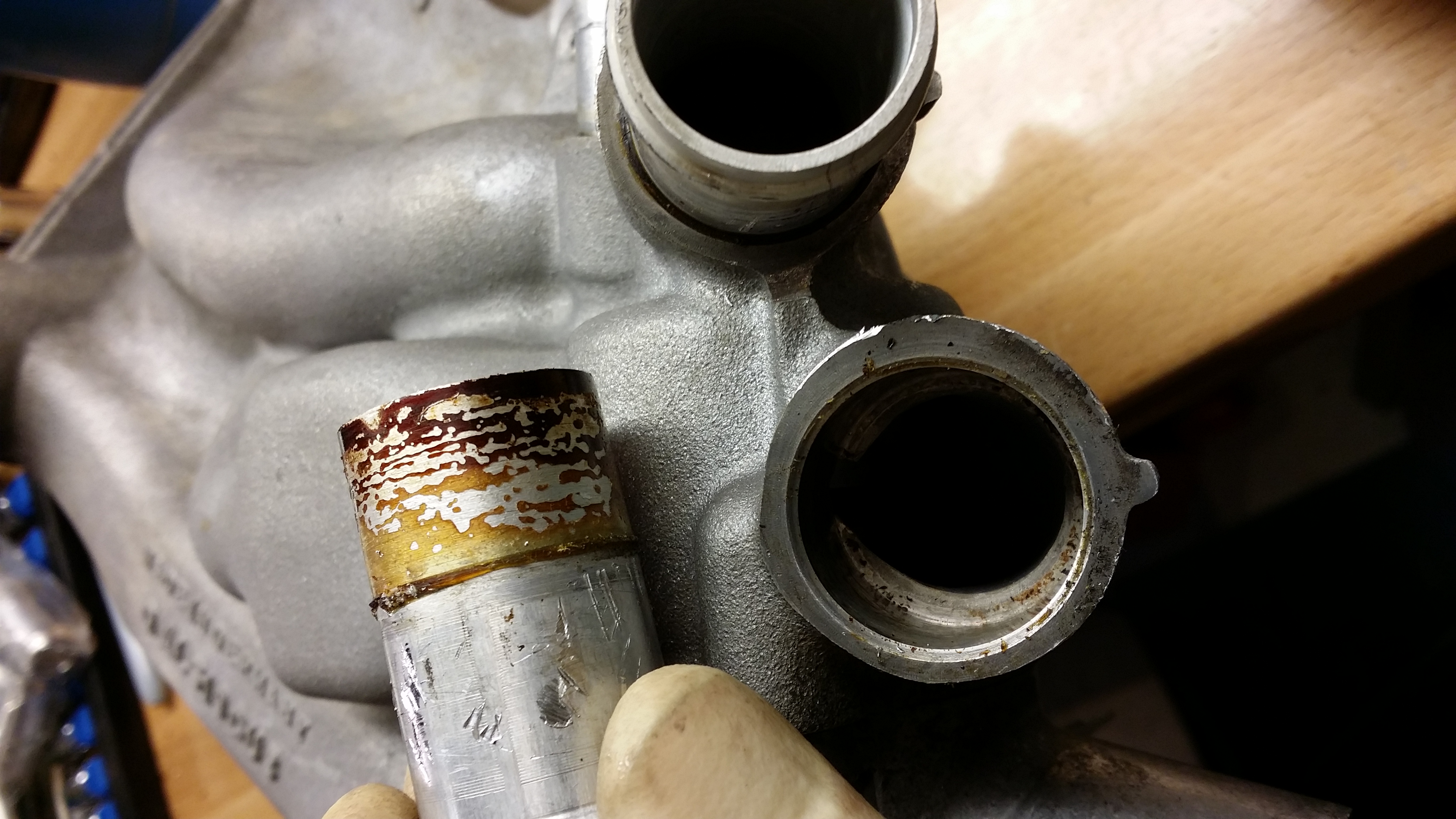

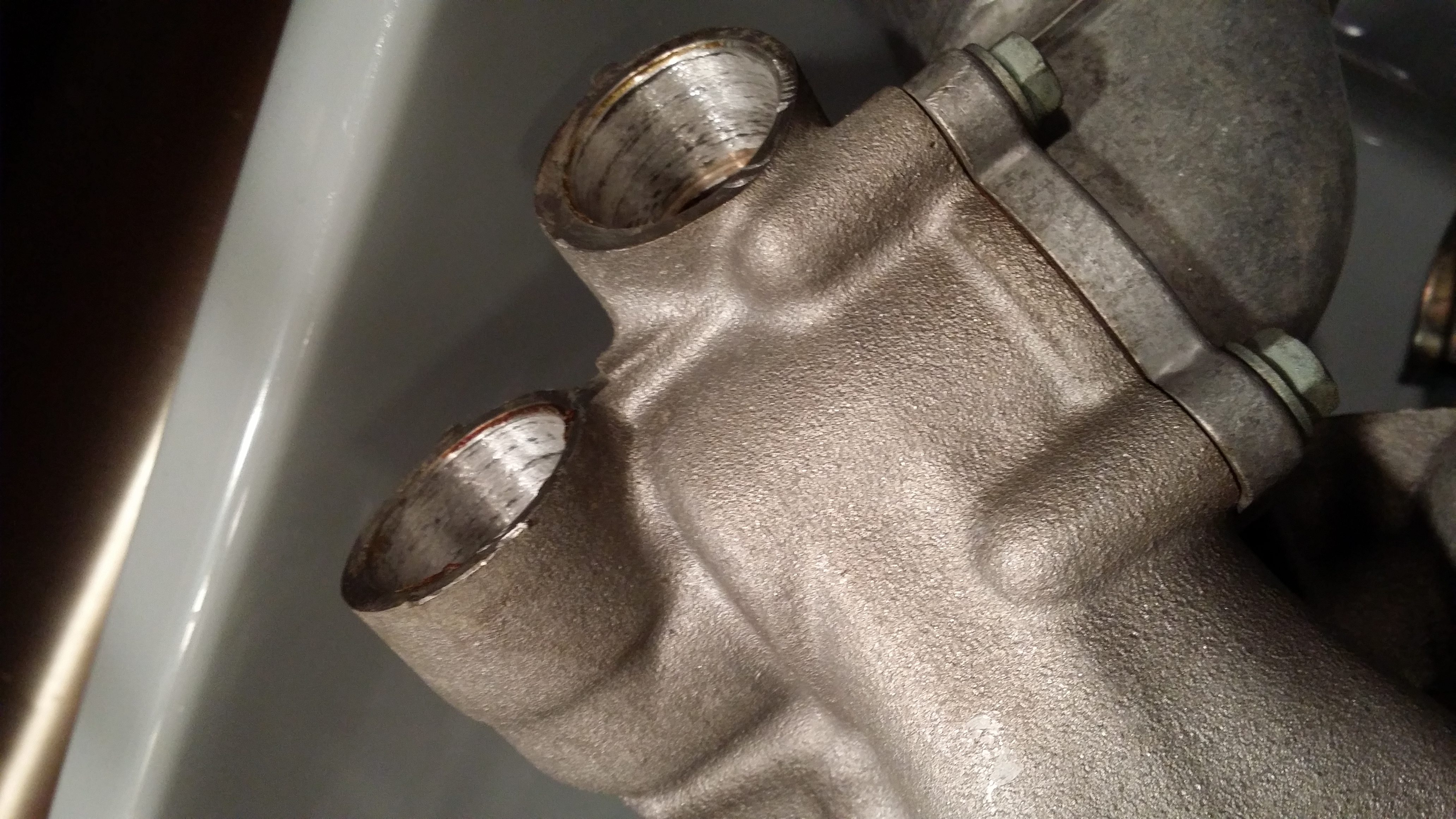

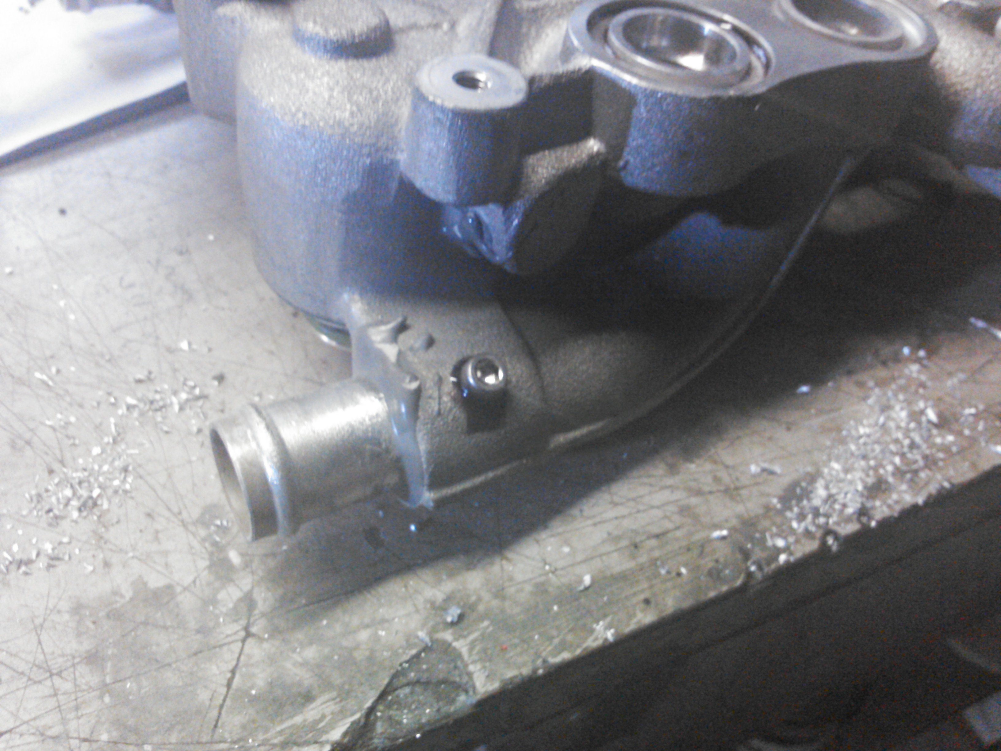

I am doing the other ones tonight
ID:	334789   Click image for larger version
ID:	334790   Click image for larger version
ID:	334791   Click image for larger version
ID:	334798   Click image for larger version
ID:	334799   Click image for larger version
ID:	334800   Click image for larger version

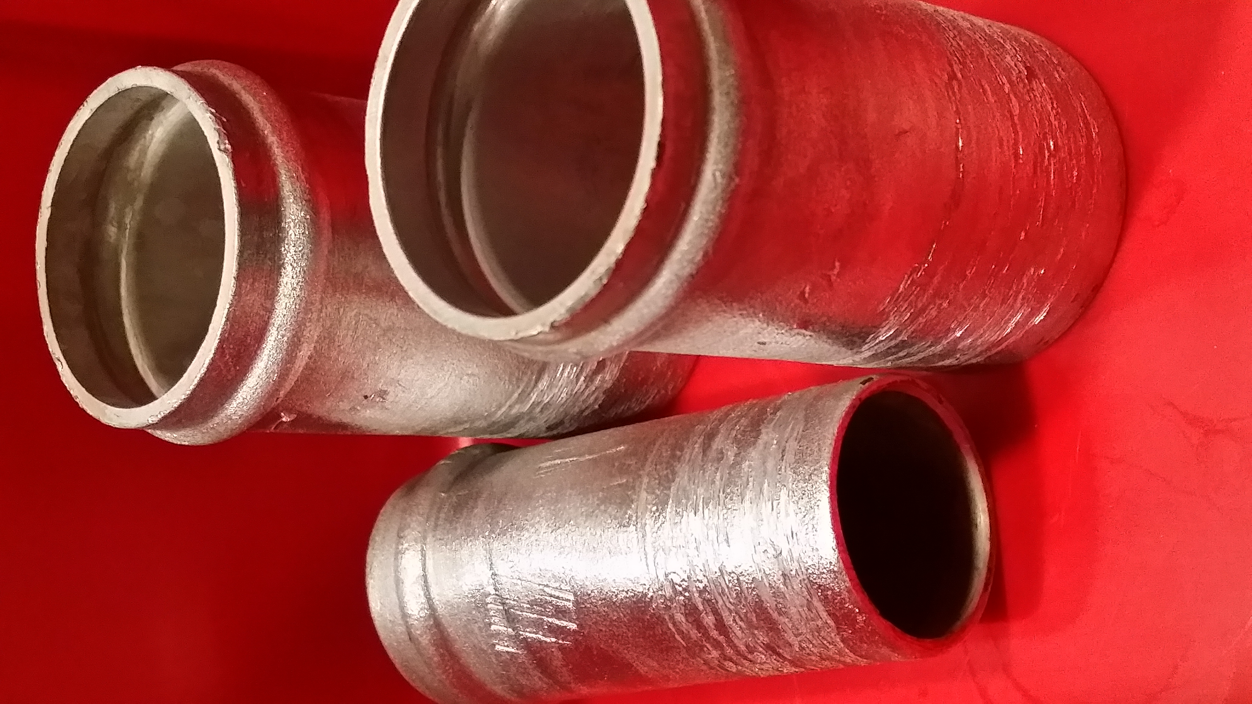

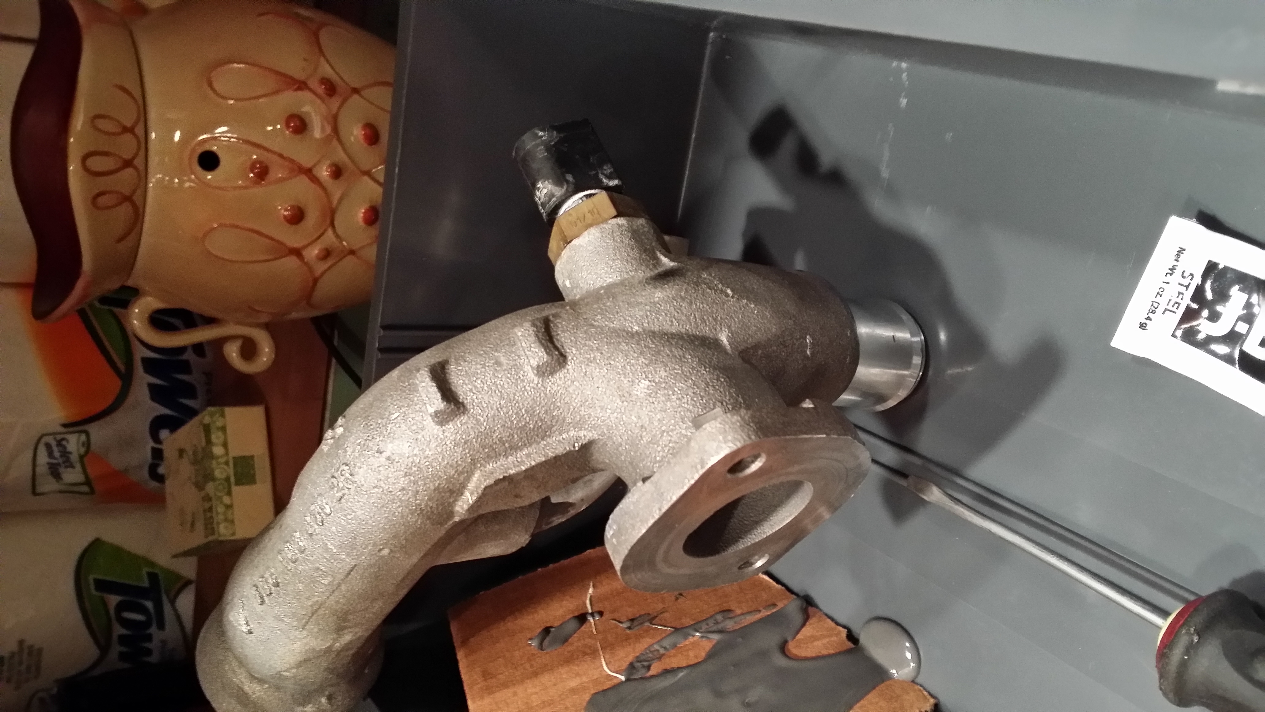

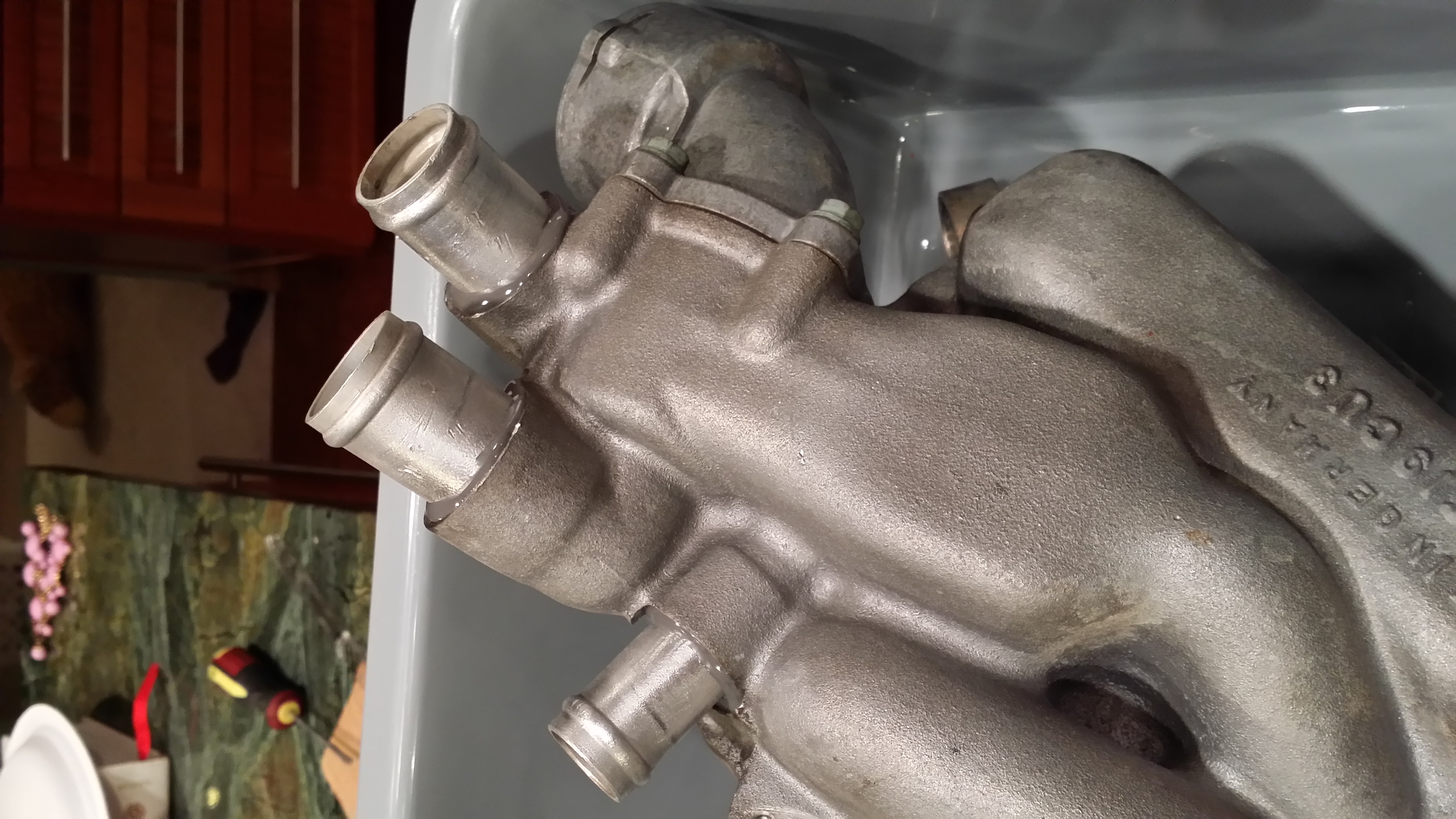

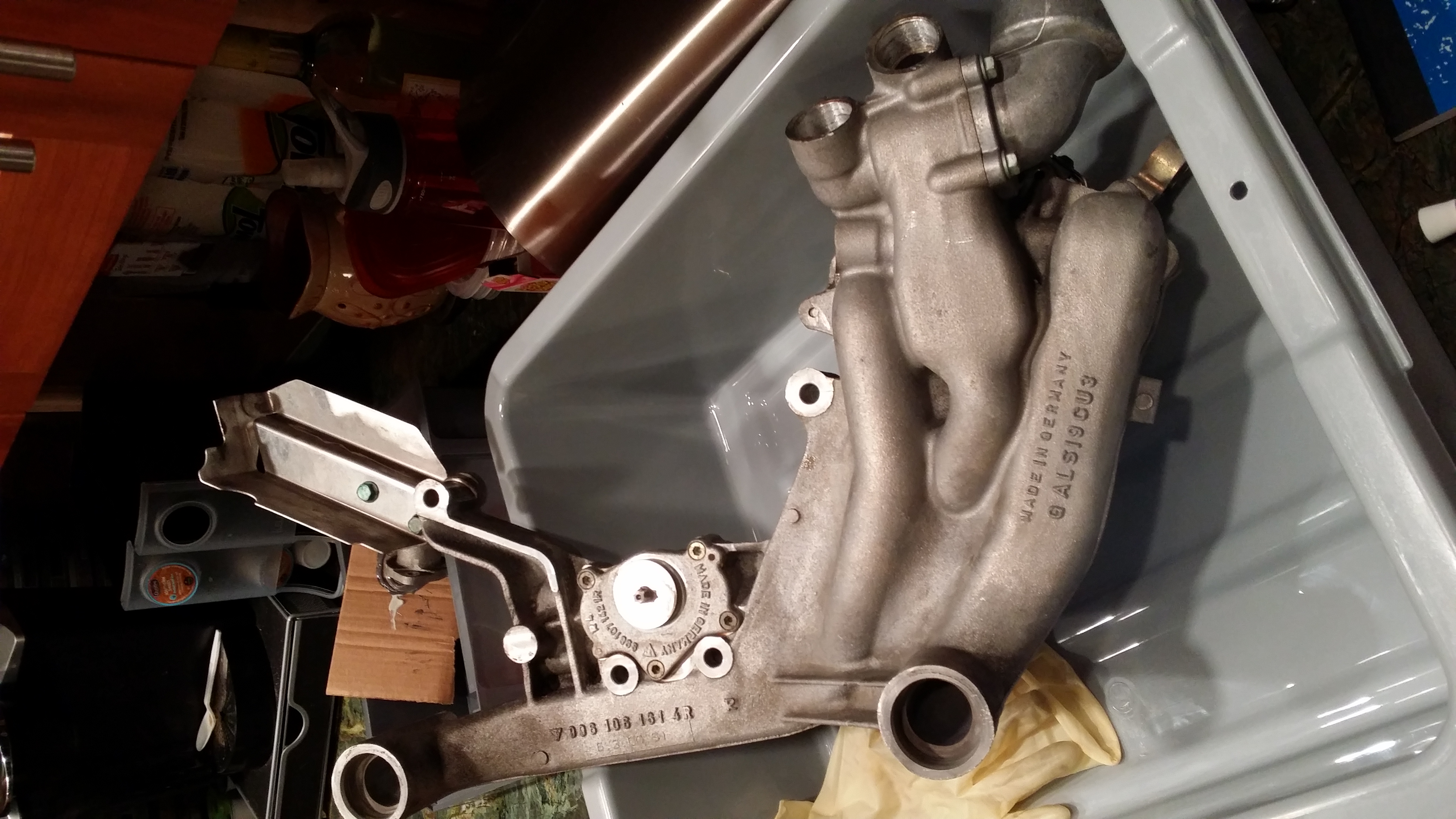

More pictures
ID:	334802   Click image for larger version
ID:	334803   Click image for larger version
ID:	334804   Click image for larger version

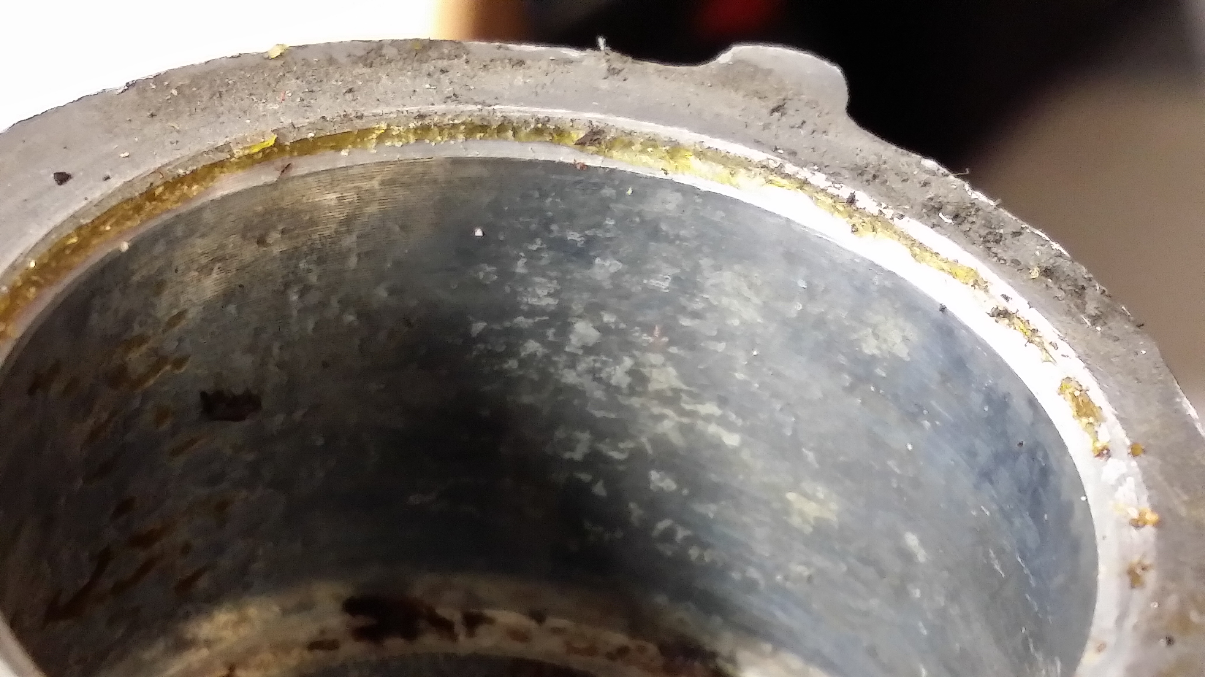

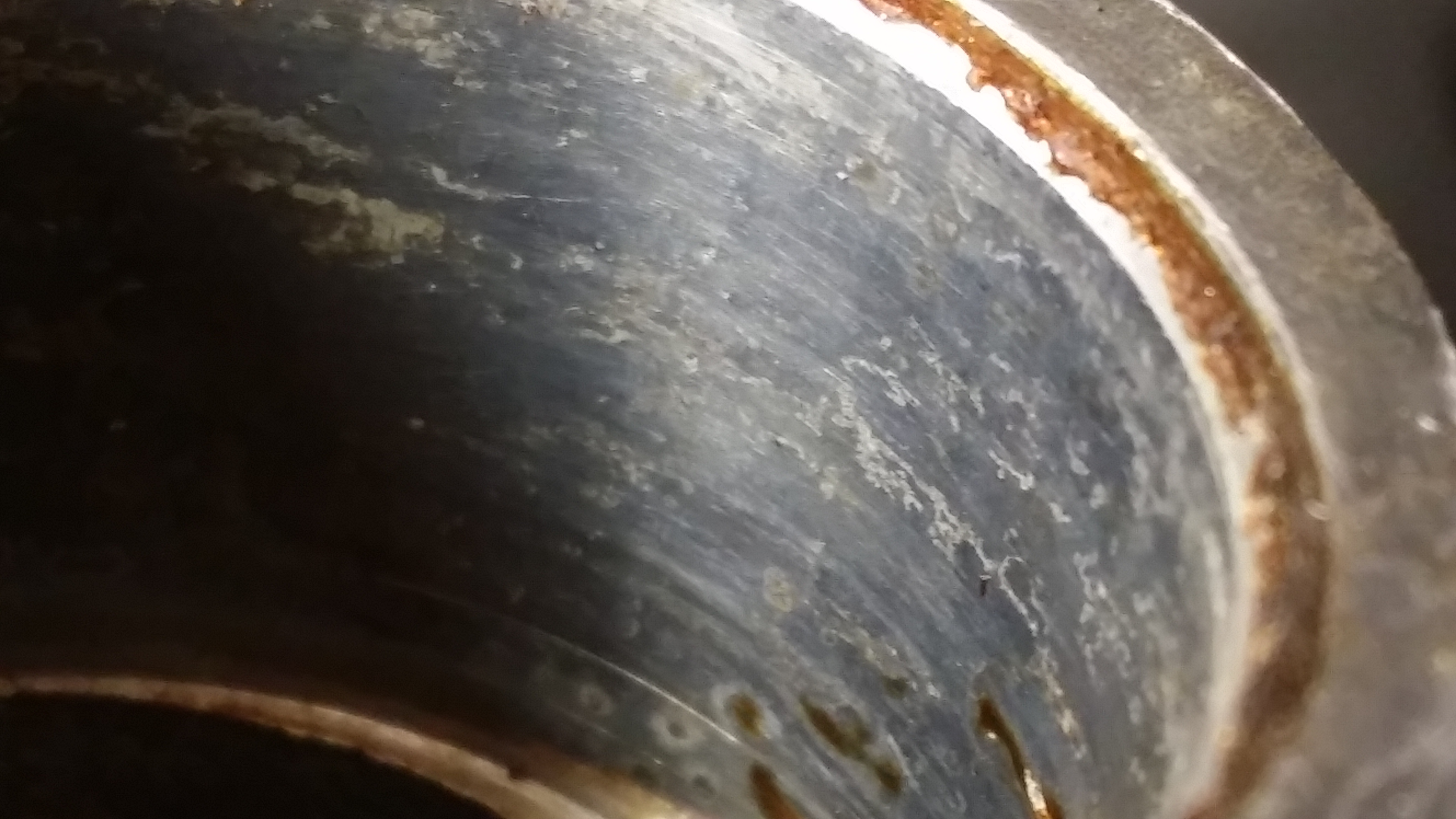

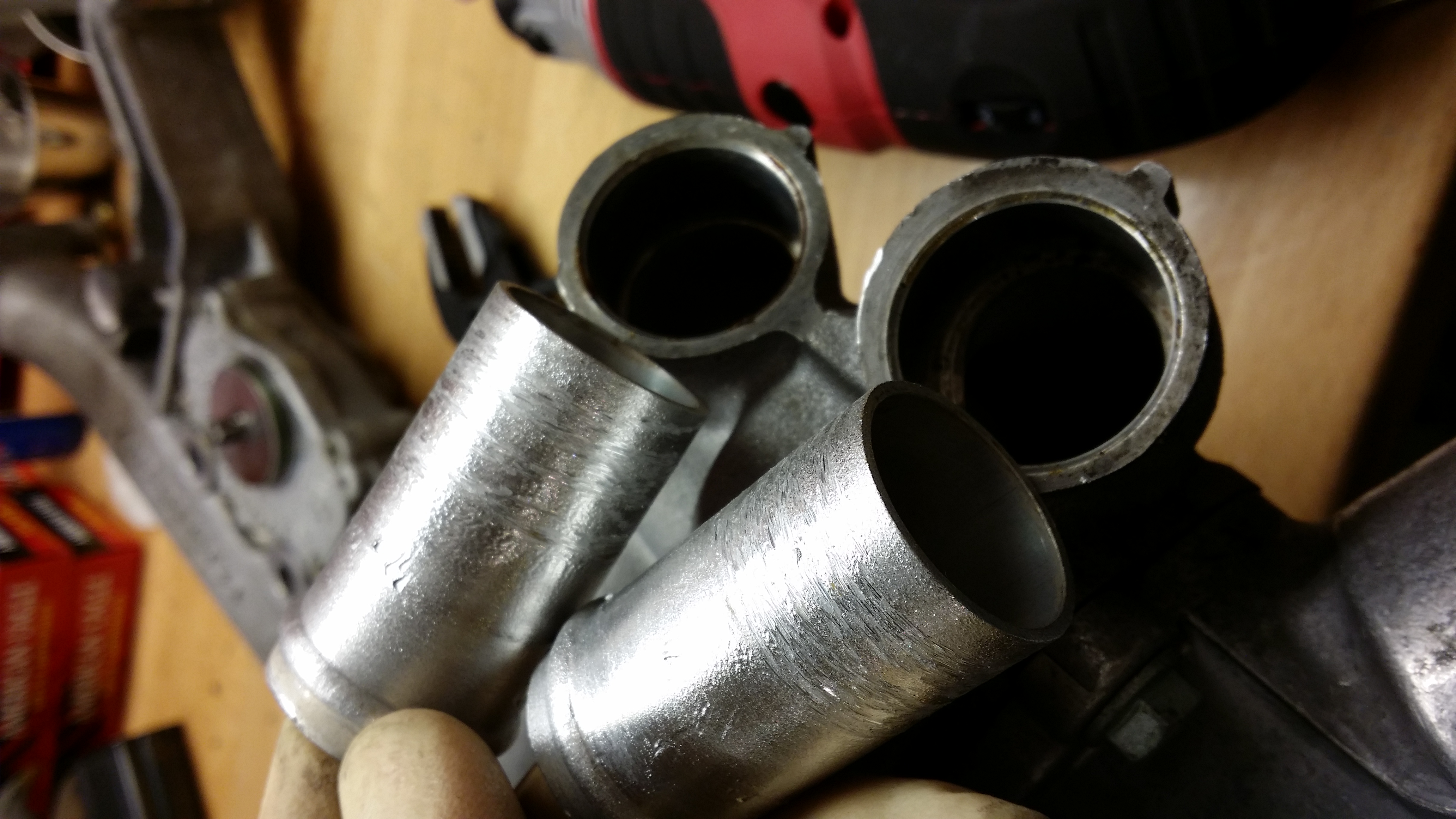

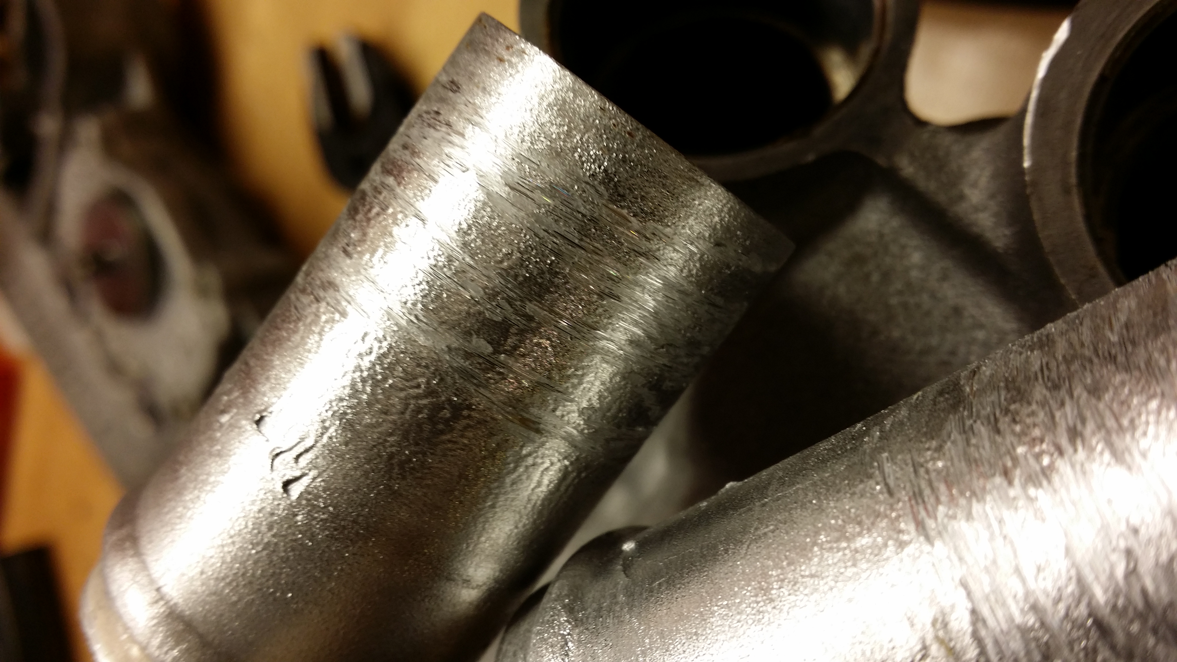

One of these came out with a twist the others needed heating with a propane torch. The insides were very smooth. Not good do bonding.
ID:	334806   Click image for larger version
ID:	334807   Click image for larger version
ID:	334808   Click image for larger version

hit all the fittings with a hot propane torch and they came right out. buffed them with a wire brush on a drill and welded them up.

The most common one is the one behind the alternator. Item in your 1st pic. Why? That 3/4 90 degree fitting bypasses the radiators and goes to the heater core, it sees high temps then the rest of the glued fitting

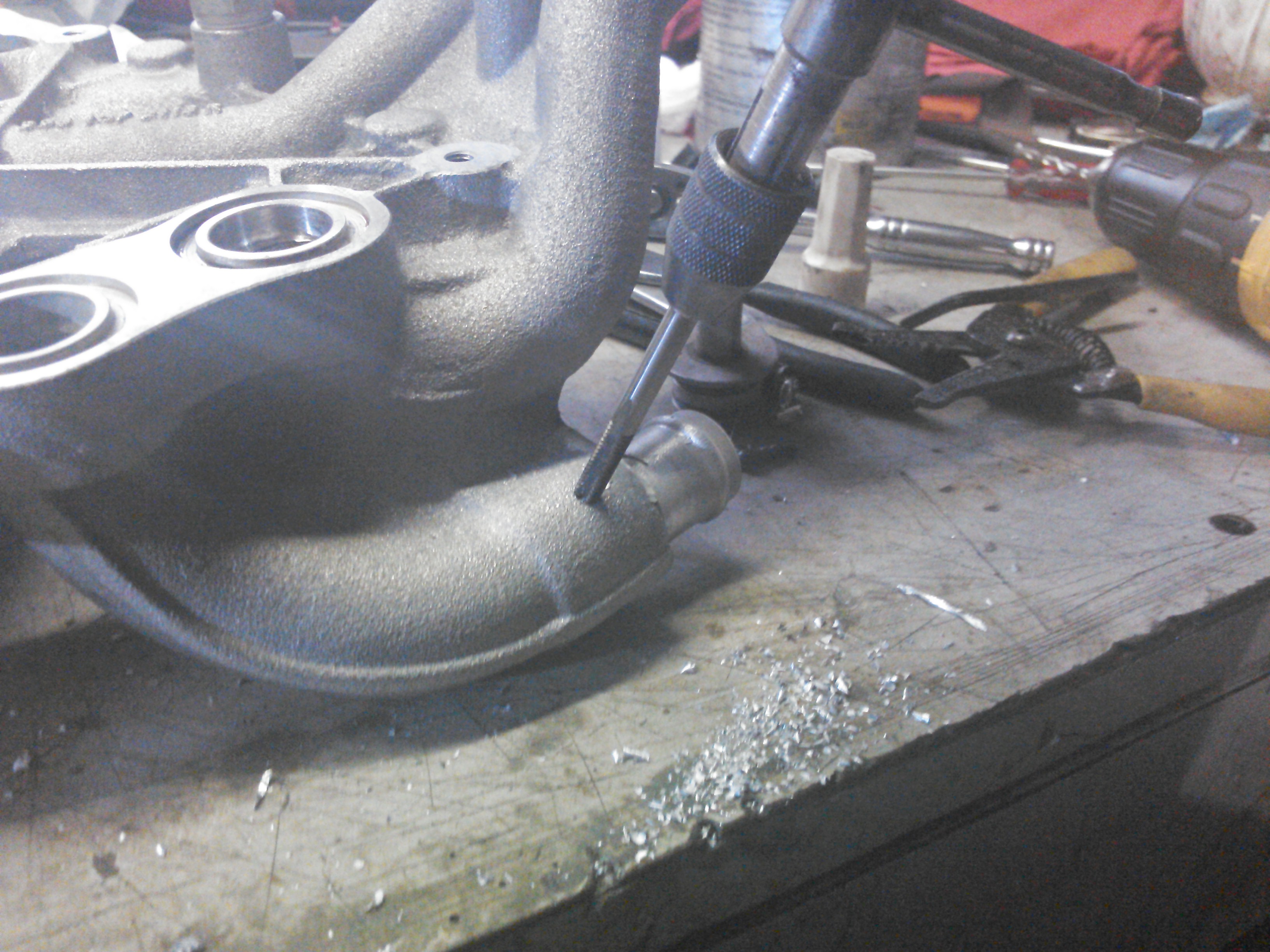

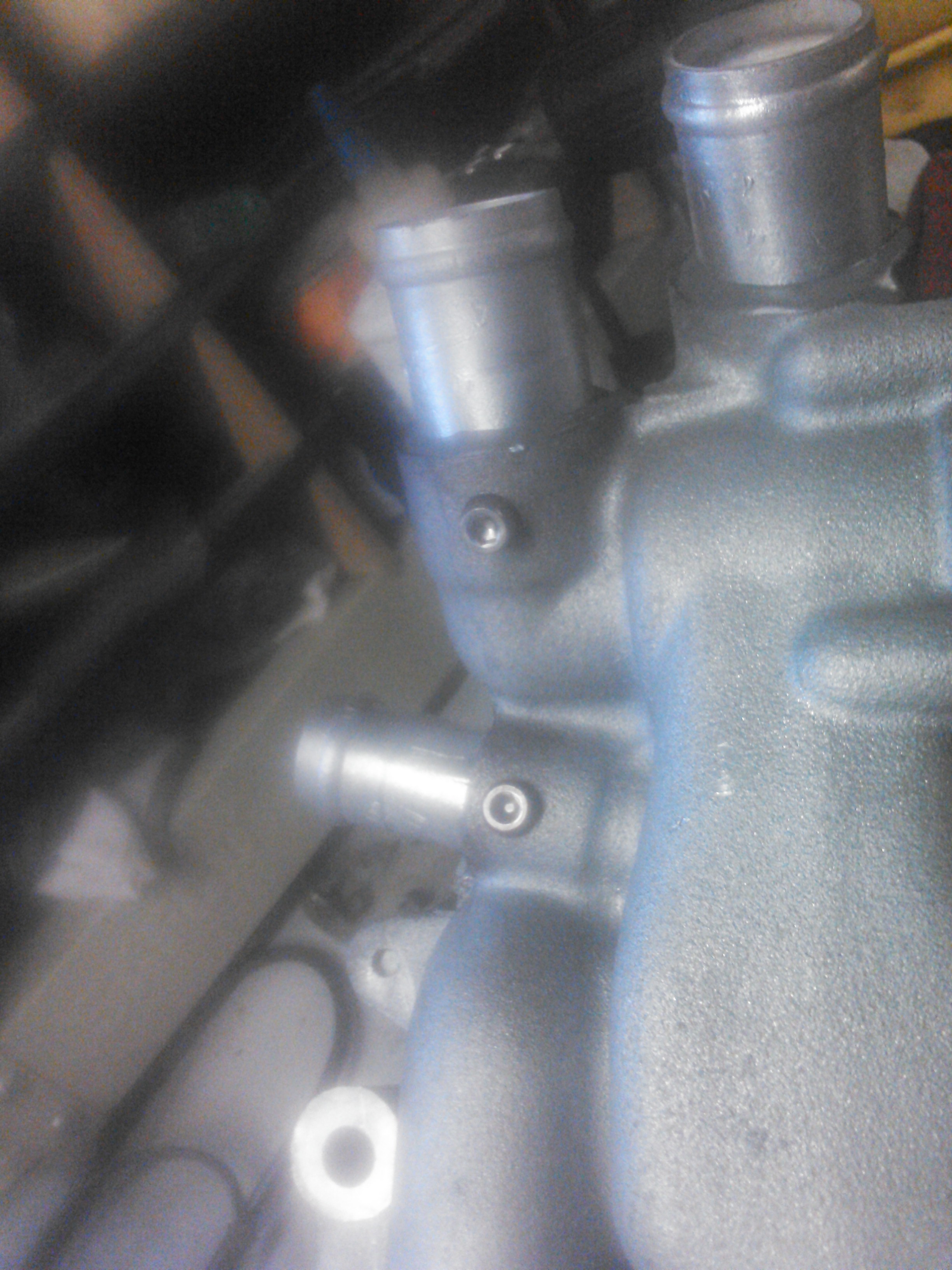

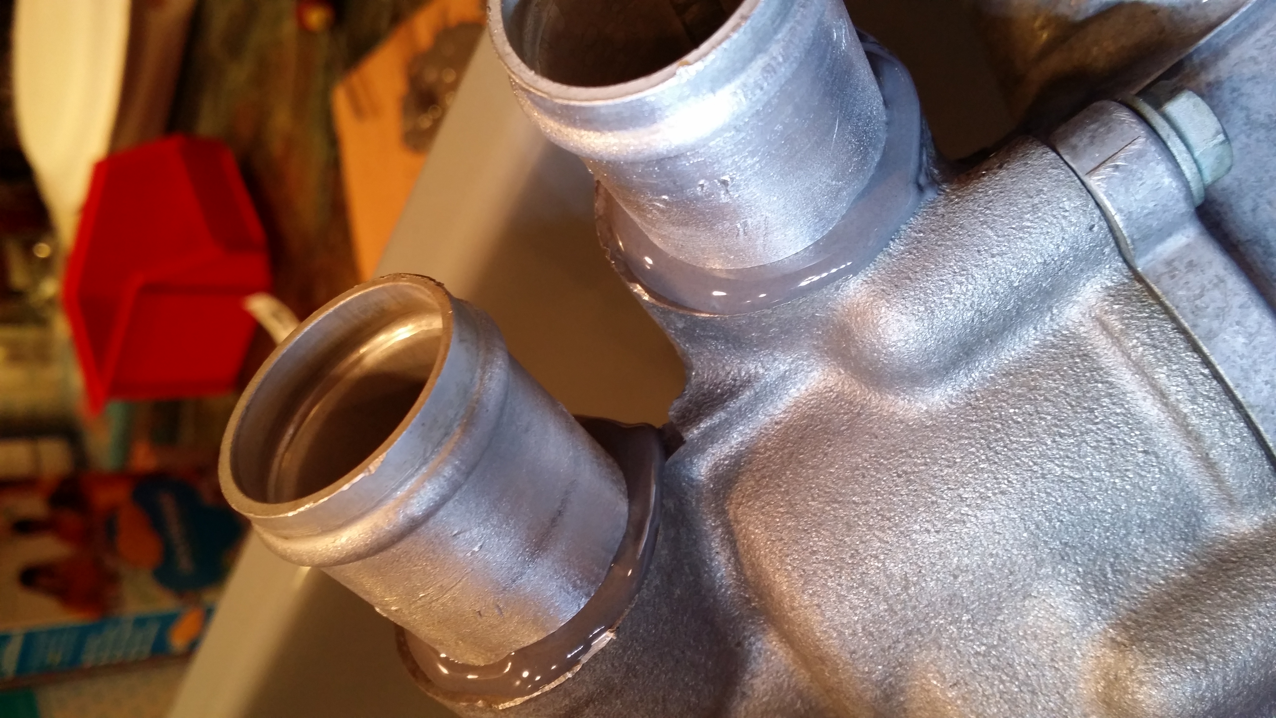

Pined and ready to go.
ID:	341218   Click image for larger version
ID:	341219   Click image for larger version
