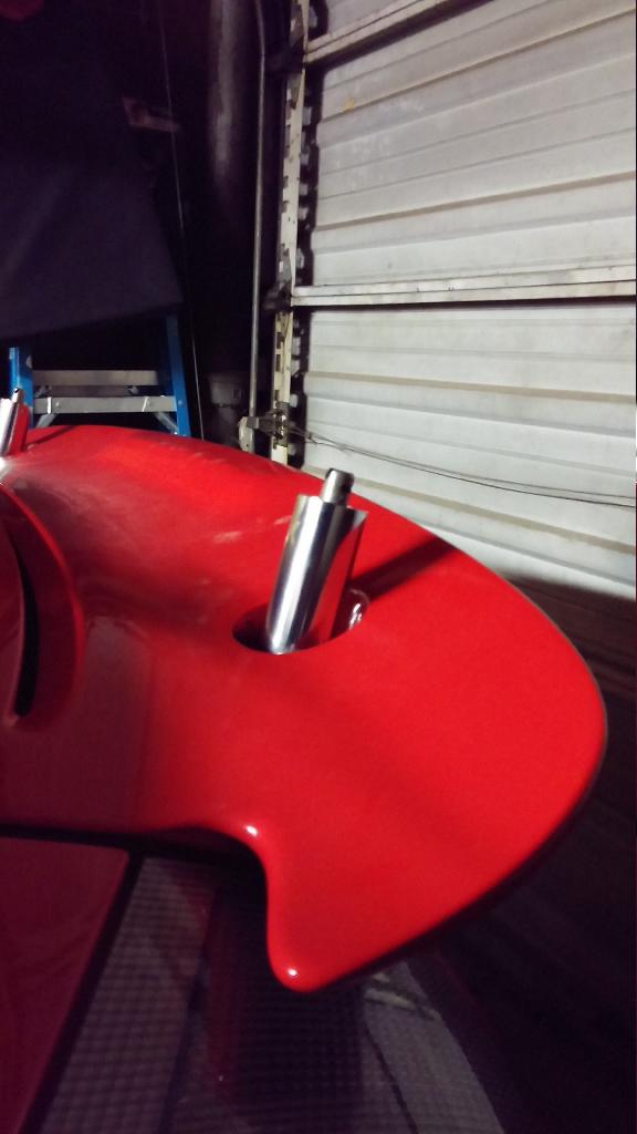

Try slightly bleeding the other side so the ram drops a few mm's until even with the other side.

So I was able to finish buttoning everything up last night, it is lower on the passenger side but only by a few mm. I'm guessing that's due to that side having a longer line and probably has more air, I will try bleeding the lines today. Heres a short video.

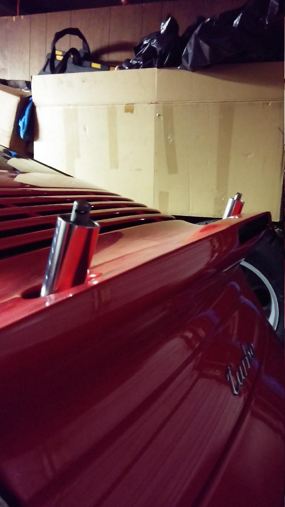

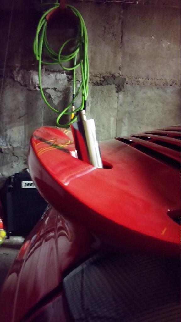

Success!! I bled both rams and got them to come up evenly at a height of 81mm. I found that taking off the spoiler made the process easier and put less stress on the system. Fingers crossed it stays trouble free for a long time.
