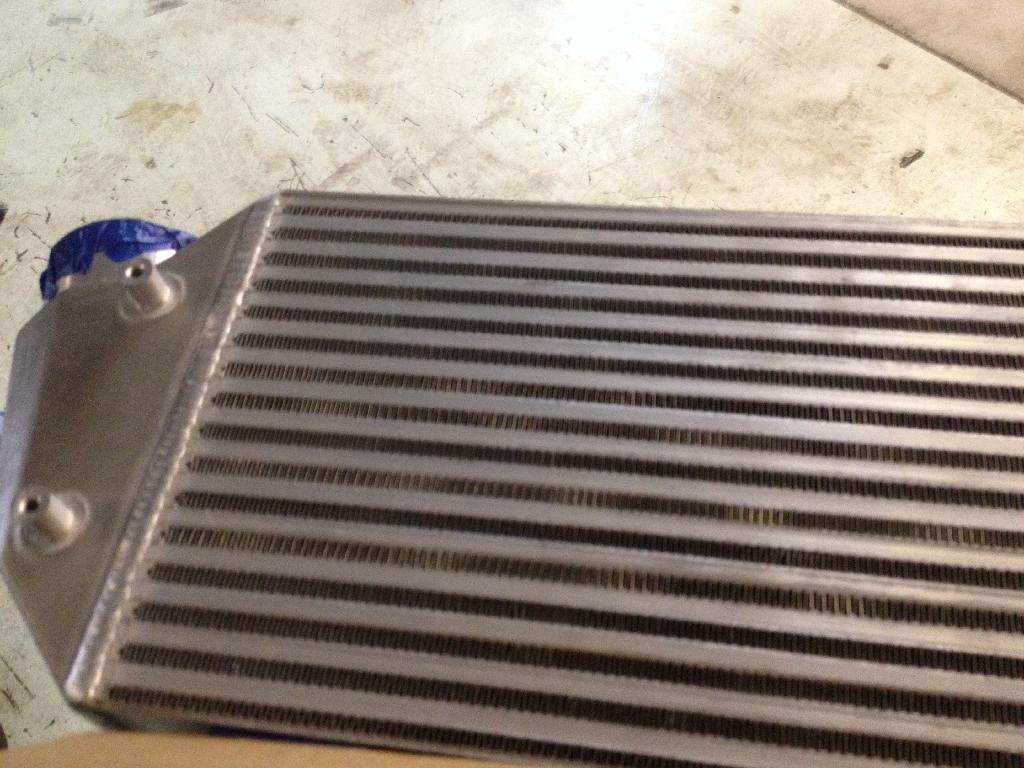

ETS units are nice and are considerably cheaper than many of the other aftermarket choices.

Markski, hard to argue with your experiences as well. I would recommend that anyone buying RS coolers go ahead and check the factory crimps and Araldite (or some other suitable epoxy) the end tanks before they go on the car. You don't want a tank blowing and distorting the tank mount area in the process. For a stock shortblock car, they're hard to beat after reinforcement given the price.
The ETS 16 row pictured is a nice option as well.
