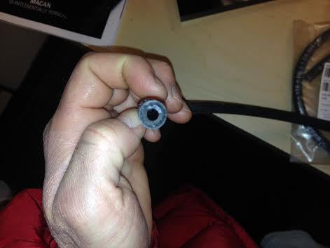

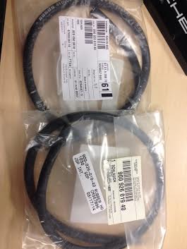

Picked up the OEM wastegate hoses from the dealer. They are the same as what is in on the car. Very good hoses. High temp rubber with a composite mesh core. Perfect fit.

Is that 900 926 019 40? for the 996 Turbo waste gate hoses? 2ea
Thanks in advance
Old Sep 2, 2019 | 07:42 PM
wab_jr's Avatar
5 Year Member
Joined: Jan 2019
Posts: 77
wab_jr has much to be proud ofwab_jr has much to be proud ofwab_jr has much to be proud ofwab_jr has much to be proud ofwab_jr has much to be proud ofwab_jr has much to be proud ofwab_jr has much to be proud ofwab_jr has much to be proud of
Thanks in advance
Yes. I just ordered mine:
