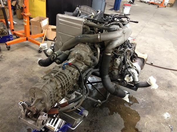

I just did my first engine/gearbox removal and reinstall. I was assisted by my trusted mechanic friend who pretty much walked me through it and was there to offer pointers and to answer any questions and take the helm when needed. It took me every bit of 3 days for the R/I taking my time with everything and making sure I don't screw up. We ended up unbolting the A/C and PS pump/reservoir and leaving it in the car thus only requiring the dumping of coolant. We also dropped the rear subframe / suspension from the car in the process. I must say it was an educational experience for sure. We ended up putting in a new Sachs Motorsport 764PP/GT3RS4.0 disc/964RS flywheel along with new injectors, wastegate hoses, subframe bushings, etc. Whats interesting is the fact that the RUF/Sachs Motorsport clutch and flywheel that was replaced was in almost new condition after 16K miles. Hardly any wear at all. I must say that even with the engine out getting the fuel rails out is a fairly tedious process. My hats off to the guys that have managed to do it with the engine in the car.

Good job pwdrhound!!!! The engine is not resting on an hydraulic table, how did you lower the engine onto this small stand?
maybe used a lift to raise the car off the table...
Car was on a lift. Just raised it off the motor/tranny

Originally Posted by 993GT
timely thread, dropping my driveline out when the snow finally melts
How did you suspend the AC and P/S pumps in the engine bay?-everyone has a unique solution....will also be lowering the engine/trans onto a rolling table with the hoist method
Good tip on the starter Tim
Both the A/C and PS pump/reservoir were unbolted from the engine and left in the car resting on a tower placed on the top of the bumper. Then the car was raised off the engine/tranny. The only thing that had to be dumped was the coolant.
