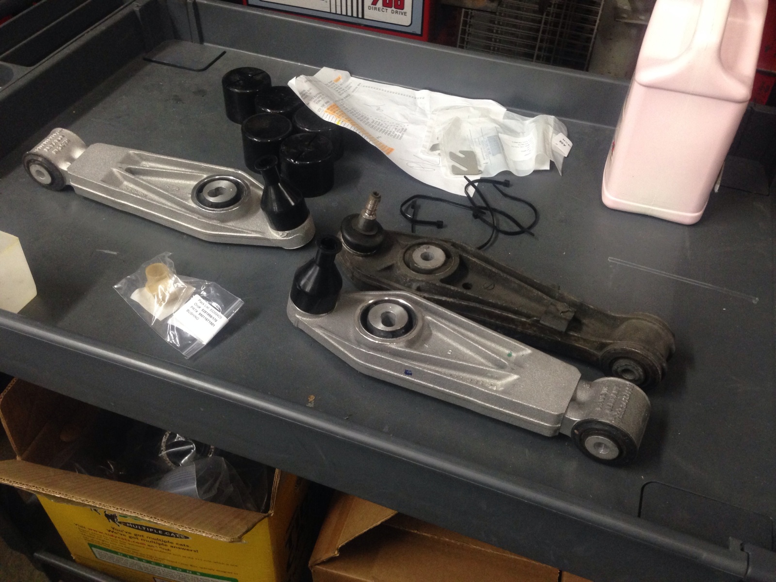

If you end up lowering your 996TT with coilovers, you won't have enough adjustment on the control arms and toe bars to properly align the car. You will have to spend another $1500 on GT3 2 peace arms and adjustable toe bars... Otherwise you will end up with an aggressive negative camber that will consume your tires every few K miles.

You got lucky if you could align everything. My car with the KW V3 just simply ran out of adjustment and was left with too much negative camber. With the shorter gt3 control arms it was easy to make the car perfect.

The amount of misinformation that permeates these forums is vast. Depending on the amount of lowering, generally the only item you need are rear adjustable toe arms to adjust toe back to spec. You certainly don't need GT3 arms for a daily driver but they are a must if you are trying to get increased camber for a more track oriented alignment.

I agree that there is a lot of misinformation here... However, the GT3 arms or aftermarket arms are needed with the coilovers because they are shorter than the factory turbo arms and they allow more camber adjustments.

Have you actually had both the split GT3 and stock TT arms in your hands and measured both? You do realize that the stock 996GT3 arms without shims are the same length as the stock TT one piece arm? To be perfectly accurate, at a minimum, you need to run the GT3 arms with a 1mm shim on the right side of the car and a 1mm Xenon leveling bracket shim on the drivers side. The shims on a GT3 LCA will allow you to lengthen the arm thus increasing camber, not the other way around. Adding 7mm of shims to each GT3 arm has the effect of increasing camber about 0.6-0.8º per side.

Sure, you can also be more creative by machining 2mm down from it, since it is a 2pc design.

Yep that's them. As you can see they are both the same length. Now please explain again how the GT3 arms will get you LESS camber...
Like I said, there is a lot of misinformation out there. Caveat emptor..
