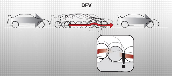

Vantaredoc, being at 80K+ you're stock shocks will already be worn. Running just the springs will only exacerbate any wear. I'd say at this point looking into a full coil over setup is worthwhile.
Soon it'll be time for me to bite the bullet and do the same. Check out the Ohlin's Road & Track coils, their DFV tech seems pretty trick.
So what is DFV? It is Dual Flow Valve technology – and it sets us apart from our competitors. Only Öhlins has DFV technology on its road and track products
With DFV, the dual flow valve gives the same characteristics on rebound as it does on compression, thanks the damper fluid having a consistent path of flow in both directions. This means that the wheel and tire can quickly and effectively resume their important position back on the ground, providing grip and traction. The new Öhlins R&T range uses DFV technology on every single fitment, making it the perfect upgrade for the enthusiast that needs comfort and agility in the one unit.
Because DFV opens more quickly and easily on minor road imperfections, ride comfort is surprisingly supple and more akin to an OEM strut than a coilover set-up. Over undulating surfaces, the compliancy of the R&T units allows the car to crest bumps and pot-holes, while still keep stable and in control. Traction is always maintained at its optimum level. When comparing suspension, why settle for second best?
When adjusting ride height on coilover units, it’s worth comparing how it’s done. On many inferior designs, height is adjusted by raising or lowering the lower spring platform. This has the effect of compressing or extending the spring, which can limit the suspension travel that may cause topping out. The Öhlins method is to leave the spring seat in its perfect position, while the lower flange spins easily on the threaded body, to allow you to adjust with absolute precision while maintaining the perfect characteristics that we took so long to design in! Once you’ve set it all up, the adjuster simply locks off to maintain your exact settings.
Dampers will get hot. That’s one thing that you can be sure of. As the piston moves within the damper, it generates friction – and therefore, heat. Although we can’t stop heat, we can deal with it, and this is yet another way that Öhlins differs from the competition. As the heat increases, the viscosity of the damper fluid can change, altering the car’s handling characteristics. Our unique needle bleed valve expands with temperature, closing the gap that the fluid travels through, maintaining a consistent damping rate. The best thing of all? You won’t even notice! All you’ll feel is that the car responds consistently, lap after lap, turn after turn; allowing you to concentrate on braking points and apexes while the Öhlins technology takes care of the damping
These kits all work well ‘out of the box’, but there’s still plenty of adjustment for you to set things your way. You like stiff and reactive? Or soft and forgiving? It’s all there. Too much low speed rebound damping can have an adverse effect on grip, so the easily accessible adjuster at the base of the Öhlins units allows small, but positive increments of fine tuning, so you can take into account every single parameter. Sounds complicated? Nothing could be further for the truth. Just a few clicks either way from our factory settings will soon have your car responding precisely to your inputs and driving style.
The Road & Track McPherson struts also feature camber adjustable upper and lower mounts to give you the possibility to fine tune your wheels for the right occasion – whether you want to go for a ride in your neighborhood or take your car for a spin at the track on a weekend.
