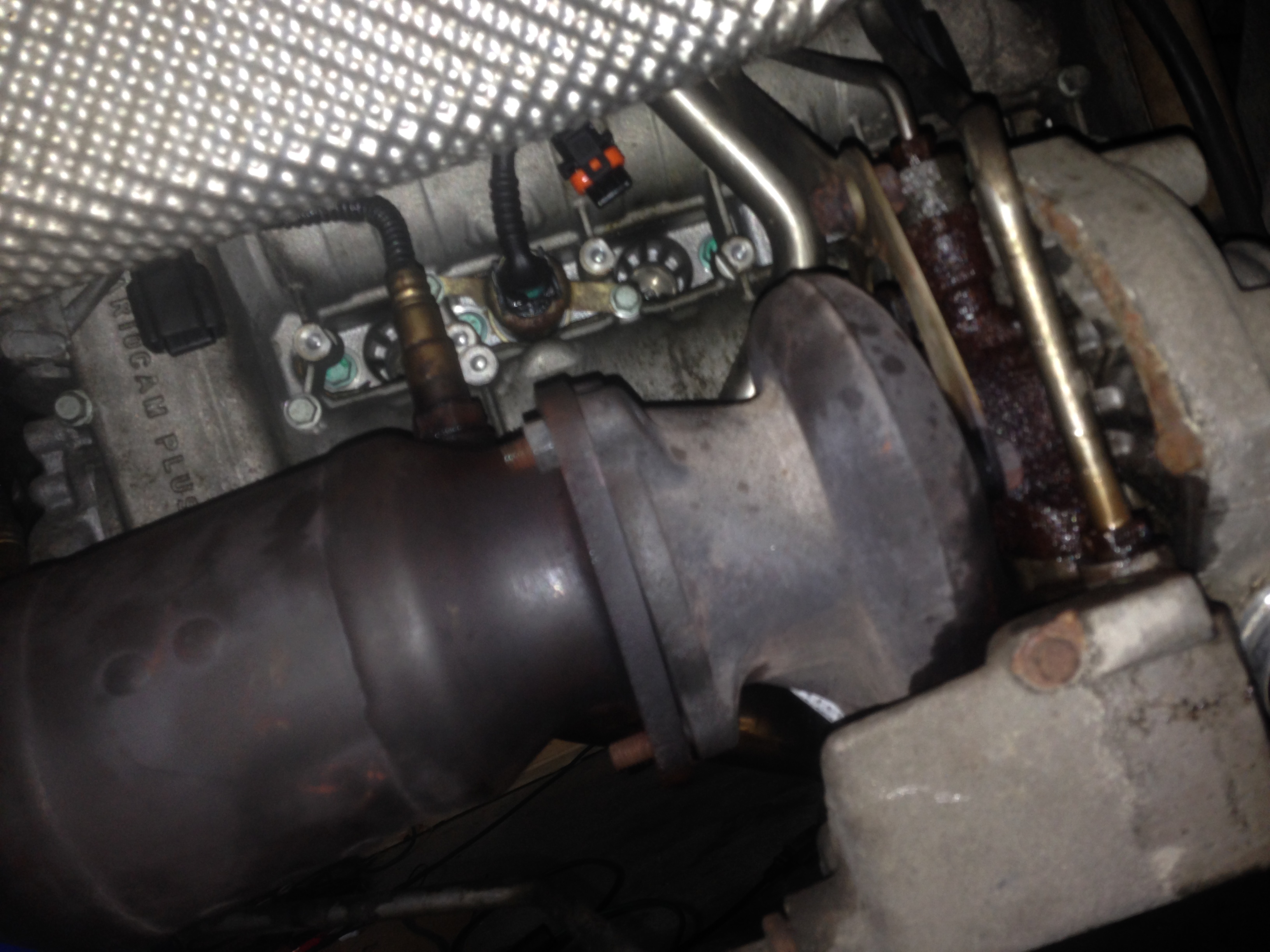

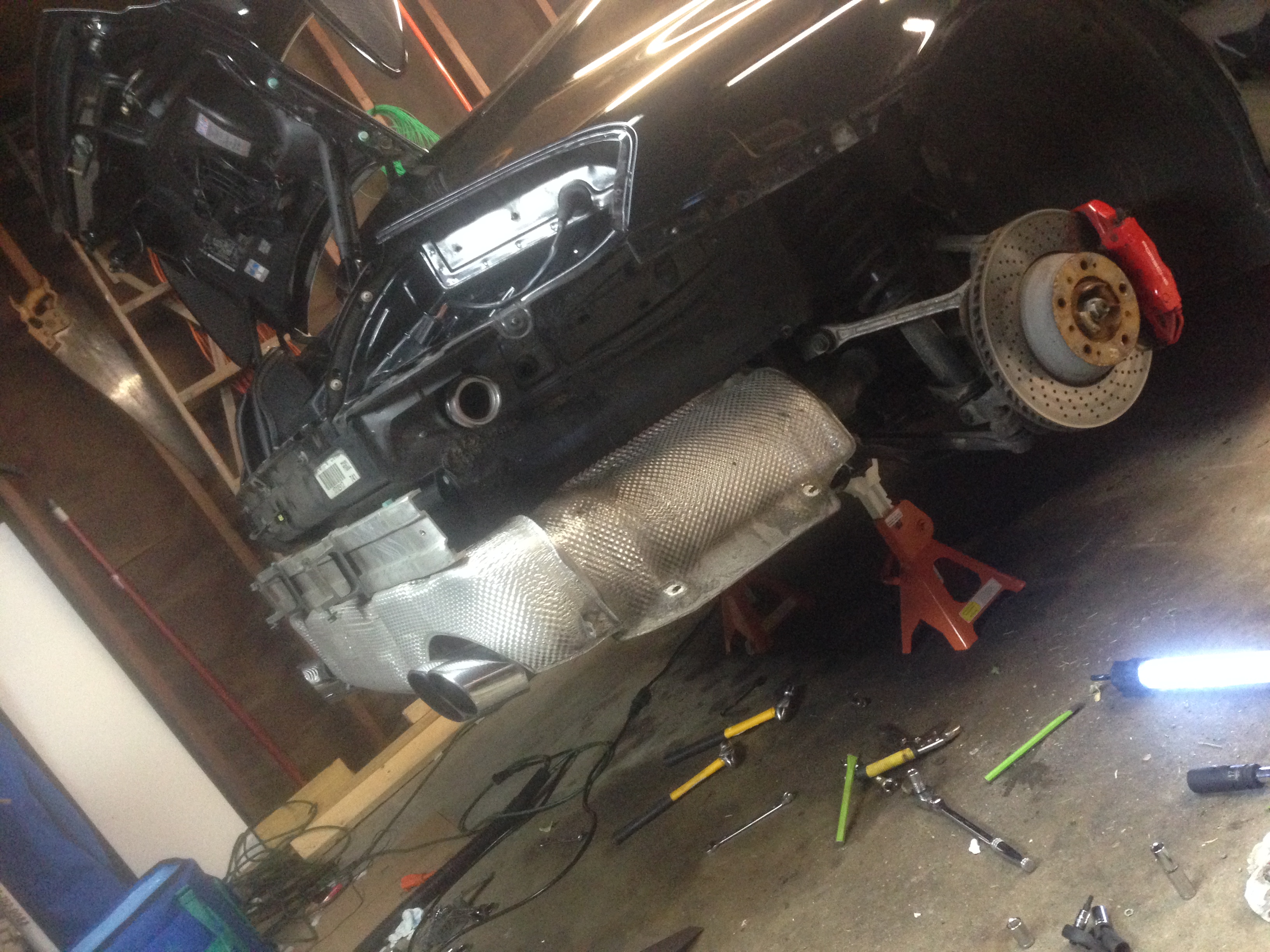

the 996 coils were replaced by the 997 coils...so if you buy "996" coils, you are actually getting 997 coils.
Why? I don't know. Better performance and less prone to cracking I suppose? They are a straight swap. Do the plugs while you are at it. If you remove the intercoolers they take 5 mins to do.
Your first time may take a minute, but after you know where everything goes it's not that bad.
EDIT ; uploaded pics. When you pull the rear bumper and intercoolers, you can lift the head shield and see they are VERY easy to access. I believe you can get to them without removing intercoolers but just makes things a bit tigter. up to you.
