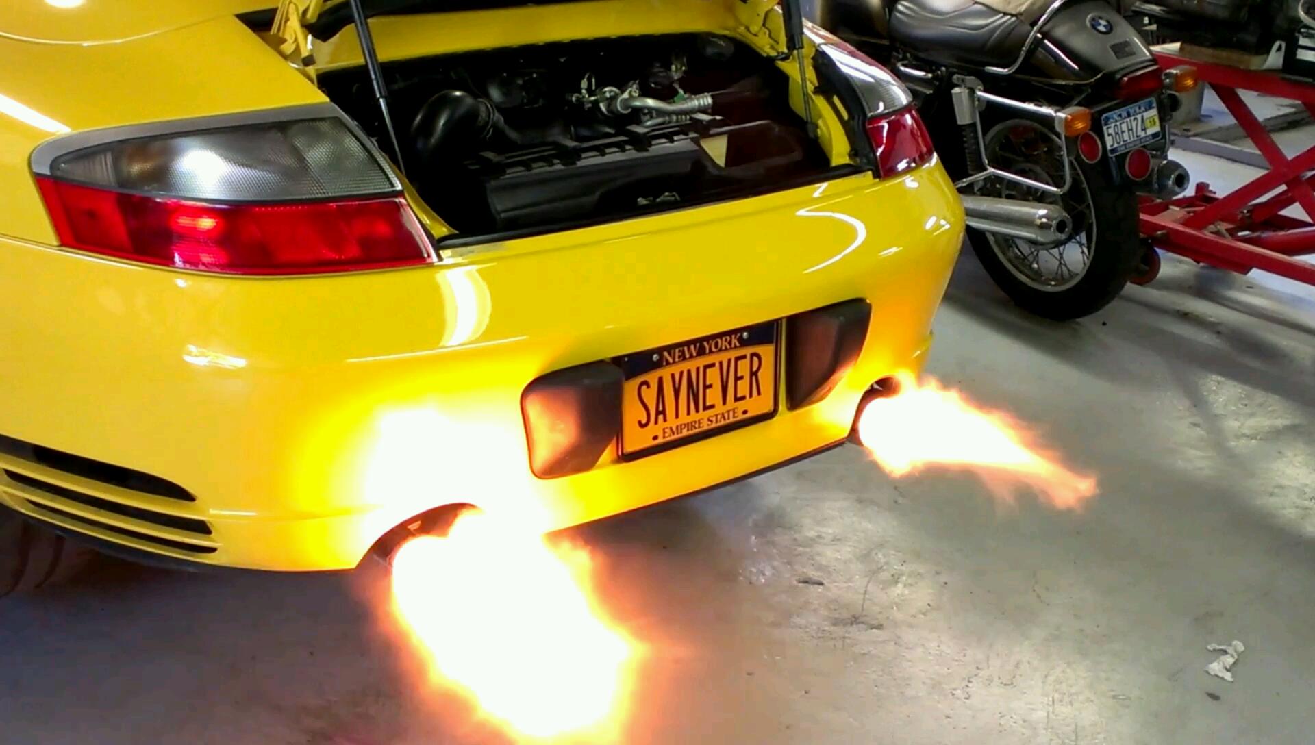

Full details coming soon. In the meantime, I'll just leave this here.
-V

My goal was to keep the car as driveable and reliable as it came from Stuttgart, while adding significant responsiveness and performance.
The coolant fitting failure late last year kinda screwed up my plans to do this piecemeal, instead turning it into one big "while you're in there" scenario.
Here are the details I can remember off the top of my head:
  • Weld all coolant fittings
  • Replaced factory K16 turbos with K24/18g billets with...
  • AMS 1bar wastegates
  • EVOMS intake piping
  • Upgraded fuel pump
  • Upgraded injectors
  • GT2RS Intercoolers
  • GT2 clutch conversion (native, not using an adapter)
  • ERP dual-plate carbon clutch with steel FW
  • Clutch pedal helper spring mod (Details | Home Depot Part Number 684838)
  • B&M Short Shift Kit
  • Bosch 710DVs
  • 997 Coils
  • Bosch F5DP0R plugs
  • RPi 3" catless exhaust
  • Tim's 8mm BB shift-firmer-upper mod
  • Custom tune by Tim941NYC #HBK
  • ...and Michelin Pilot Super Sport 245/35 and 305/30R19 to put it all to the ground.
Other style mods include:
  • Aero style front spoiler
  • Strosek rear spoiler
  • Rennline mesh grill inserts
  • TechArt style side intake splitters
These are in hand, but will all get put on once I've had the car back a while and confirm everything is stable.
Also have the SmartTop and RemoteTop roof control upgrades, love 'em!
I'll get a bunch of pics up here before long. Yeah, yeah, and re-do my signature.
-V

didnt make it to the PCA concours? Was looking for another SY turbo.
nice flames, on stock airbox also
