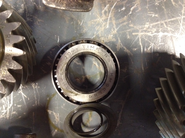

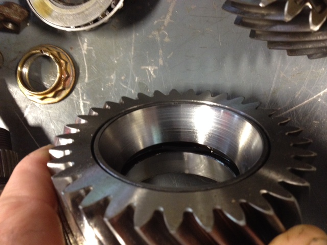

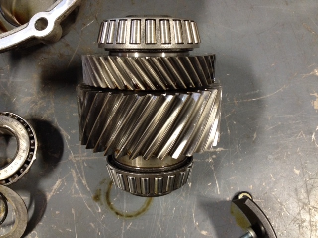

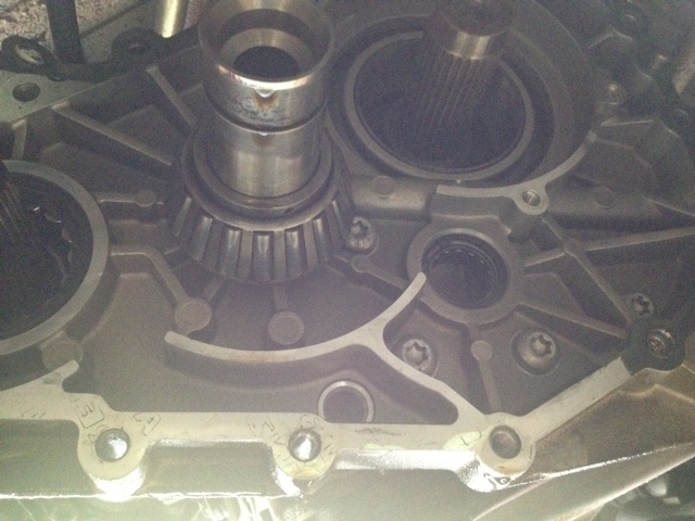

Pics of Front Gear Box and Bearings
here are pics of bearings and gearbox of my tiptronic transmission - any help is greatly appreciated- we are searching for replacement parts

Here is what the Transmission shop indicates:
The images show the radial scoring which would not cause noise. But if you look closely you will see pitting which will generate noise.
Aside from locating the bearings, my other concern is that tapered roller bearings normally need preload in this application. Without repair information I have no way of knowing if it is necessary and if it is, what the pre-load should be and if shims or spacers are available to adjust it.
And to clarify, we are working on the front of the trans or transfer section of the trans.

It's been awhile since I searched but I think I found those timken bearings on amazon even with simple part number search. Seems like they were $40-$50

I know thats a MB trans. Here is what a quick search turned up
http://www.partsgeek.com/pwcqtf4-mer...ential+Bearing
