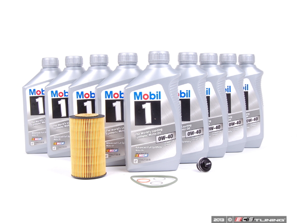

ECS Tuning - Porsche's Avatar
Joined: Mar 2012
Posts: 9,607
From: Wadsworth, OH
We offer a kit for next time that includes:
  • Mahle oil filter element with rubber sealing ring
  • Drain plug crush washers for the crankcase, oil tank, and both turbochargers
  • 9 quarts of Mobil 1 0W-40 fully synthetic motor oil
  • ECS magnetic drain plug
For more information Click Here.

I used ECS kit with OEM filter made it even easier= no shopping around.
