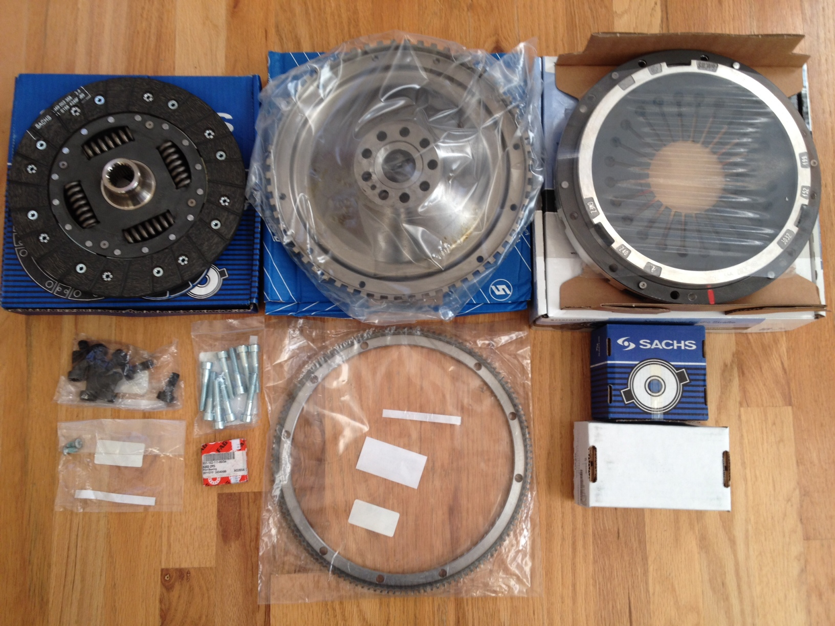

Originally Posted by '02996ttx50
Wrong kit again. The Vivid kit has the medium strength PP along with the solid disc. Would not waste your money on this. It's only marginally better than stock.
This is what is in the 764PP/964RSLWFW/997GT3RS4.0 kit. Make sure you are getting the 997 part number 4.0 disc and not the old style GT3RS disc with the blue springs. There are probably a few of those sitting on shelves. Those are noisy.
This is what is in the 764PP/964RSLWFW/997GT3RS4.0 kit:
i hear you..but. some folks only NEED "marginally" better than stock!
parts below commonly incl in the 2.5 "kit". its sachs after all! the oem mfg'r
This kit contains:
-Sachs Performance Pressure Plate (764)
-Sachs Performance Clutch Disc (098)
-OEM Release Bearing
-Flywheel Bolts (9)
-Pressure Bolts (9)
This kit contains:
-Flywheel Bolts (9)
-Pressure Bolts (9)
I think he was asking where to purchase the 4.0 kit. That's what I was getting at. Those are not the 4.0 kits. Why replace the stock clutch with something "marginally" better when you can get a "lot" better with the exact same drivability and no downsides? I think the OP had a LWFW on his wish list too if I read it correctly..

Originally Posted by Mish_Mish
There is no way to tell without knowing the part numbers of the individual parts. That's what I'm getting at. That does "look" like the stock TT disc however...
