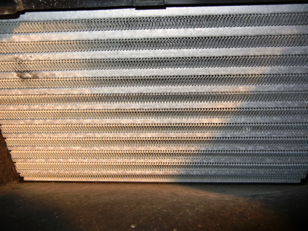

I plan on doing 997.2 intercoolers at some point...
Here's stock 996GT2 intercooler cores, note the extended 'finning' :
Cheers,

I’m sorry, I meant in terms of cooling (or flow) efficiency.
I don’t intend to do much power wise to my current 996 than a simple tune, clocked waste gates and possibly the GT2 intercoolers. The 997.2 intercooler, as good as they may be, wouldn’t make sense for me. I’m looking for “only” around 500hp and minimal lag.
How long do you plan to sustain that 500hp? If you're looking for the 5-10 second sugar high, then stock coolers will be fine. Beyond that and depending on climate, things start getting hot and the DME will pull the power back. If you want to keep that 500hp for an extended amount of time, neither the 996 or 996 gt2 cooler is going to cut it. There is a reason Porsche didn't run more boost form the factory. I've seen plenty of flashed but otherwise stock cars become slower than stock after a few laps on a road course.
To answer your question:
In terms of flow, the 996 and 996 gt2 are the same.
In terms of cooling efficiency, slight advantage to the 996 gt2 but it's really minimal -we're talking a degree or two under loading.

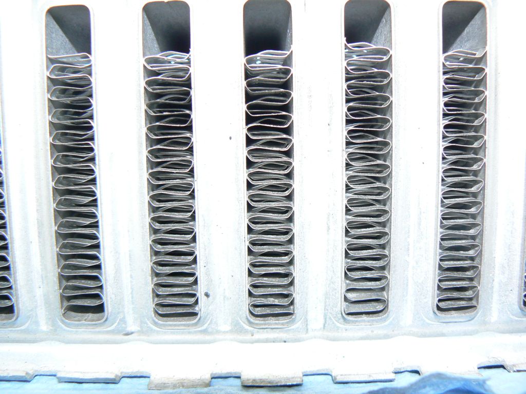

Originally Posted by 993GT
earl3, curious why you say 996TT/GT2 intercoolers are insufficient at 500chp?...factory 2004+ GT2's and 997.1TT(IIRC use same core) both run 1-1.1bar 480hp factory on them without issue...cores appear to be good quality.
My logs(street pulls) show very quick recovery times and about only 20C variance from ambient on a HOT day. I will try to log on track at somepoint to get a 'bigger' picture...
Will compare to 997.2TT intercoolers when I upgrade, maybe next 'season'.
Cheers,
Rob
Hi Rob,
I imagine you'll see the issue with your track logs. They're ok for street pulls, its usually when you get into 5th where things get ugly quickly. You'll still see some benefits on the street with a upgrade as well.
The cores do appear to be decent quality from the outside, and they do recovery pretty quickly, the problem is the open channels that allow the flow to go through the core without ever touching a fin:
