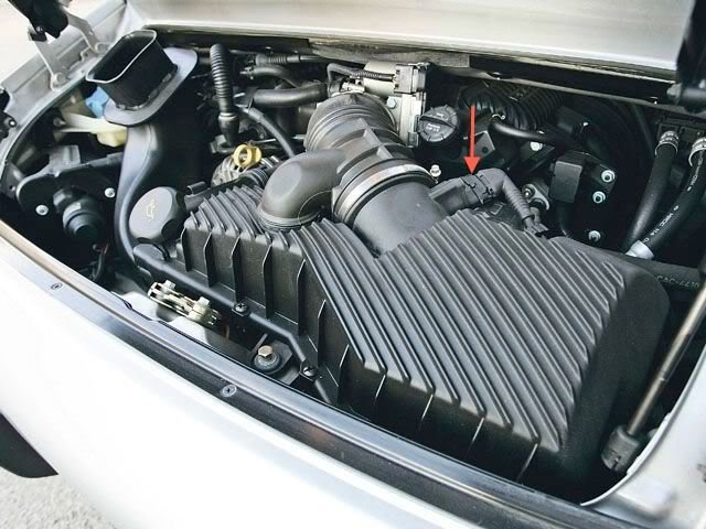

Your MAF sensor will be on the tube leaving your air box and heading into the intake - not my photo but this is the general idea - MAF sensor is at red arrow:
You will need a Torx Anti Tamper T20 driver to remove the two screws holding it to the intake tube, remove the wiring clip before removing the sensor - pinch the side tab and pull off. Then unscrew and remove the MAF sensor. DO NOT TOUCH the wires on the sensor, on the side or where the yellow circle is:
Use this spray cleaner to clean the sensor, and then clean it some more. Clean the whole sensor but specifically the wire on the side and the wires inside the yellow circle.
Let it dry completely - I let it dry for 30 minutes. Then re-install.
I hope that helps your issue too.

DO NOT spray cleaner into and onto the MAF directly.
Spray the cleaner into a ziplock bag. Drop the maf in and shake it around.
edit: shake it around, but be gentle with it. you aren't mixing a martini.

Hmm, not sure why you wouldn't spray the MAF cleaner directly onto the sensor. The directions on the can say to spray direct, the Renntech DIY on this says to spray direct - every MAF sensor I have cleaned on my VWs, Audi, and even my Challenger I have sprayed direct without any harm.
Maybe I've been doing it wrong but I've never had an issue spraying direct.

If you're not supposed to touch the wires, I don't think it makes sense to spray a stream of liquid at it either. Some of those cans spray with quite a bit of pressure.
