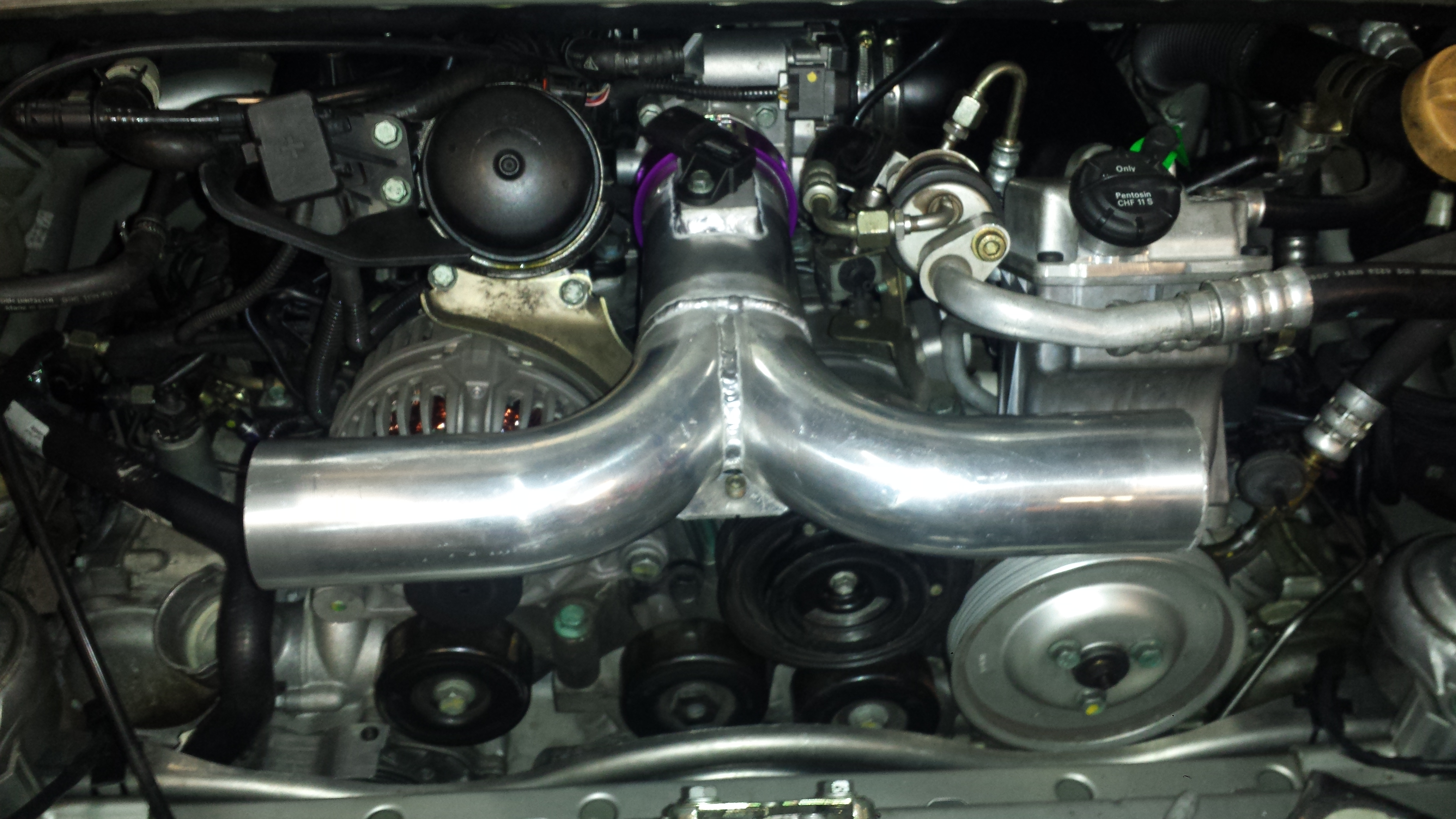

Tim,
Lovin that Y-pipe with the BOV on the top there!!! That's on my list of things to fab up this year!!! Care to share the specs of it? 3" into 3.5" or 4"? Have you fab'd up your turbo intakes yet?

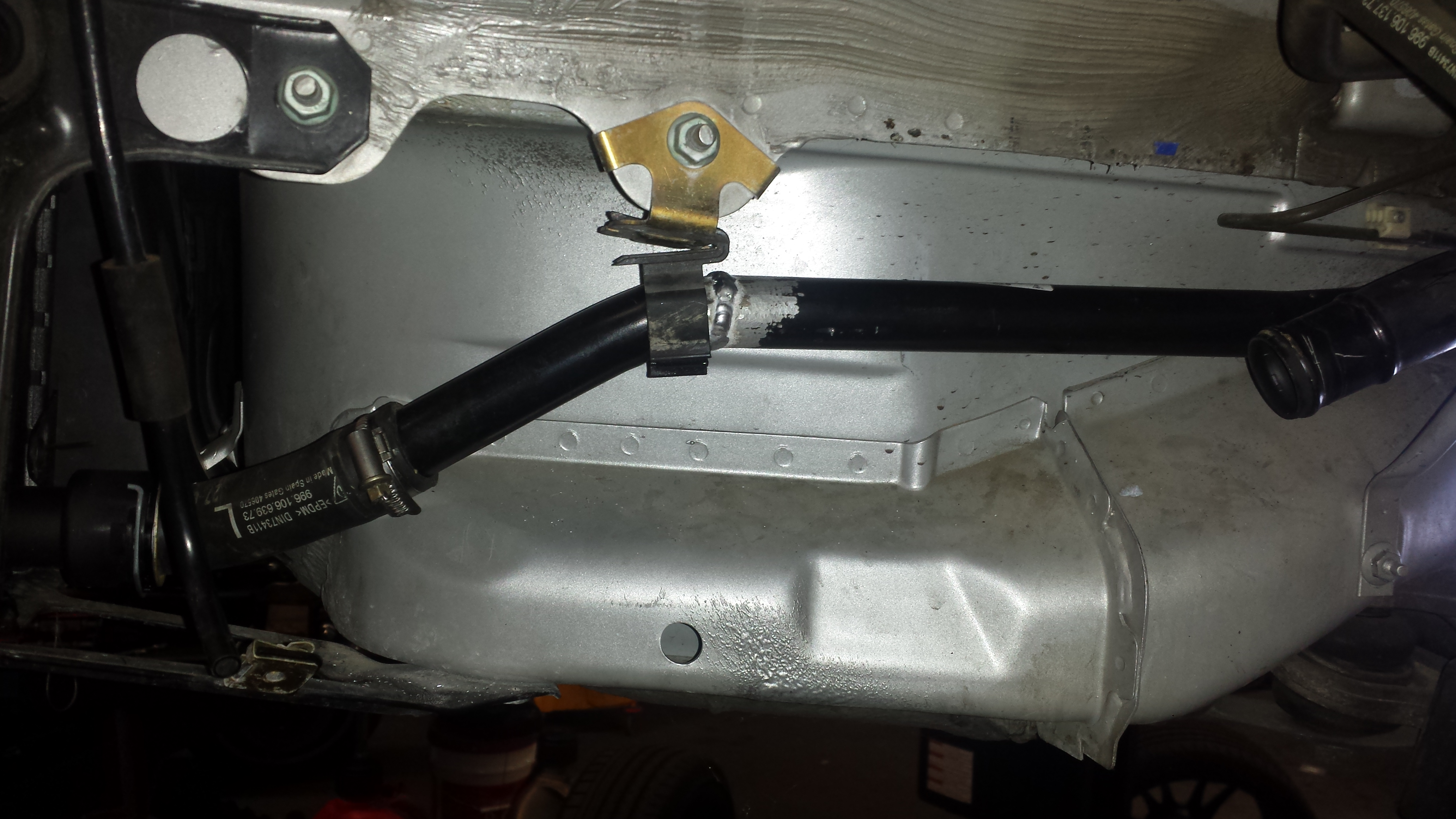

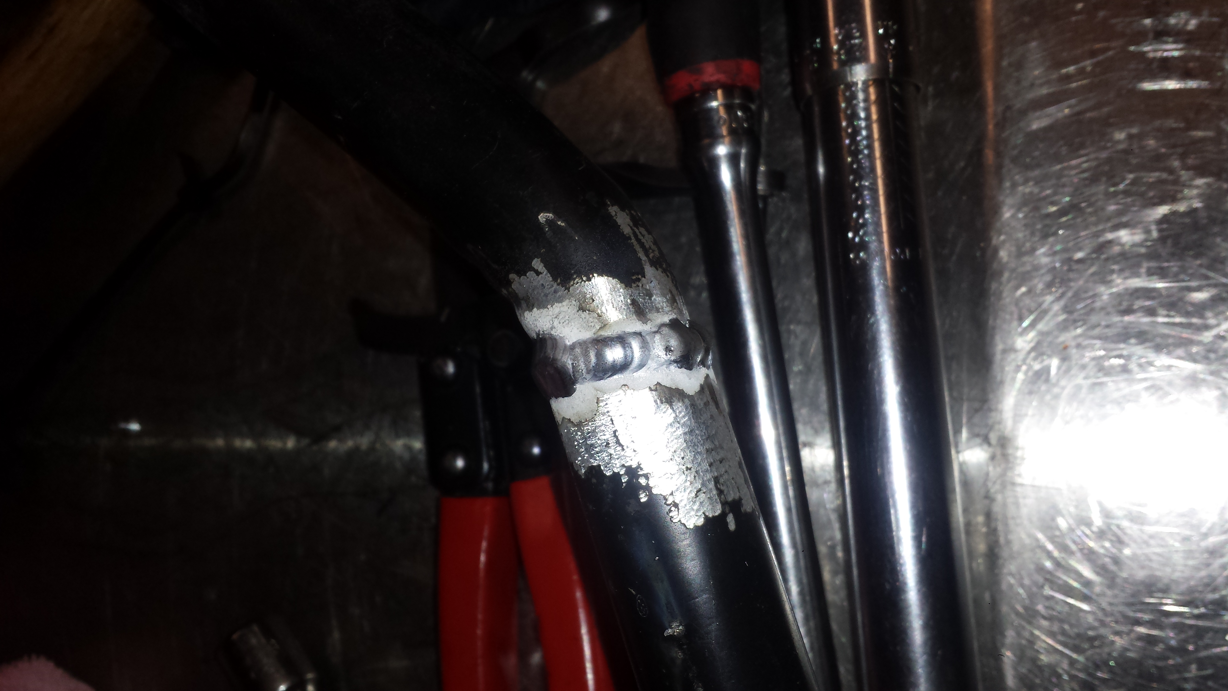

This is a stock engine for now Paulie. I really want to replicate what the average build would be. I did weld the coolant lines add 997 coil packs and new plugs, why not throw in my 8mm ball mod on trans while I was in there. The car has a porsche factory ssk in it so that will stay. Here are some more pic's. Any questions ask away, I am trying to keep it pretty basic on mods but I cant help throwing some fab work at it!!

Passenger side center radiator line repair, you can see the weld.
Drivers side coolant pipe repair.

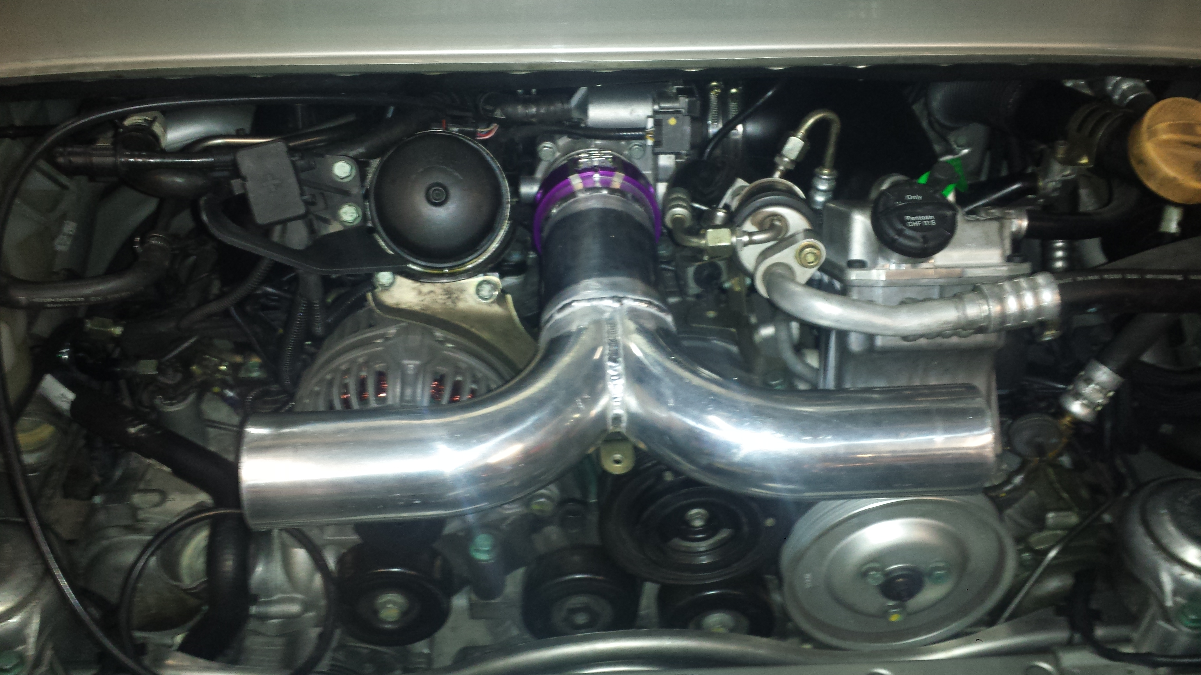

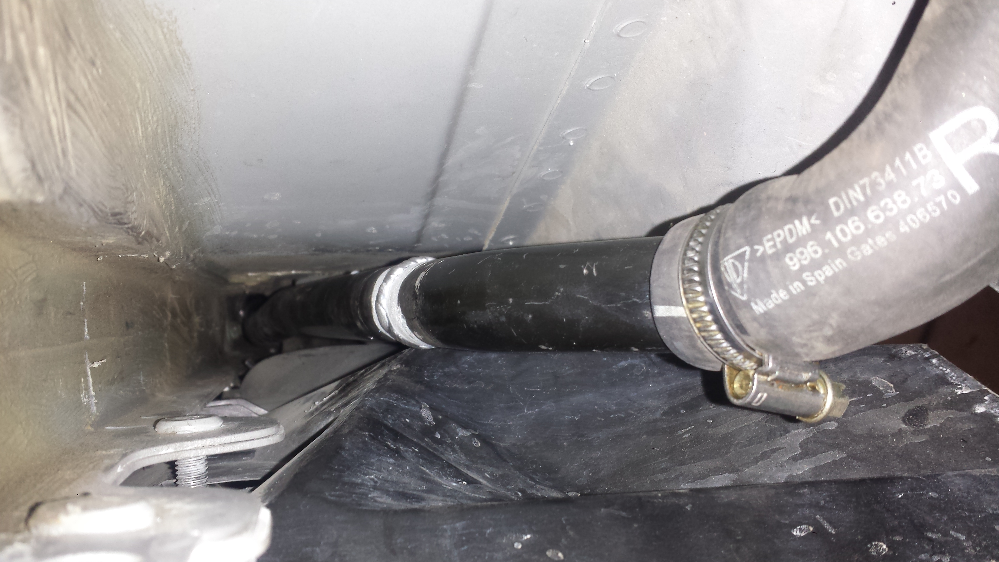

Here are some more coolant line repair pic's and wye pipe pics.

How do those wiggins clamps work? Do you have to weld a lip to the throttle body and the Y-pipe?
