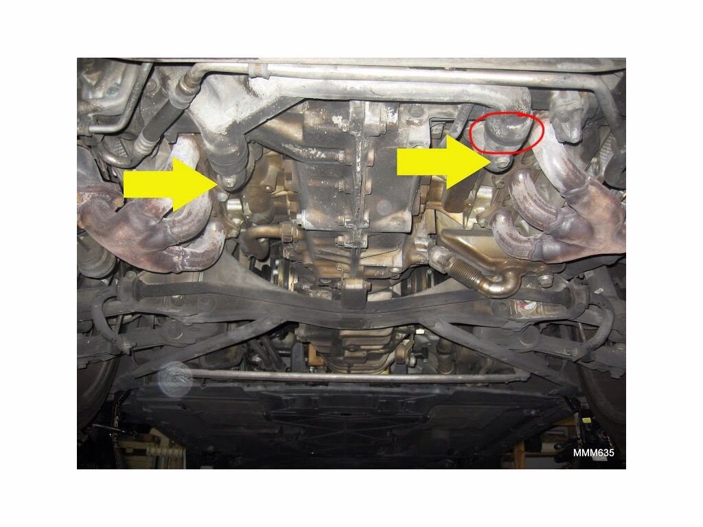

So i should have left good enough alone....BUT I felt like removing the muffler bracket when I was putting my straight pipes back in again. I had the motor supported but when I loosened the upper pass. side bolt the lower seal (rubber) started leaking!! Why in the world would that pipe start leaking by pulling the bracket off!?? Everything is back together and it's still leaking....although very slowly. What should I do? Does the seal need to be replaced now?
Here's the seal thats leaking...

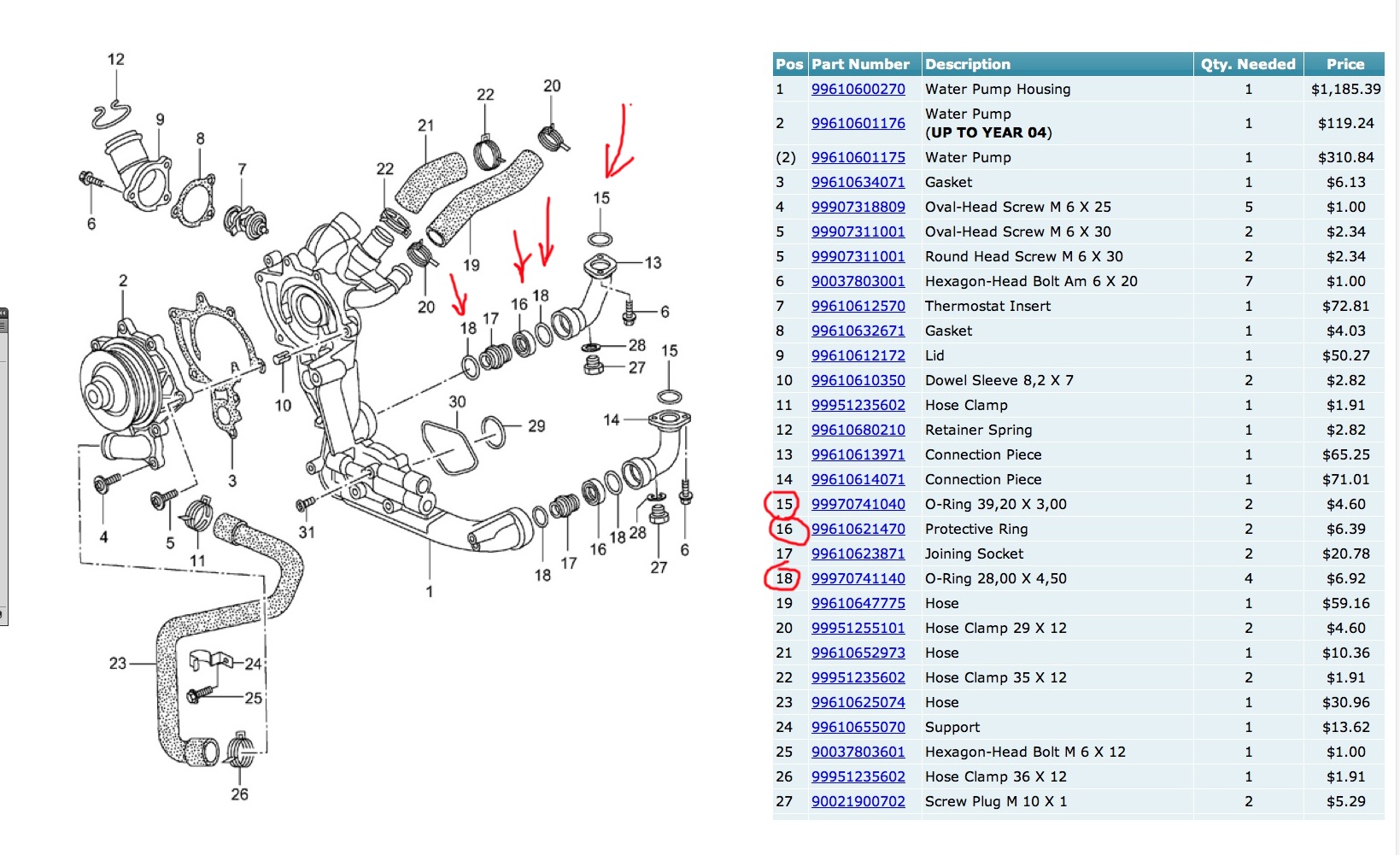

The seals (o-rings and dust seal) in there are very easy to replace. But lots of coolant will come out. Jack the back and remove the drain plug on the elbow. Order the seals on the picture and also a new crush washer for the drain plug….See picture…Only two bolts to remove per elbow….

I had the same issue after I lowered my engine to replace the diverter valves.
The local dealer had the O-rings and it was an easy fix.

Just drain the coolant to be safe. Replace the seal o rings. Fill up with new coolant, start the car. Let the bubbles escape add more coolant. Done. There are few diy about coolant drain.
