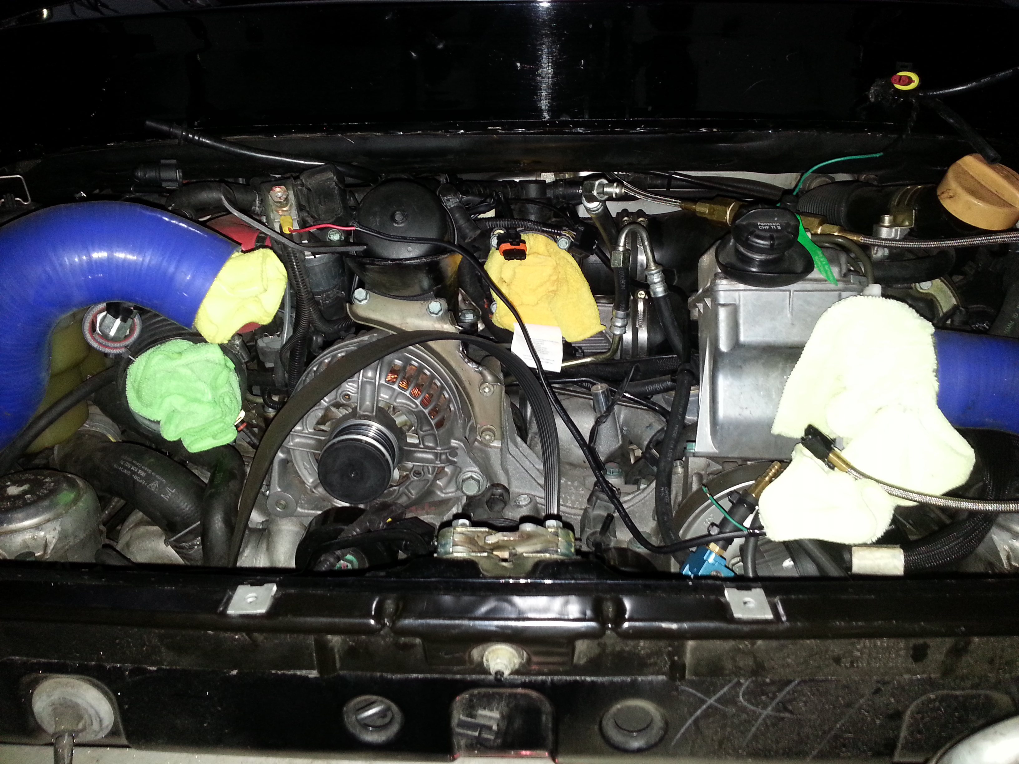

thx you guys !
so did not have time to work on it today (was my birthday yesterday and my gf took me out for some big romance stuff no phone allowed )
but here's a list what i have done now
cross member ,brace ,sway etc..
axle
AC out but still plugged
coolant pipe
coolant out
evoms fuel line
evoms intake pipe out
TB
trans shifter disconnect
wires and ground
Tomorrow i hope the engine is out if things goes well so she can be ready for surgery in maybe next 2-3 week ! will open the transmission and look at it if shes ok for a long run , i will update with a spark plug and oil filter snapshot tomorrow!
btw i would never bought a P996tt (one of my dream) if there where no net,forums,good guys who like to share,diy stuff ,data ,just saying...
thx million time for good people here, the forum and the good support

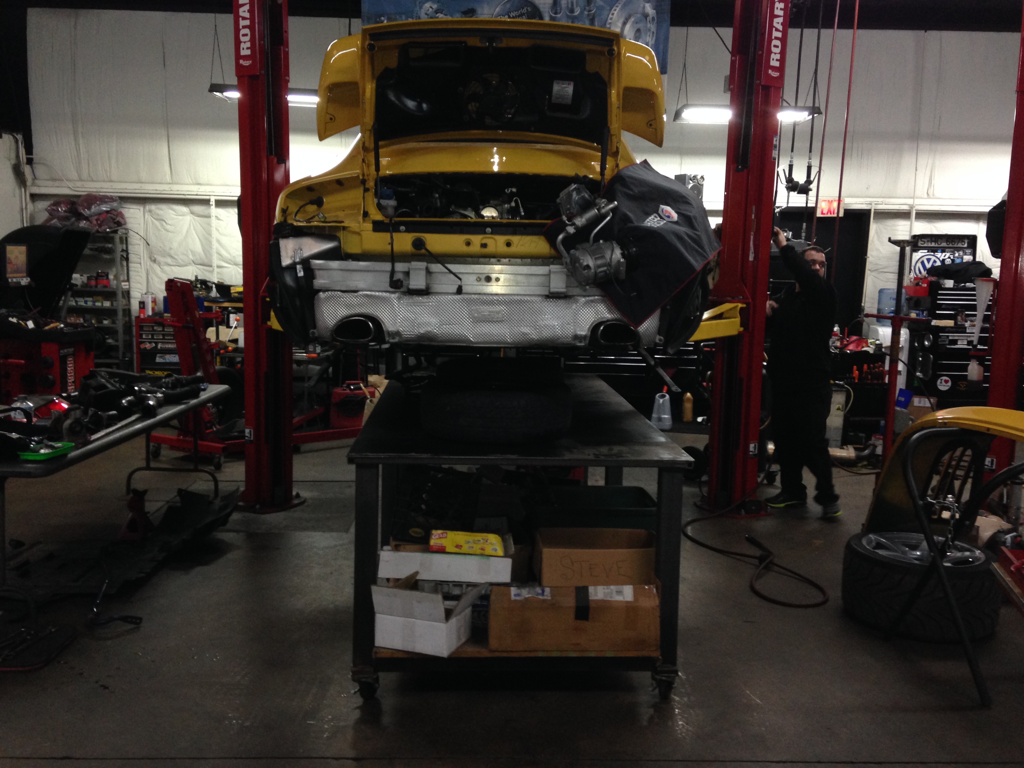

the next time you pull your motor simply unbolt the a/c compressor from the motor and the same for the power steering pump. leave the hoses attached and lay a towel over the rear bumper area. lay both units over the rear and out of the way. this way you don't have to bleed or recharge anything.

great info Steve !my ps still not disconnected so will look at it tomorrow
thx man
