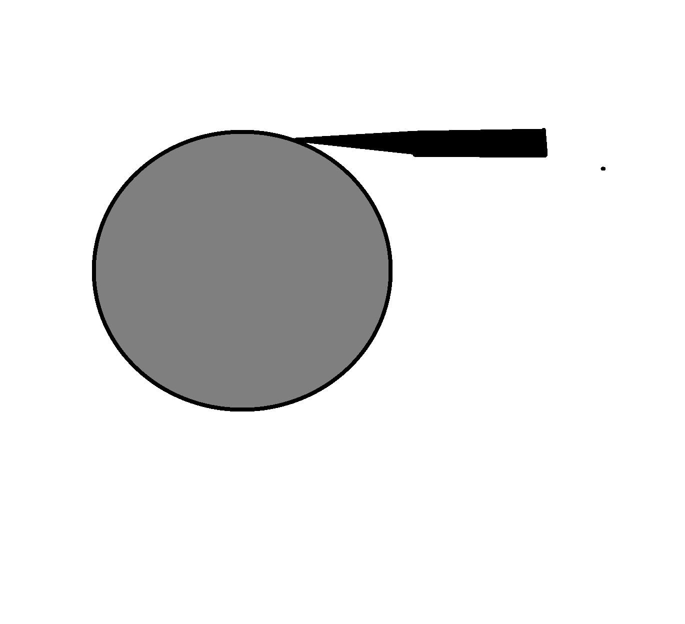

one trick you can try if you haven't already is, with a small and sharp chisel hit the head of plug(on the outside edge) in the counter-clockwise direction, using a hammer as force, if it's going to move at all it will with this technique...but its probably frozen ready to be drilled lol
attached a pic of method (made using my wicked 'paint' skills )
