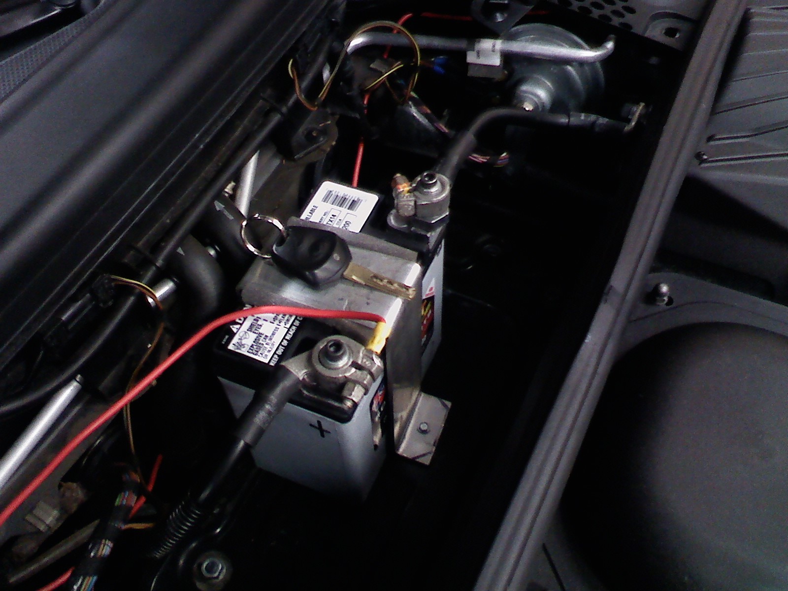

When I had my turbo, and I was on an extreme weight loss kick, I used a Deka as well, but a much smaller one...ETX14, basically a motorcycle battery..11 or 12 lbs...worked great, except at night...HID lighting would actually dim as well as interior stuff...probably best to carry a few extra pounds for the reliability...Kept it on a battery tender ANY time it was parked at home. Oh, and if you leave your doors or hood open for more than a few minutes...dead battery.....

Found a pic...made my own bracket too...put my car key on top for reference...My stock battery was 48 lbs as I recall...so saved 37lbs...
