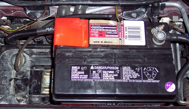

Get a group 47 battery. The stock tray has 3 width positions. The 47 will use the smallest position and fit perfectly with breather tube and all.
These are readily and cheaply available everywhere. They weigh in right over 30 lbs, with enough reserve and cranking power without compromise for a daily driver. Heck, I got mine at Costco for I think less than $50. (Note that Costco recently switched to Interstate branded batt’s so take that with a grain of salt)
Best value ‘mod’ to date.
Note that I’ve played with my fair share of odyssey batt’s in various small sizes for years. Just not worth the cost and marginal reserves for a daily driver, especially when it gets cold.

Pic I found on web which is the same exact setup I have:
