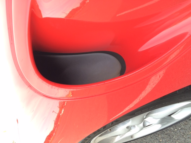

1. This might be a weird question but what is the color inside the intake duct? At first, I thought it was black but it looks grayish to me. See attached picture.

1. Mine is black 2. Have a well qualified mechanic look at it. 3. Very common. Worked on mine out of the car, fix lasted a couple of months. No good solution...yet...but I'm working on it.

My ducts are black. The other two issues have tons of threads and both are very common problems. The sender malfunction will peg your oil pressure meter, then drop to zero for no reason, then jump back up. It's a $60 part and lots of guys have replaced it themselves - I paid a couple hundred to have mine done by my indy. You'll have some choices for the wing fix - try a search.

My ducts are gray ish. So are the side skirts. Car is black. My car came from florida for example. Age. car sits in the sun throgh the day soaking in heat. Im going to replace mine after winter, ducts. Side skirts and front lower windshield plastic. You can use some cleaner for plastic, blackmagic helps a little

This car was in CA all its life so maybe it is also fading from the sun. I wasn't sure if the ducts was replaced and was not "painted" black like how it is supposed to be. After looking into it, the part comes in only black instead of primer or gray so this makes me feel better.

You can spray much of that black trim with wurths trim paint and it will look good as new.
