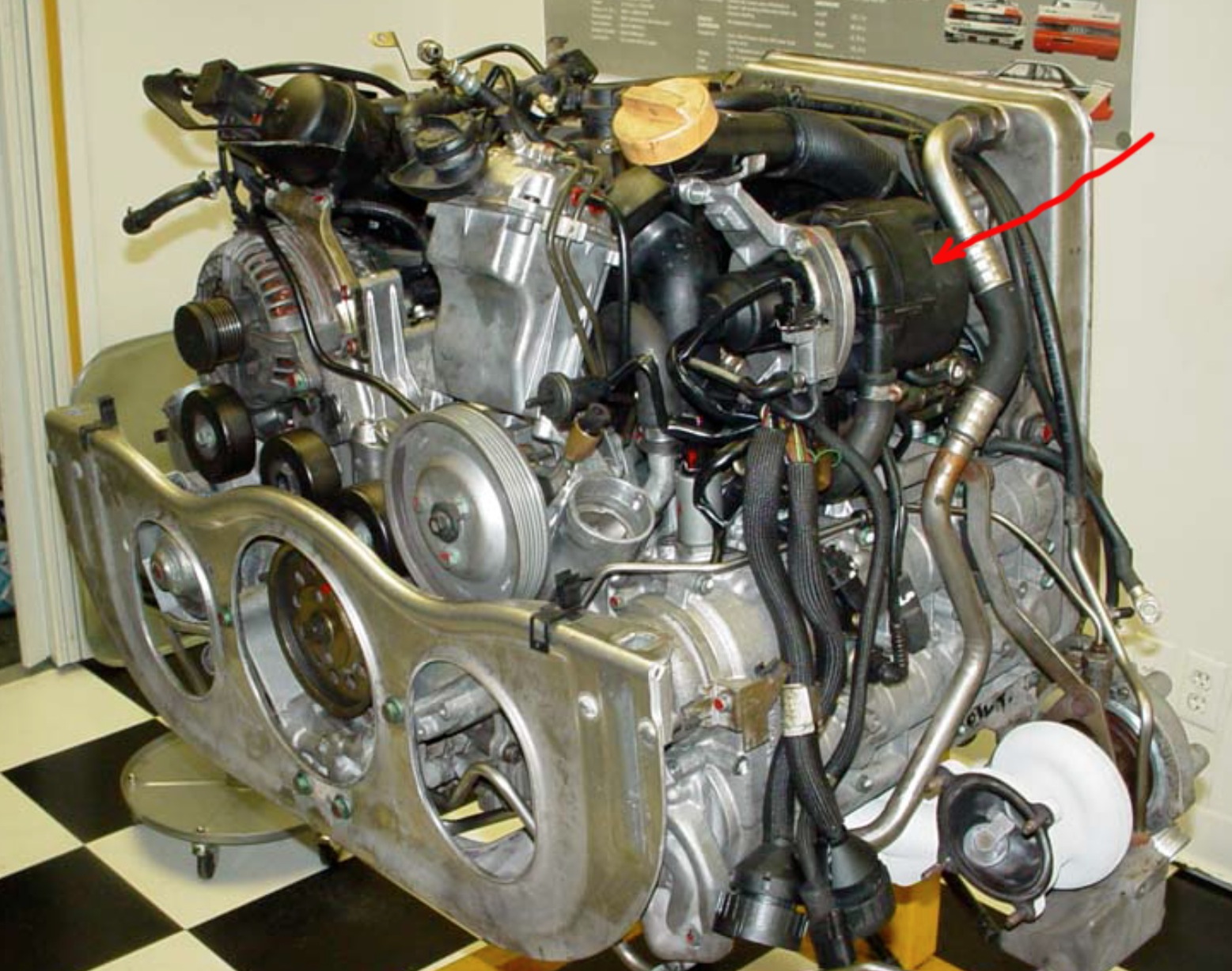

May be it is related to the air pump which is located on the right forward top of the engine. Can you hear this pump starting at every cold start for about five minutes?

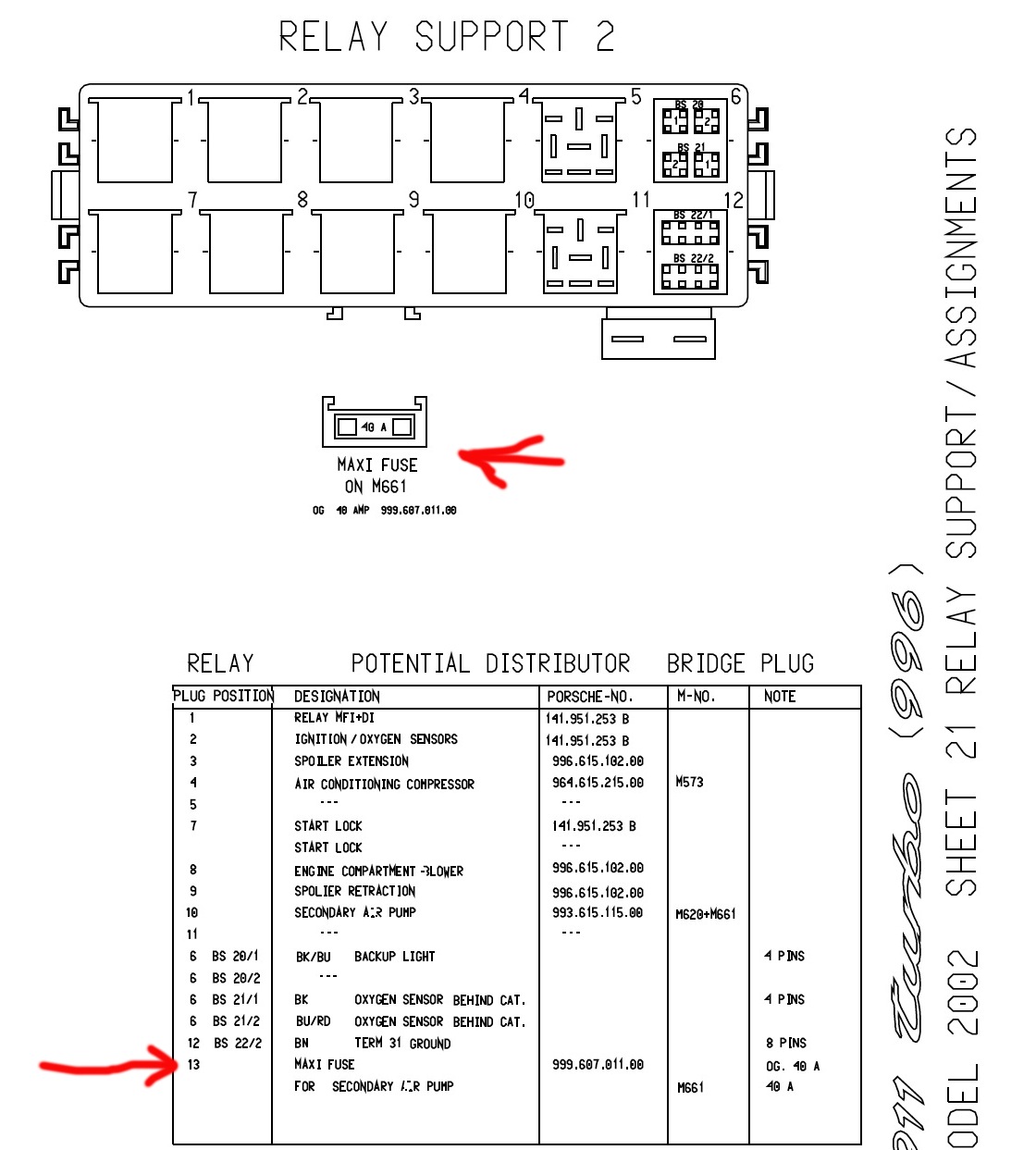

If you cannot hear the pump working may be the clicking noise come from a failed pump….Just for your information, the pump looks like this (first picture) on the engine and within the system in the parts cat (second picture). There are some used for sale on Ebay. It can be replaced with the engine in place….This pump got a maxi fuse with is located on the relay carrier #2 which is behind the rear passenger seat not far from the ECU….

Wow, you've been a great help!
When I start the car tomorrow I'll put a stethoscope on the pump and listen.
Thanks!
