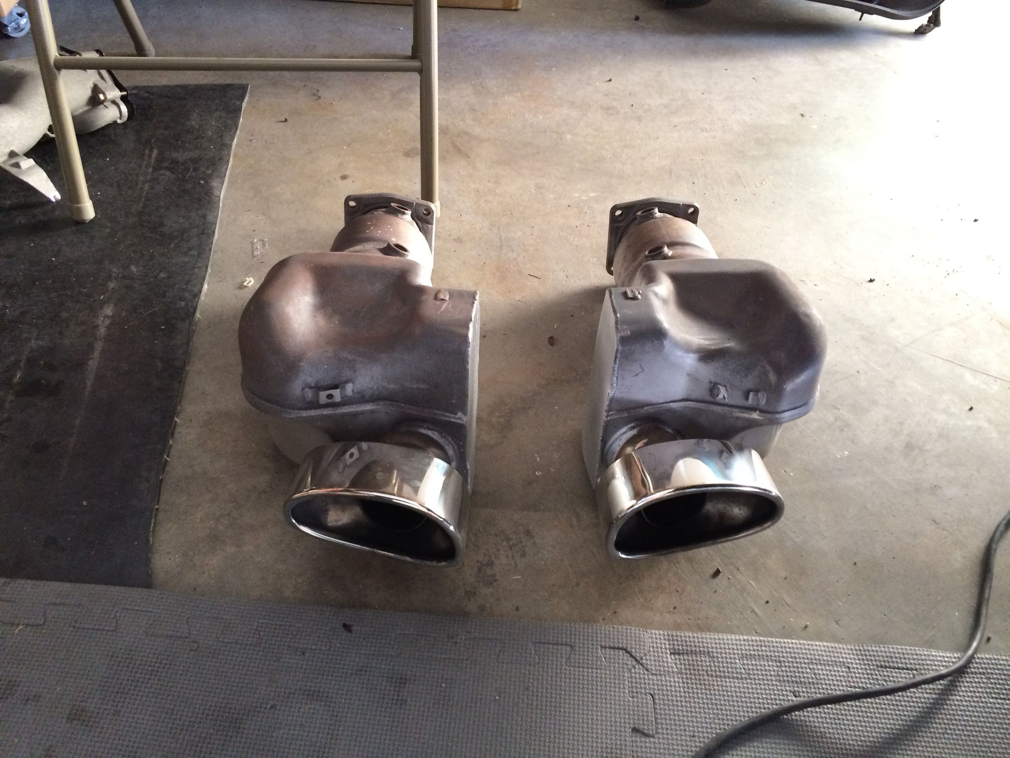

I got a spare stock muffler. Takes about 40 minutes to swap out if you have suspicious smog shop. Then swap the other one backafterwards. Luckily, my smog tech doesn't sweat the visual. My happy pipe has 100 cell cats and really sniff's clean. As clean or cleaner then the stock pipe.
