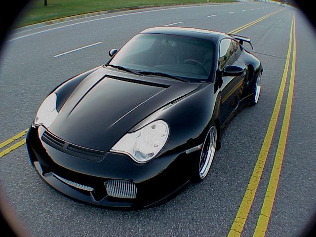

photo looks familiar to a car I saw on ebay a while back...do you have any more pics, the widebody looks crazy
