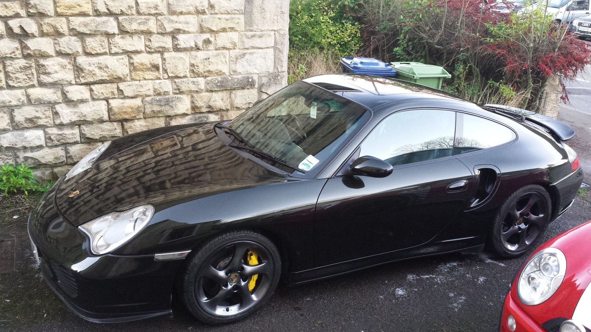

Okay, between this board and the 'other one' I think I'm going to procrastinate. My ideal wheels cost twice as much as the BBS CH-Rs but they are pretty much an exact match for the existing 18"ers - it's just galling to think of spending that much on them but I guess you can't take it with you as they say. Anyway, thanks for all the information - this is the car as it stands
