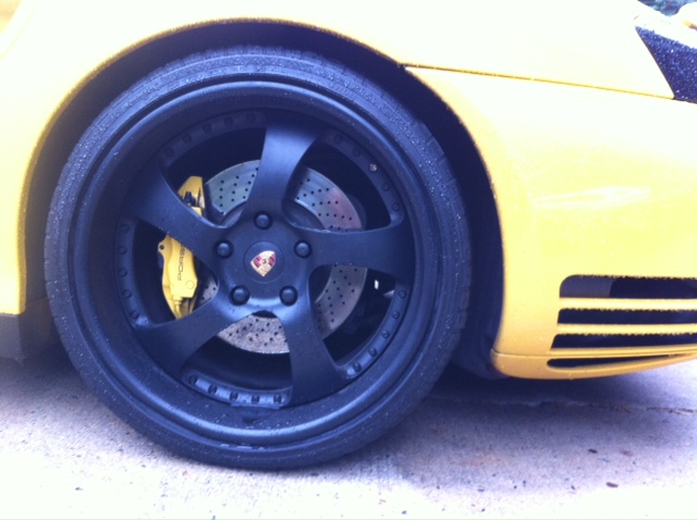

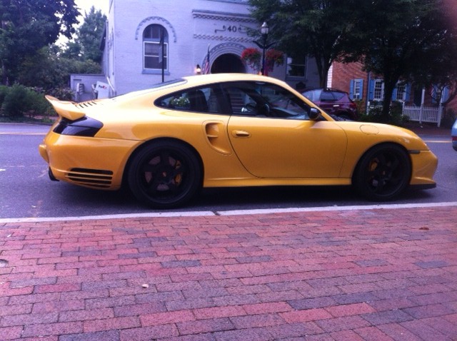

TireRack still has 315/25/19s Michelin PS2. I'm about to order right now actually. What I can't find are the Conti sport contact 2s, which came with the car and a little pricier.
Without spacers, mine is on:
315/25/19 and 235/35/19
