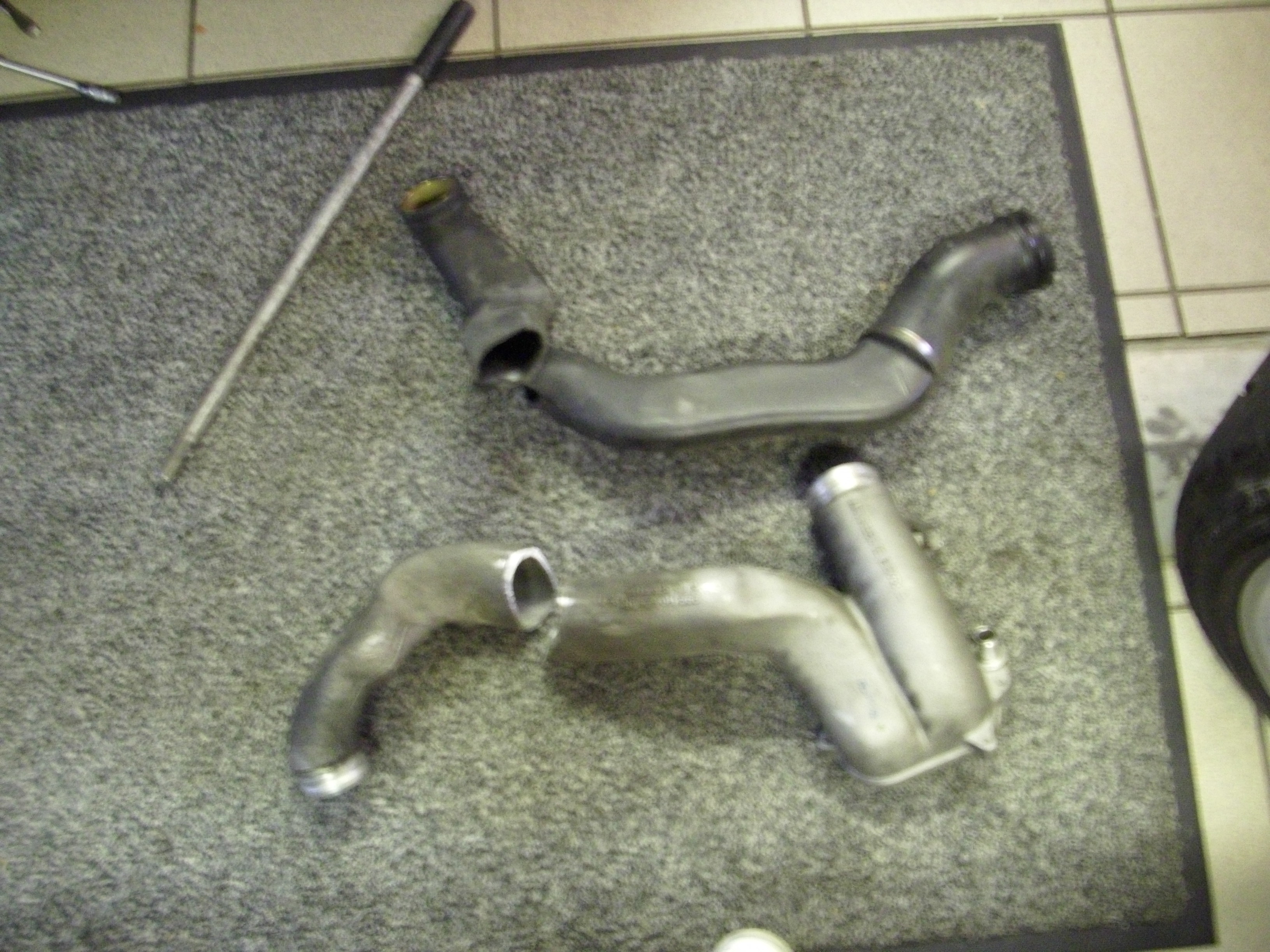

at the end it Looks like the attachments......but it is possible with a saw electrical
with lowered engine cut it in pieces
