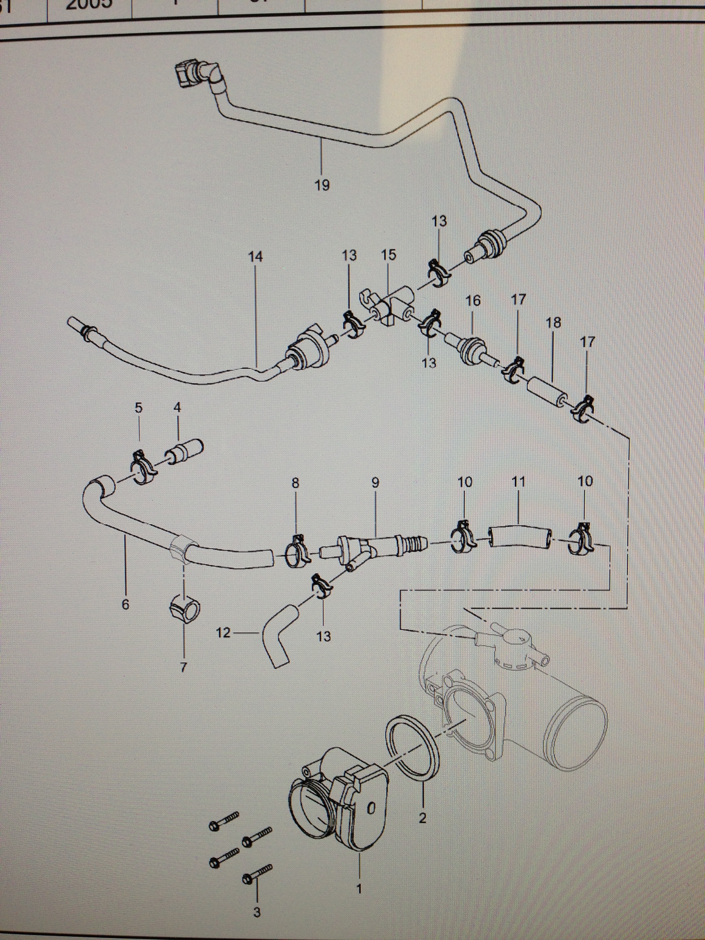

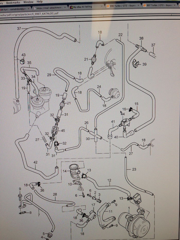

Question to those whom have gone mafless:
I am in the process of a mafless build and have haphazardly embarked on removing the Y pipe, intake, F Pipe + DV's, Air Pump, ect. I have found the supply of information on which lines you need to keep, which lines you need to block off and which lines you can toss, sparse to say the least.
I was hoping that someone could help direct me as to "How to go Mafless: A lesson in vacuum lines" that could walk me though which are mission critical and which are for the birds.
Car will be running a FabWorx Y pipe with BOV and filters off the turbos thus replacing any need for DV's or the stock setup...
Any help is appreciated.

Depends what your plan is for the secondary air pump?? If your not using that you can remove all the lines and just have one vacuum/boost line to the BOV and one to the fuel pressure reg.
If your still using the secondary air, than that complicates things. You don't want boost, so a one way valve (the black and white ones) is needed. You only want vacuum, so set the valve up that way.
All 3 lines will come of the plenum.

Thanks for the quick response, and excellent follow on question - To be honest I am not sure what the benefit would be of keeping the secondary air pump while going mafless? My gut tells me to scrap the entire SAP and keep things in the bay clean and less muddied.
Is there a direct pro/con of removing the SAP?

Much cleaner without. If your engine is out and your intake is off, you can make simple blockoff plates and remove it all. If it's not, just remove the SAP and cap the line (you don't have to cap it as it wont operate without vacuum)
Make sure you tell your tuner to give you ROW tune.
If the engine is out you can also remove the vacuum canister of the manifold. Only have to run 2 lines then one to BOV other to fuel pressure and no one way valves. Much simpler

No problem. Other than the n75 valve and lines to the wastegate, it's possible to get rid of basically everything in your second picture.
If you have any questions let me know.
