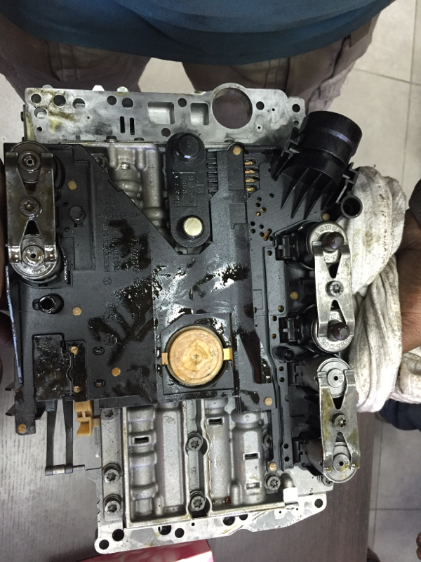

Went to the garage today and waiting on him to change the valve body switches

Changed the valve body , still doing the same thing 😏

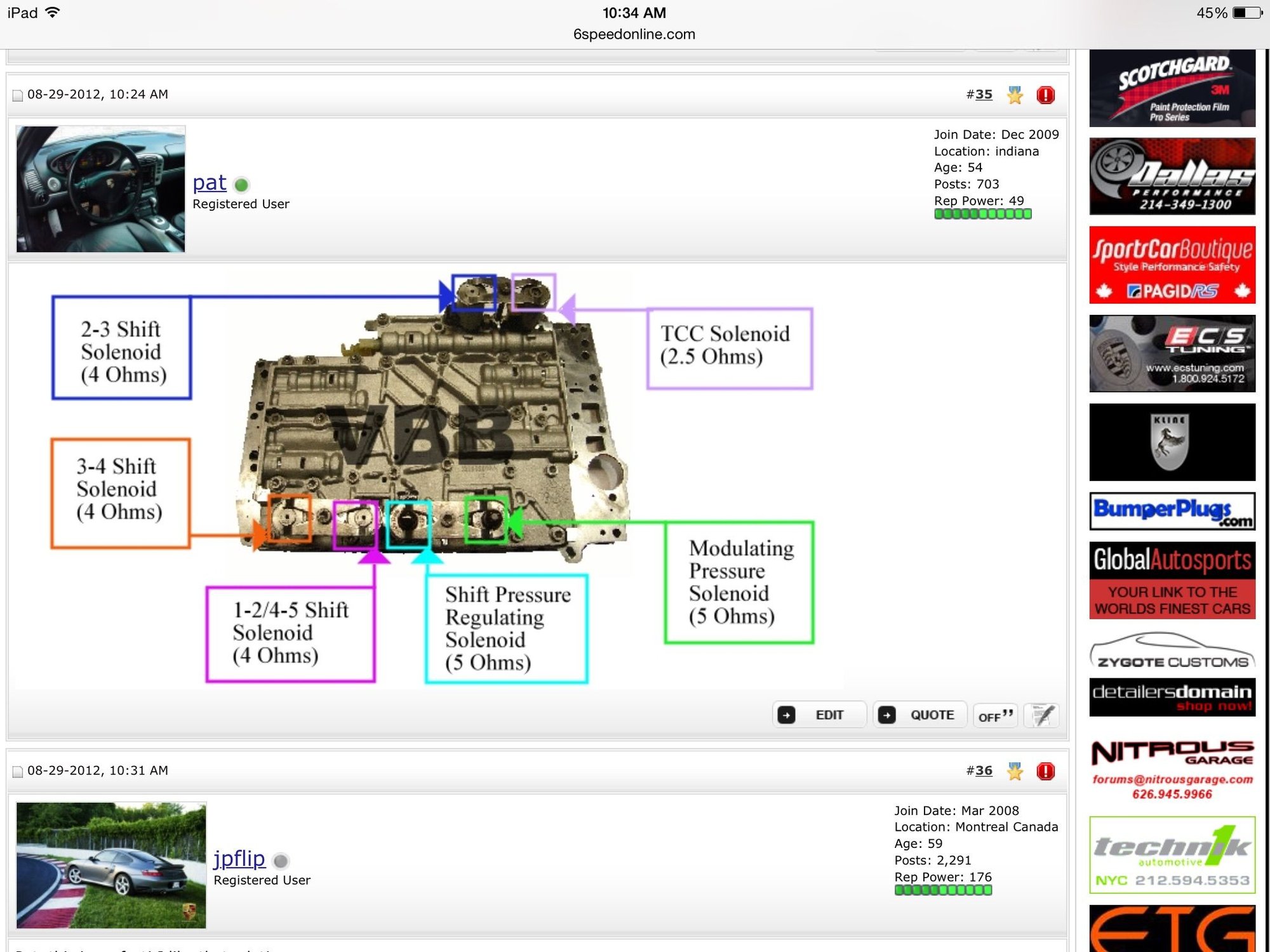

Some info

Hey pat , I saw that , I changed the body volve , still not shifting on 5000 rpm from 3 rd to 5 th as good

Could be a shaft pressure seal. The seals along the shaft keep the fluid going to the right clutch pack. If the pump is not pumping as it should and if one of those seals are not sealing right or is basically worn the right amount of pressure will not go to the clutch pack. That looks to be what happened to mine. The smallest seal twards the tip of the shaft went partially bad. It doesn't take much deviation from how it is supposed to be and things no work right.
