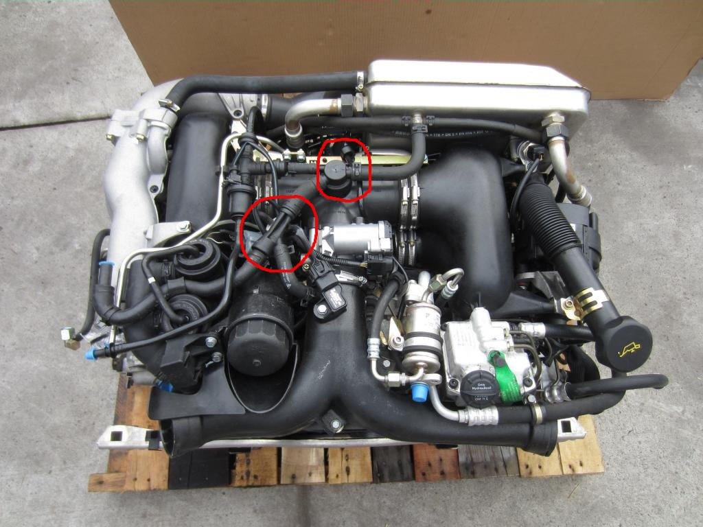

In this pic I circled the Venturi pipe and the three way connection on top of the intake T plenum. Do either of these have a one-way check valve that could go bad? I already replaced the one-way check valve on the driver's side of the T plenum.

the 2 areas you circled are also somewhat common area where it can leak...markski will know more about those 2 areas....

I've said it once, i'll say it again ..and even though i might well be wrong. i believe you have a cracked check valve that is hissing. thats what they do.
its on top of the plenum at your pics. there are two iirc? i would replace both ( and did ) it cured my issue which shared your symptoms.

As preventative maintenance during this round of work I already replaced the one-way check valve (996-110-135-70) that sits to the left of the three-way connection on the T plenum. Is there another check valve that I missed? FWIW, both the original check valve and the new one only allowed air to pass in one direction.
