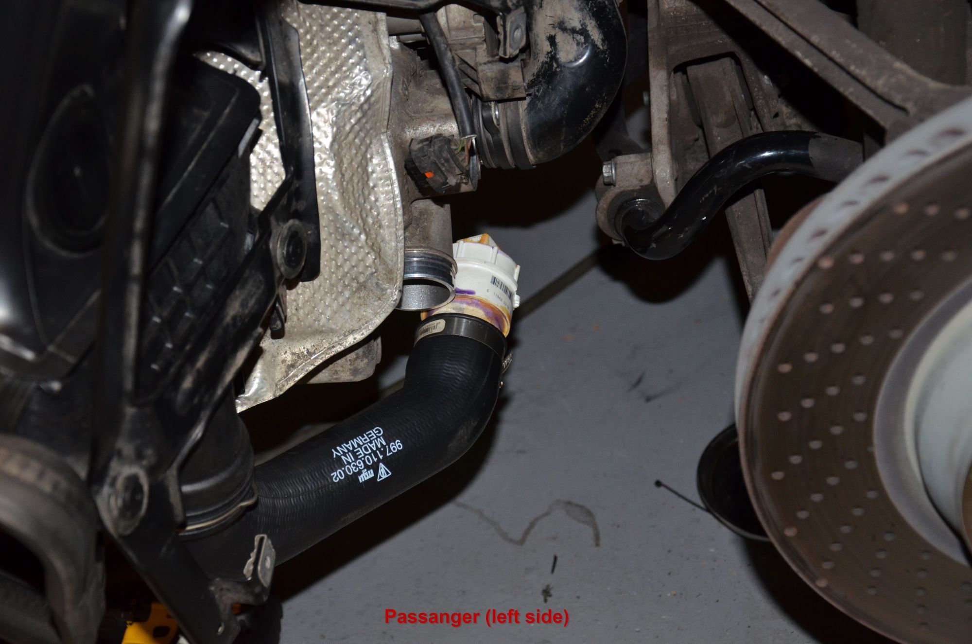

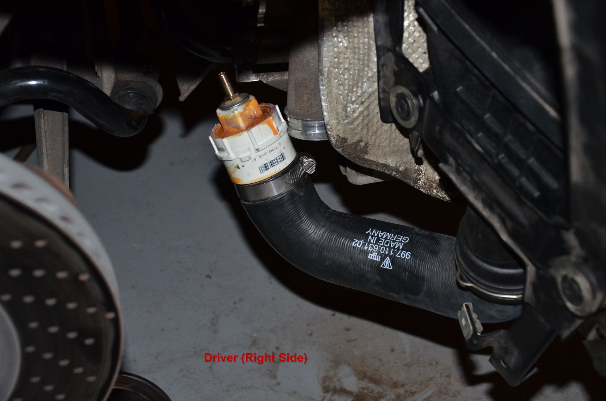

the other thread had everything spelled out in the first post
https://www.6speedonline.com/forums/...ml#post2429269
You will need to drill the top of one of the stoppers to place the nipple fitting.
Another good idea if you have the time is to put a pressure gauge on the other stopper but you should be able to hear any leaks. I used to use a spray bottle with dishwashing liquid and spray where I heard leaks and look for bubbles.

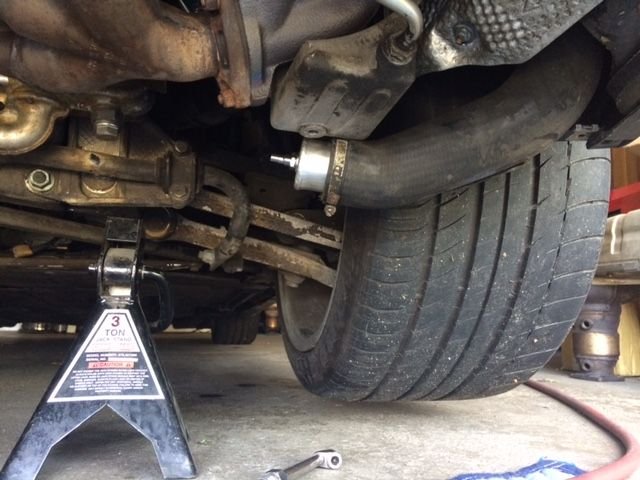

You only want to test those areas that see boost normally, from the turbo's inlet is easiest. You just need a couple of couplers that fit the inlet, a pair of pvc plugs to fit the other side of the coupler, a schraeder valve, and a gauge. Plumb one cap with the nipple and gauge. Plug both sides, clamp them TIGHT, and pressurize with the nipple to about 20psi then watch to see how quickly the gauge falls.
Be careful, if one of those caps lets loose it's a little missle!

Nope! The airflow goes like this - in through the air box, through the MAF, splits into two tubes, and enters each turbo. The point where it enters the two turbo is what you want to disconnect and cap. The caps will be attaching directly to the turbo inlets. Alternately, you could disconnect the turbo discharge pipes and pressurize from those.
What you're pressurizing is the intercoolers, the Y-pipe, the intake, all the funky vac hoses and check valves attached. Making sense yet?

here you go this is the best way... take ti to 20 psi and see if it holds for 30 sec..

Do it the way showed u and all ur issues will go away. It's that simple. End of next week I should have them. If ur not too far from Chicago stop by we can log the the car and see what's really happening. U have been going back and forth about this for a while now. Man up and get it gone
