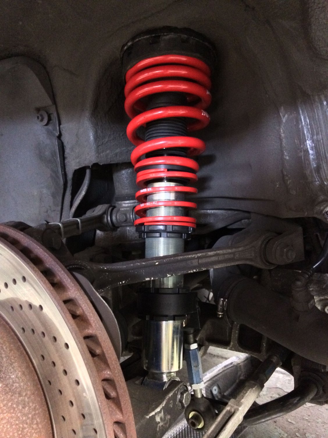

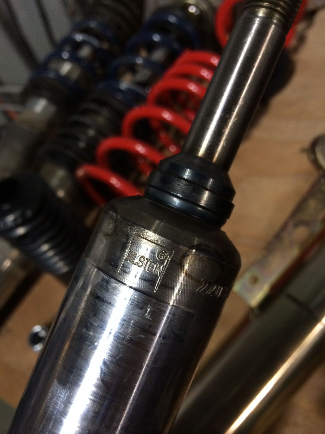

I have H&R RSS ClubSport on mine, it is pretty great on track, a bit stiff for street driving however. (I do around 5-6 track events a year)
I used to run JRZ RS on my 996 turbo, they are amazing of course, but switch to H&R since I picked up another track toy (miata).
While the H&R RSS couldn't provide the control and quality I found in the JRZ, the H&R does give you very nice control and sharp handling. Very well track setup for a very reasonable price. I like them better than PSS10 on track, but PSS10 win for street driving.
The spring rate is well match for sporty tires (I had Kumho XS and NT01). But if you are planning to run Race Compound, they might be a bit soft.
My friend's E55 has the H&R street coilover, that ride amazingly well on street, but could be too soft for track.
If you are looking to track your car more than 4-5 even a year, get the RSS version.
Otherwise, street version will provide much better and comfortable ride in my experience. (But I would get PSS10 for street and light track duty coilover)
BTW, H&R coilovers ride LOWWWWWW on our car. Even thought at the highest setting, my ride height is as low as GT2. So if you are not looking to lower your car by much, these might give you trouble.
In conclusion, RSS version is a very well setup for track, yes. I like them a lot.
Pros:
Cheap (relatively)
Install and Forget (no damper adjustment)
Good Control, Sharp Handling and Nice damper
Good Spring Rate
Good Quality (H&R coilovers are built by Bilstein)
Inverted Mono-Tube Design
Cons:
Progressive Spring Rate
A bit too rough for street driving
Non Rebuildable
Can't upgrade spring if you ever desire to go stiffer
You will need to buy adapter for after market camber plates
provided end links are weak, need buy something better (for track, that is).
I have had PSS9, PSS10, KW, Apexi, Tein, and even cheap taiwanese coilovers experience on a lot of different cars before, and the H&R coilover is very well priced for what its offer. But since they are not on the same car, I couldn't say how well they compare to each other due to different design.
Hope this help

You are welcome, some picture just for your reference

The shocks are easily rebuildable. You can send them to Bilstein and they will rebuild them for $75 per corner. Front rates are linear, rears are progressive.
